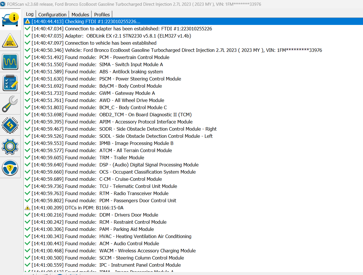

I went to switch my 2023 Wildtrak with a FP Tune to Sport mode and most of my modes were gone. I only have Normal, Eco, and slippery. Sport, Baja, Mus/Ruts, and Rock Crawl (enabled over a year ago with FORscan) are gone.

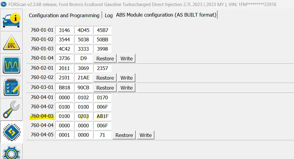

I hooked up FORscan and no related errors (have one for a short in my fog light harness that I haven’t chased down yet, probably a connector). I am able to switch between 2H, 4H, 4A, and 4L on the GOAT dial without issue. I also reviewed the AsBuilt in FORscan and it’s as expected (image below).
Any ideas before I call my dealer? Could it be a sensor that’s gunked up?

Do you have a MyKey activated?
If you do, and you use that fob, it will lock you out of certain GOAT modes.
That didn’t even enter my mind! I’ll take a look, bet that’s it. I’ll have to do some research to better understand setup and config of MyKey!

Yep, I must have activated MyKey. Reset with my other “Admin Key” and all is right again. Would be a great feature to use IF I let my wife or anyone else drive her (not).
