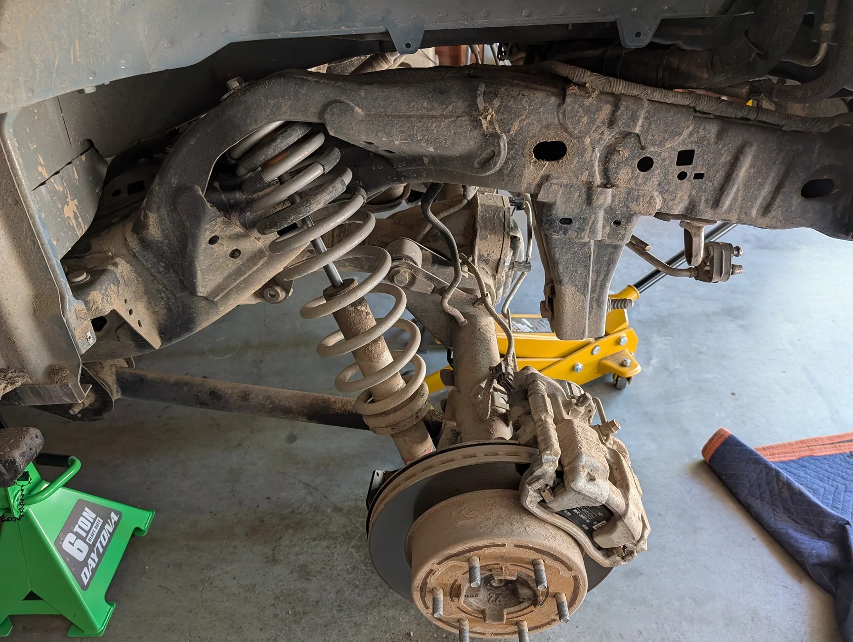

I agree with @PWillette. I personally wouldn't change the suspension since the Foxs basically define the Wildtrak package and a spring only swap will likely change the ride to some degree and probably mess with the OEM shocks tuning. The spacer will change geometry a bit, but I wouldn't think 1" in the rear only would do anything significant. Others with experience may comment. The rear is pretty easy to work on if you want to try it yourself. My '22 2 door was a Bilstein WT and I switched to Eibachs Pro Truck Stage 2 with HD springs all around (STD spring is in the pic). Ended up with more lift than I anticipated even with all the weight I've added and the shocks set at the lowest height.

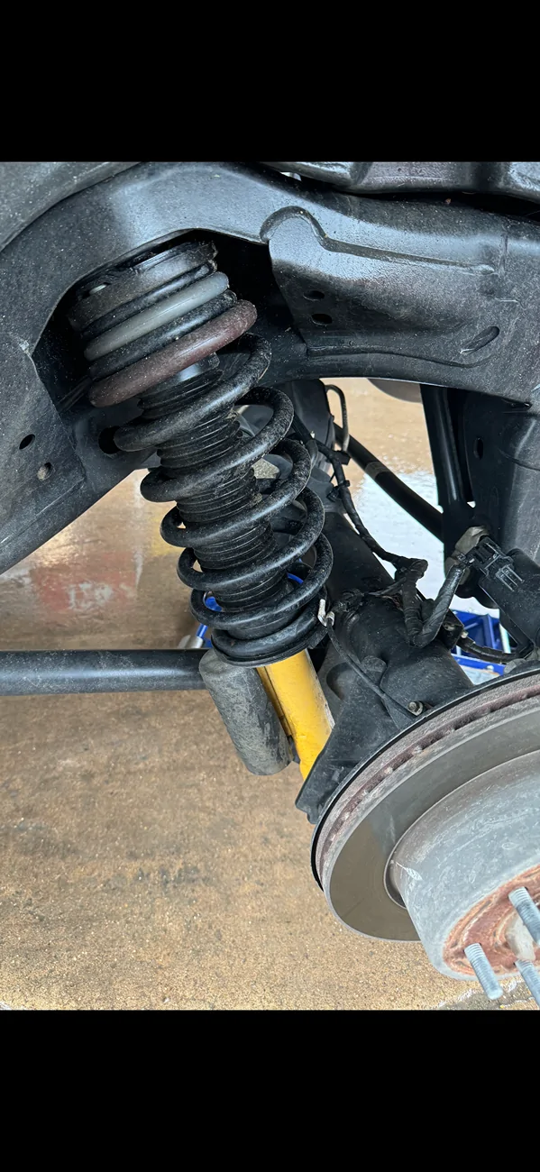

The spacers for the front are able to be used on the rear also. The bolt patterns and space are the same on the tops of the struts. Also when it comes to just “puck” spacers, the ones that fit non sas hitachi struts also fit the sas bilstein. I know from experience swapping my base ones to the sas struts. In the pic of my rear there is a 2 inch puck on top of my strut inside where they connect to the body. You can use just the one inch in the rear if you want and it only would lift the rear because of sag and leave the front alone because it already sits higher from the start. Also the geometry of suspension is less affected because of solid axle in the back vs when lifting in the front
I was just about to say the same thing, spacers are identical front/rear.
You said you were looking for less than an inch of lift. The Zone 1” spacer lift is made of a top hat spacer and a bottom mount spacer. You could run just the top spacer in the rear and it would give you under an inch. There are probably other kits with a similar setup, I just knew this one first hand.
The problem is if you decide you want the full inch (that’s what she said) you won’t be able to use the bottom spacer in the rear and would require a taller top hat spacer.
