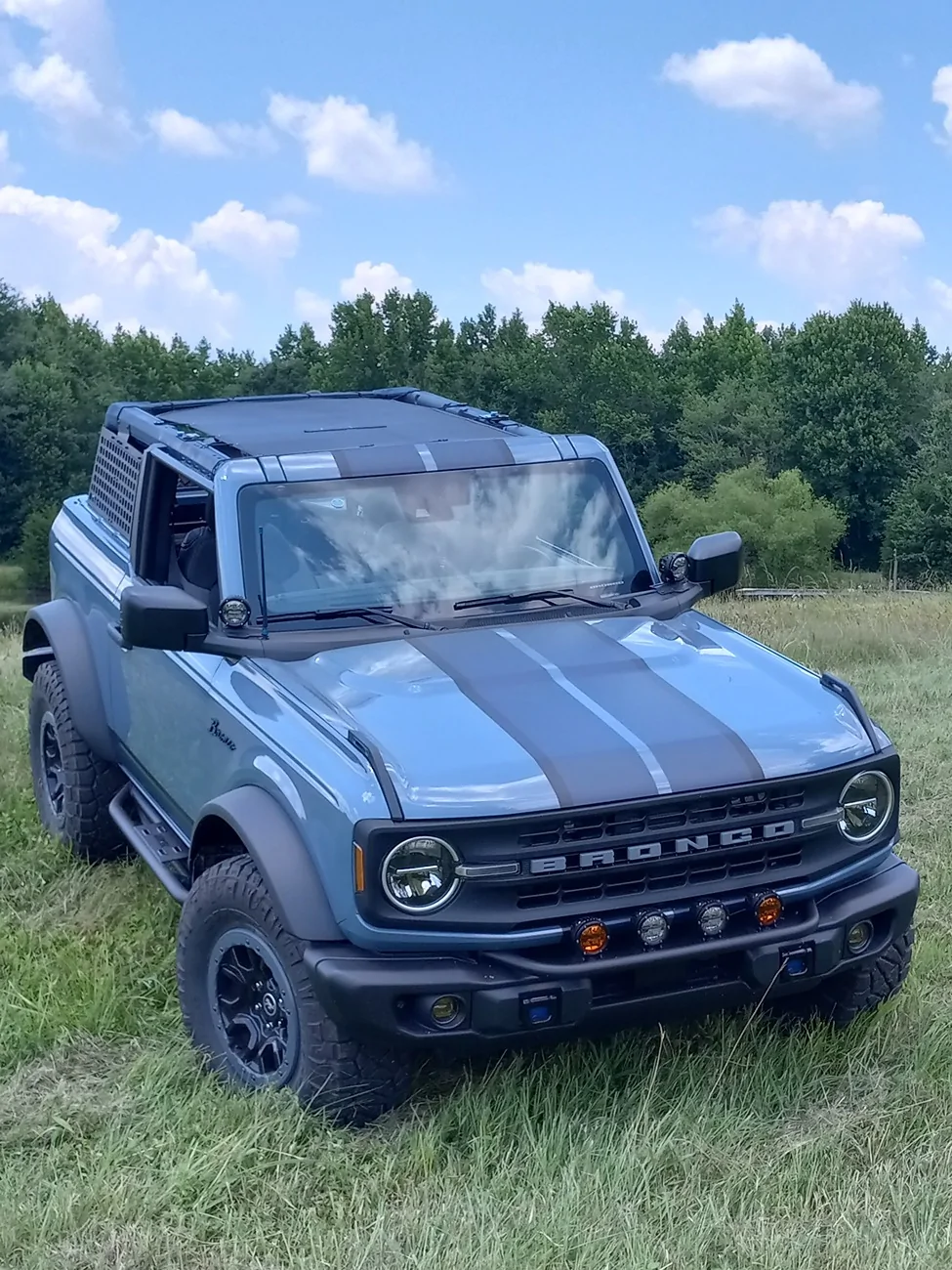

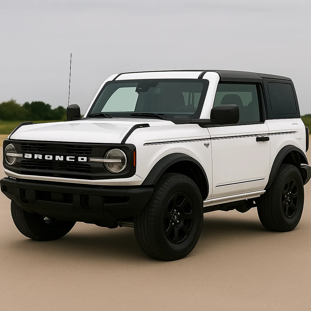

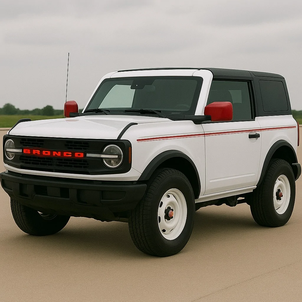

Any thoughts on my color combinations?
Ford Bronco Can I do side stripes myself? AD7C8678-7C75-472A-9AA6-47653CF45B5E
Ford Bronco Can I do side stripes myself? 20B06D1E-28FD-4CE4-8989-4F3F0130E242
I think I dig the red but would need to ask my wife to confirm that’s what I like - LOL!!

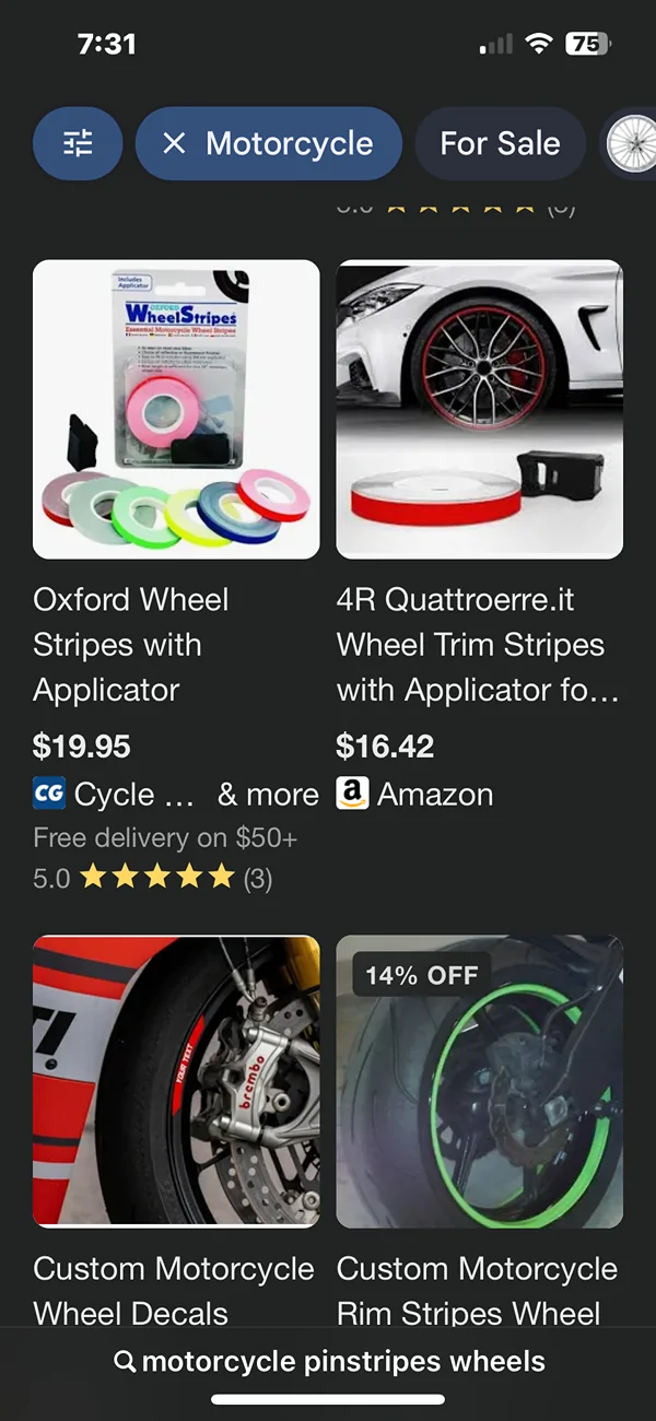

How about a thin red line on the outer edge of the rim as well?

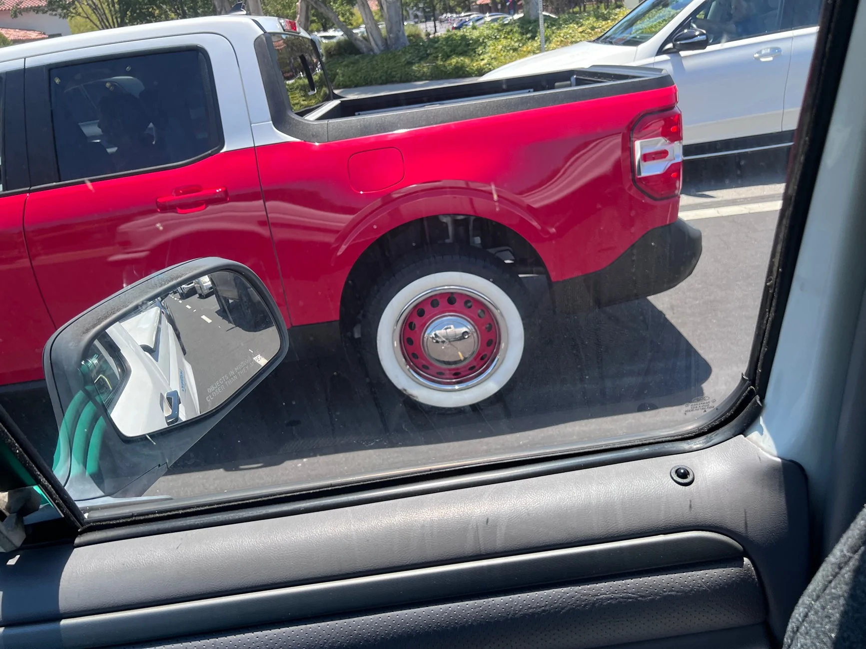

Or hay maybe just go for it... full retro? You do like RED.
These are a couple of bodacious broads, living life [they're well into their 80's] had custom work done to the new rig.
I'm sorry to report this has been done already to a Bronco…
Way to go …

These are hands down the best stripes I have seen on the Bronco. The colors are perfect together. Did you make this or modify a kit? It looks amazing.

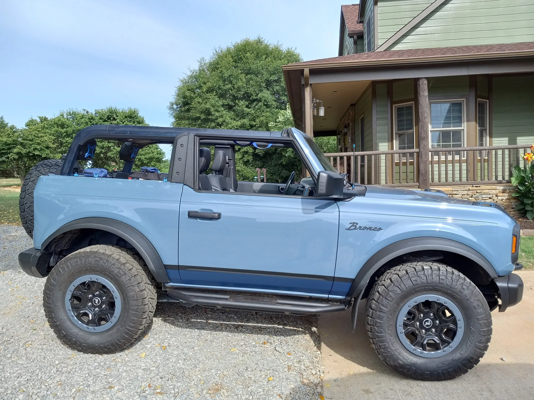

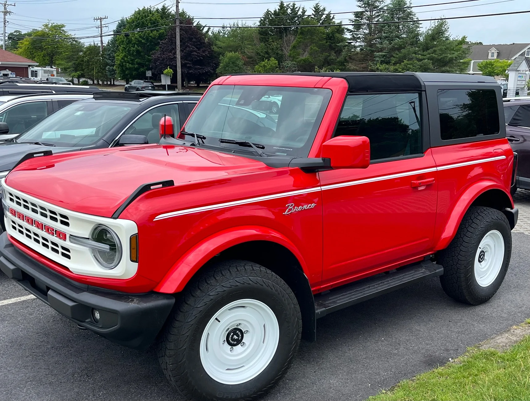

I do like the red stripe and red mirrors. I had a side spear placed on my 2023 Race Red OBX for $200 and a wide white side panel placed on my 2023 Area 51 BD for $900. Both done perfectly by Sarasota Wraps. Great
