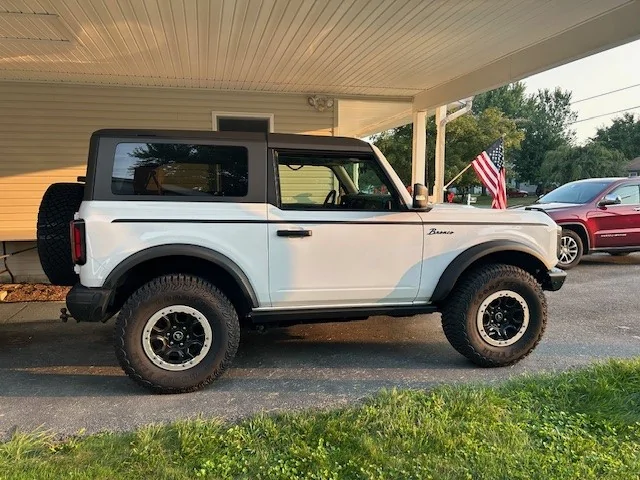

I came here to say exactly this. My experience matches this description almost word for word. My previous vinyl application skills is bumper stickers.
Now, my vehicle already had a stealth wrap, and I feel that applying vinyl on vinyl made it a little easier and forgiving process.
The driver side seen here was actually my first side. I did starboard second.
Ford Bronco Can I do side stripes myself? IMG_6130
Only I can really see the crooked parts and actually it makes me kind of proud that I know I did it myself!
Painter’s Tape saved my life (at least my wallet.). Huge game changer!
