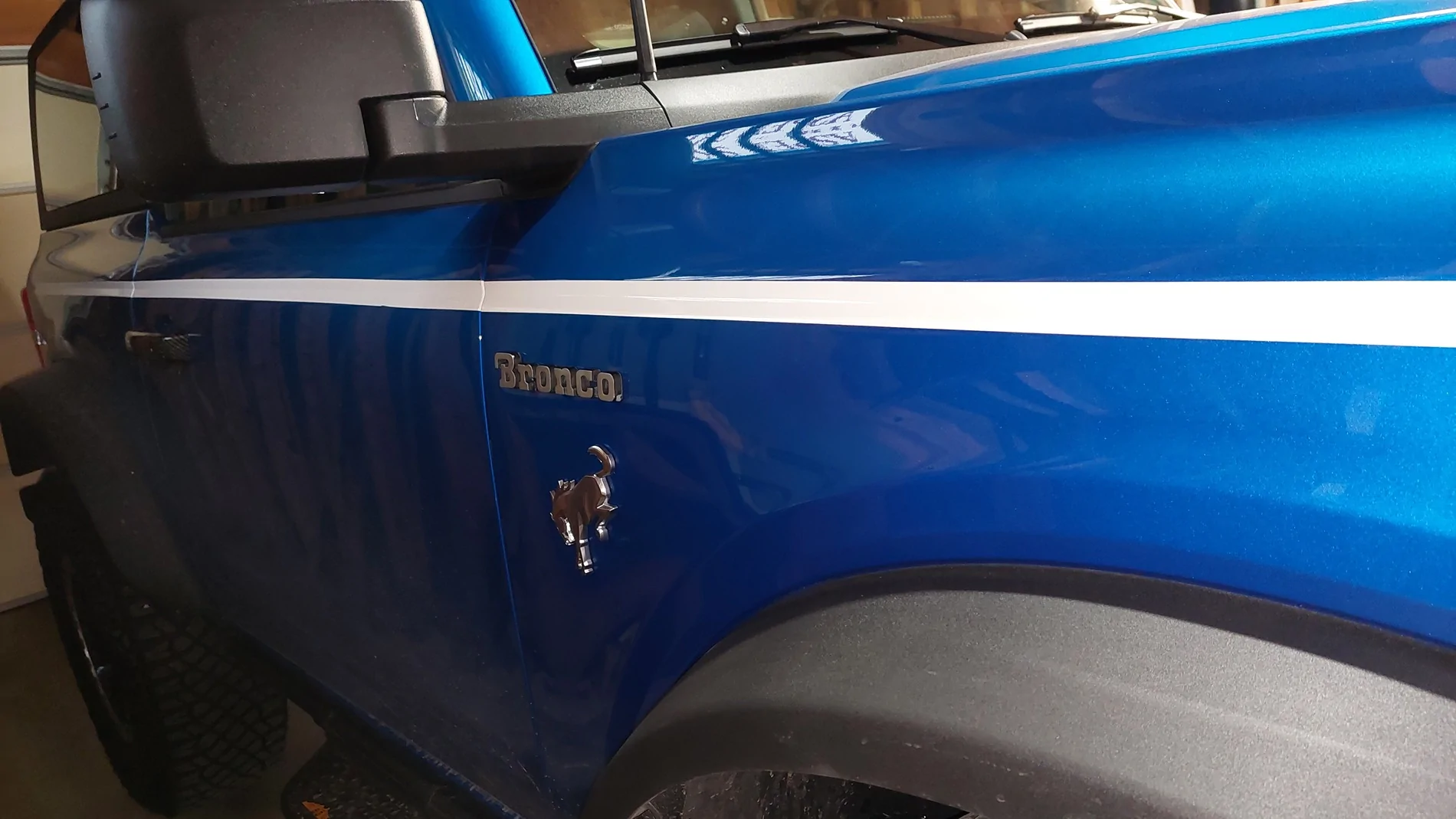

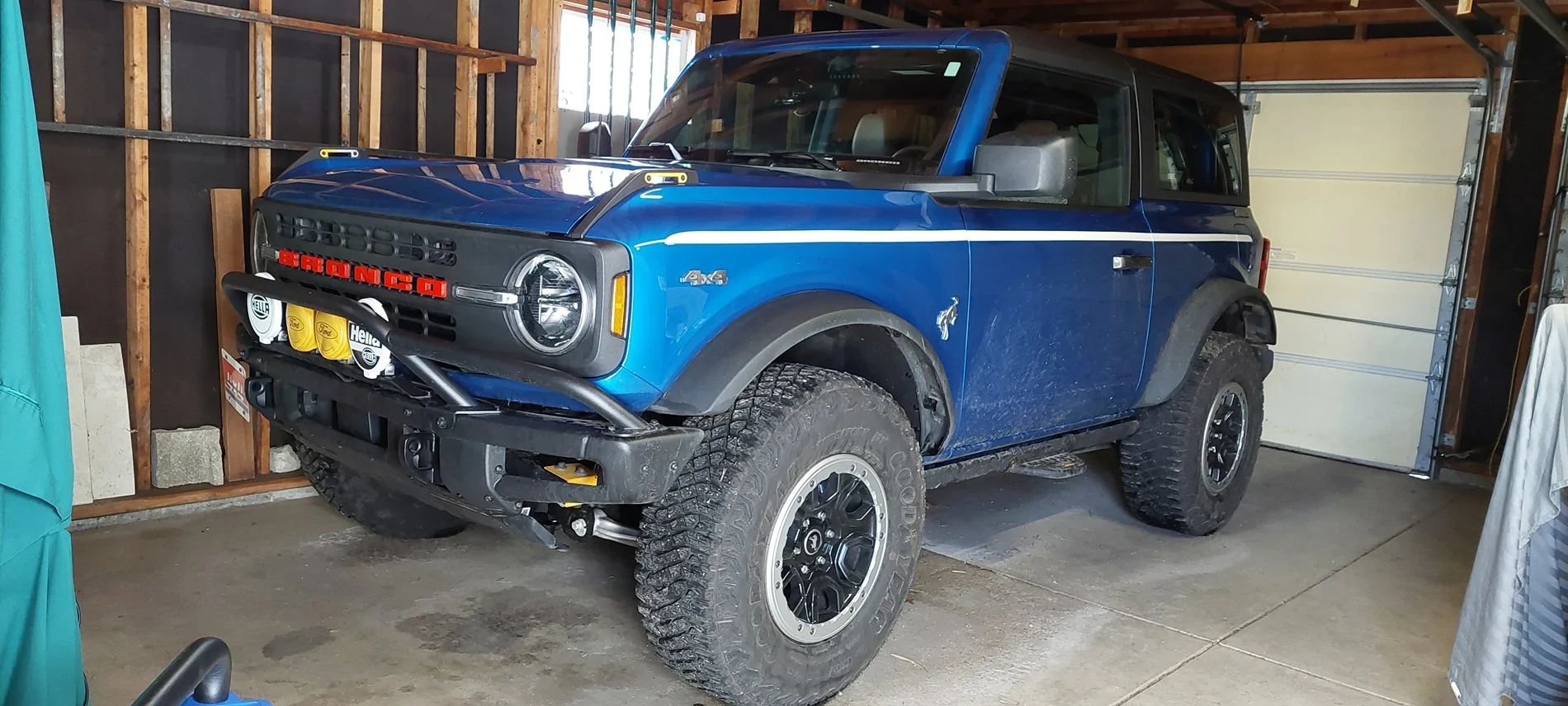

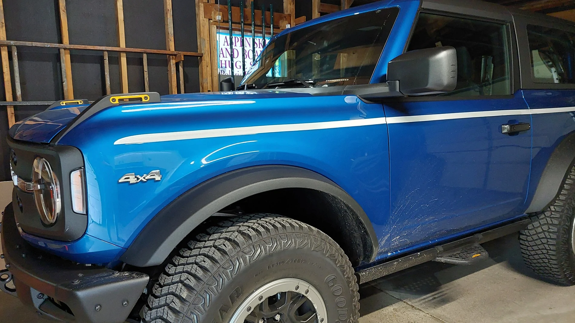

"YOU CAN DO IT". I did my own vinyl hood stripes & rocker panels, which was a lot more than just a stripe. I just bought vinyl and cut it myself using knifeless cutting tape. Lots of youtube videos. First time for me and it wasn't too bad. I had to redo one of the hood stripes due to stretching the vinyl and causing a few ridges. Do not do it if the temp is hot (my mistake was trying to do it when it was 85 degrees)... it makes the vinyl soft and it can stretch easily. You can do it a couple of times if needed. The cost of a couple sets of stripes beats the quote you got by a long shot. Like stated, painters tape to keep things straight and after the first one the second one will go on easily.
