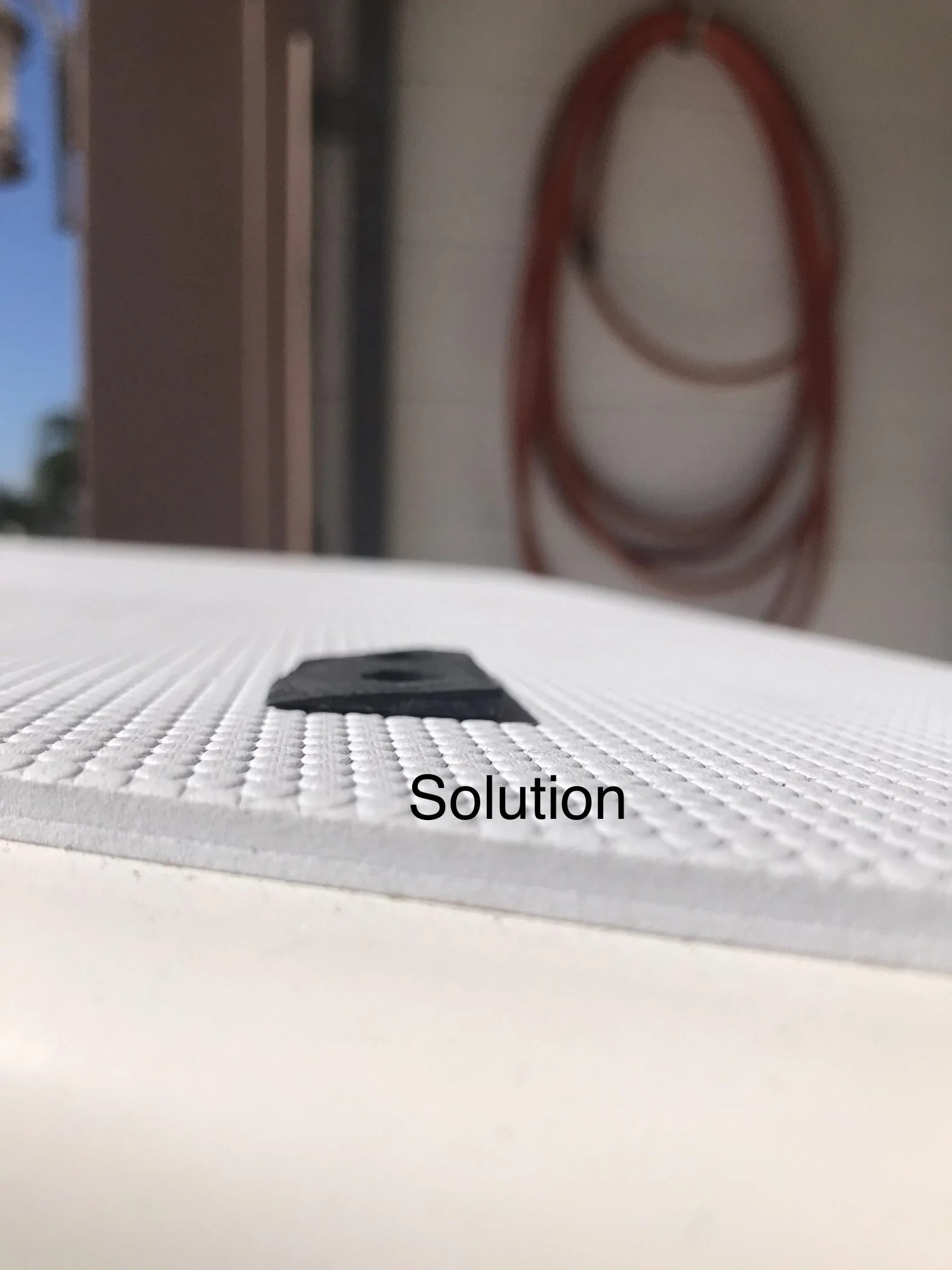

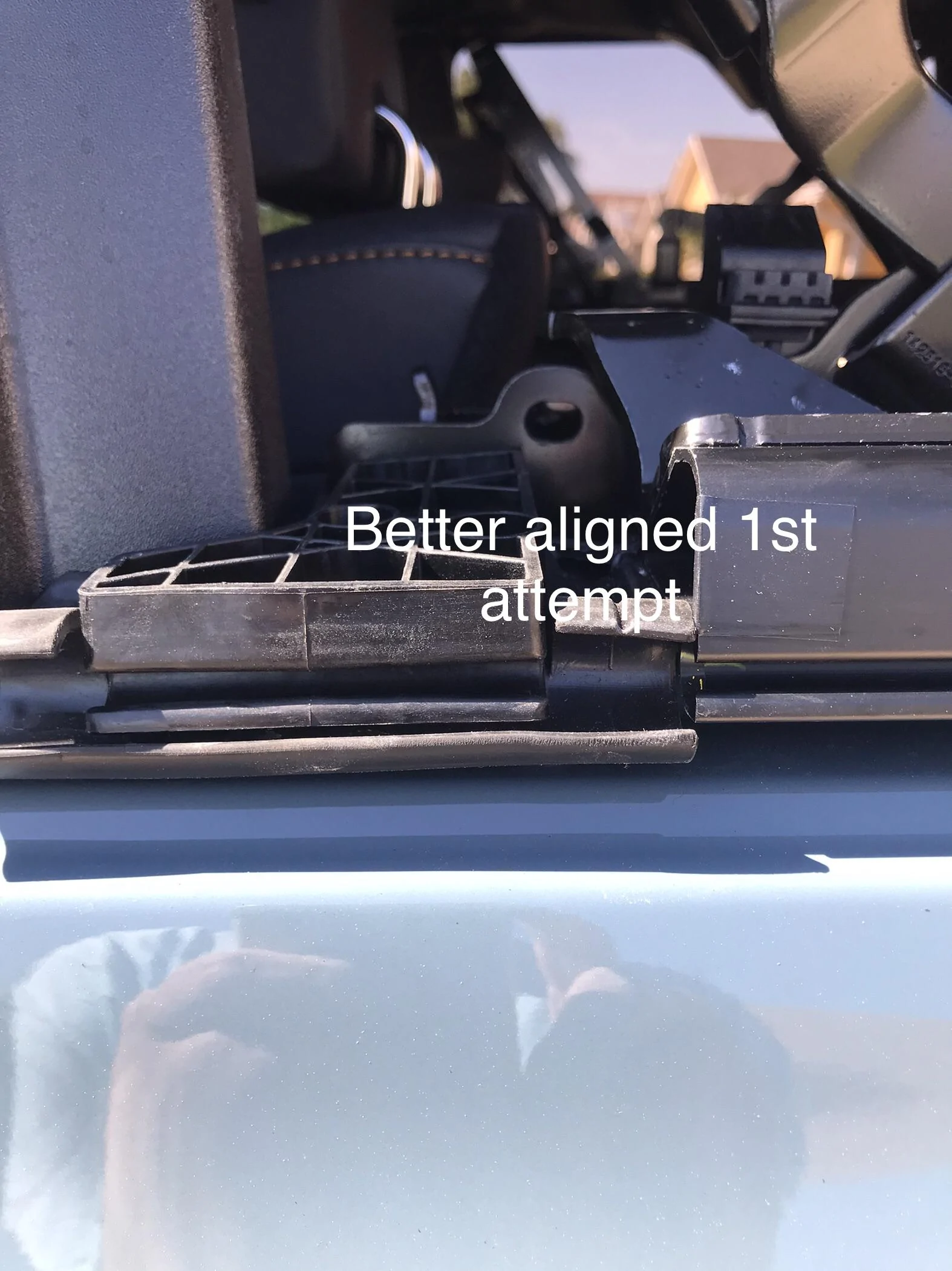

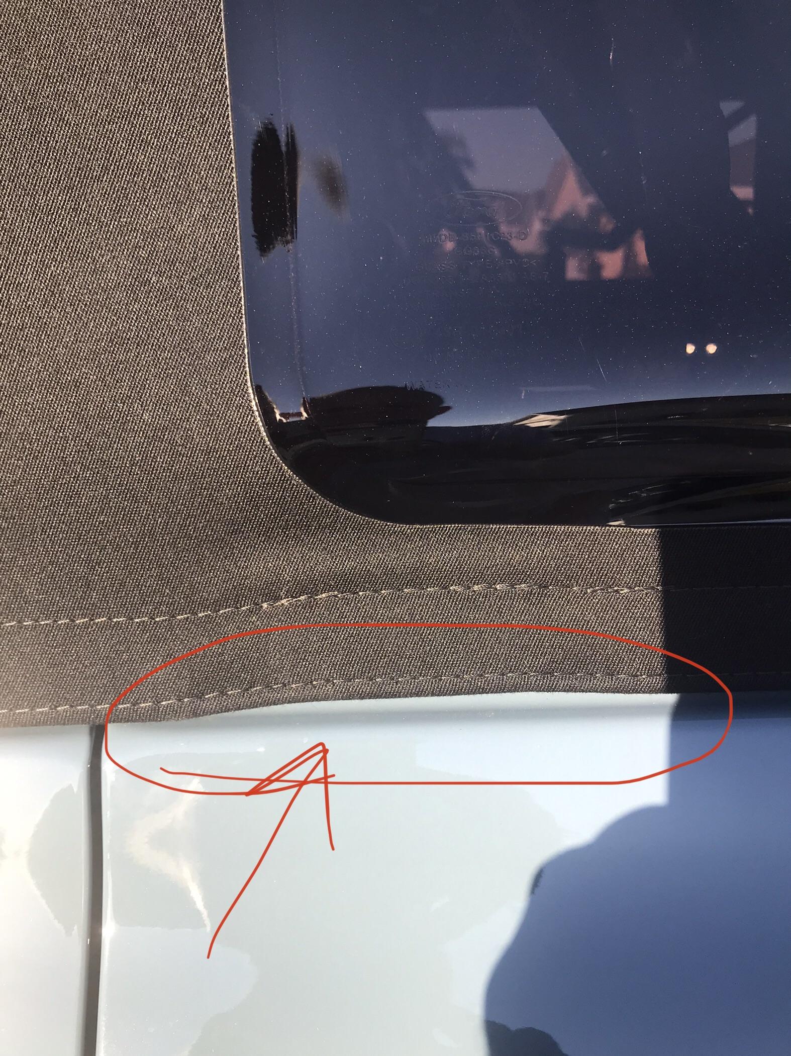

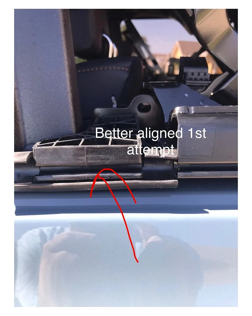

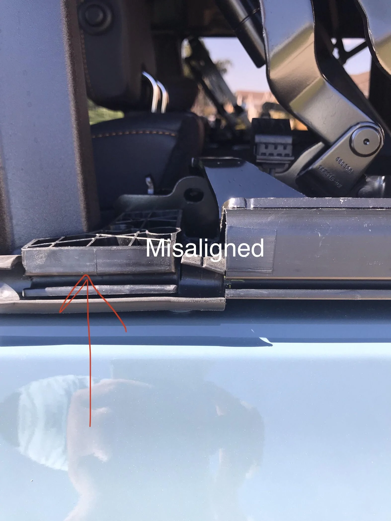

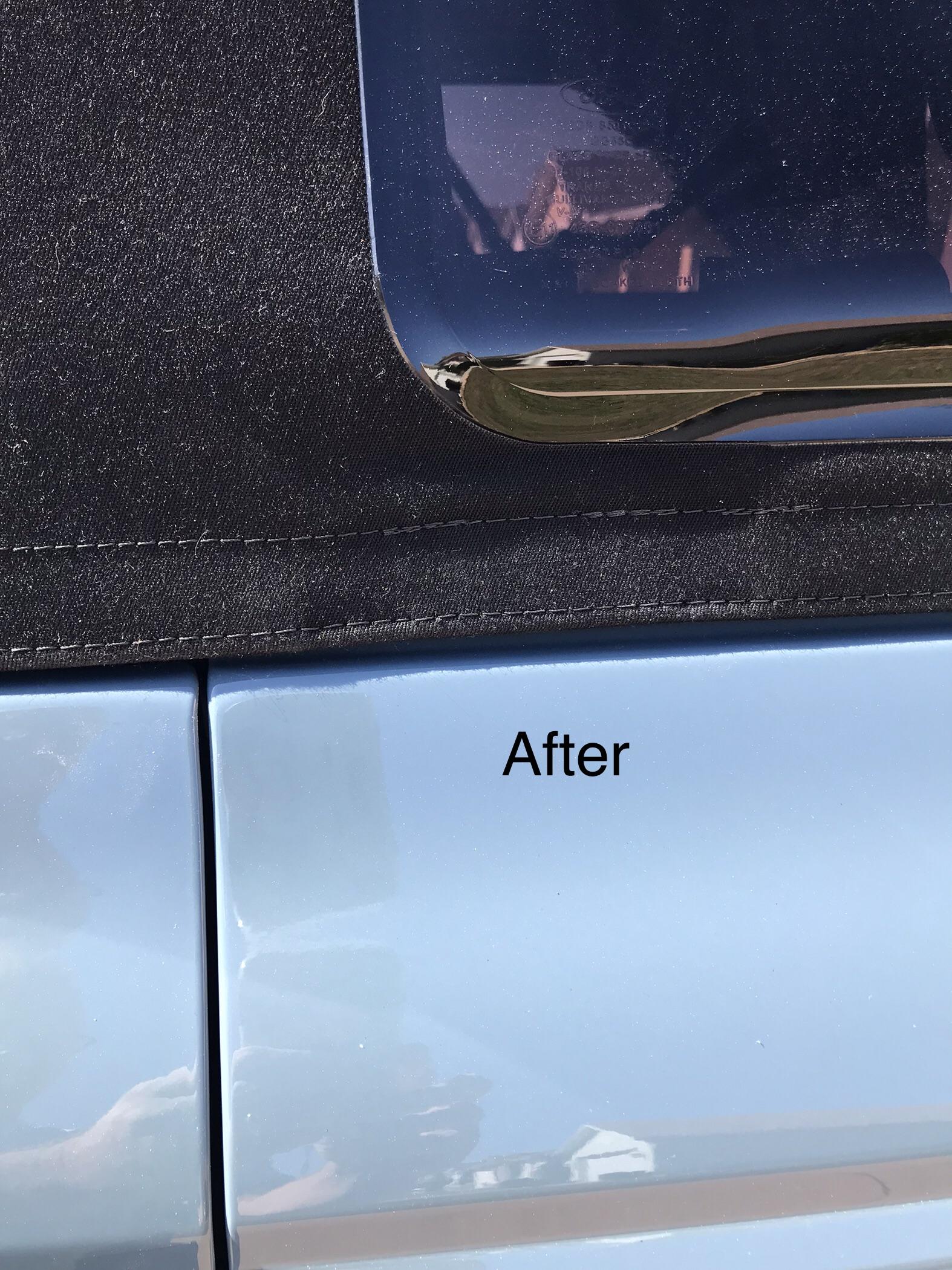

I did a small modification to fix uneven canvas along body line at bottom of side windows. The small plastic piece that accepts the short forward piece of channel on the removable window does not align with longer section. Pics explain better. This is just a quick piece I made as a test. More room for improvement. The wedge shape plastic I made fits between the plastic channel and the mounting surface causing it to angle downward matching piece next to it.

Thanks for the tip, one side of my soft top was misaligned and that fixed it.

Under this piece. The wedge makes it angle downward better aligning with the rear section. This short piece is typically higher than the rear section. Don’t over tighten or wedge it downward too much as it’s thin plastic. But it really helped. Also would not hurt to round over the edge of channel. The removable window gets hung up easy at the transition.

The backside 2 bolts. It raises the inside therefore pushing the channel down just a little
