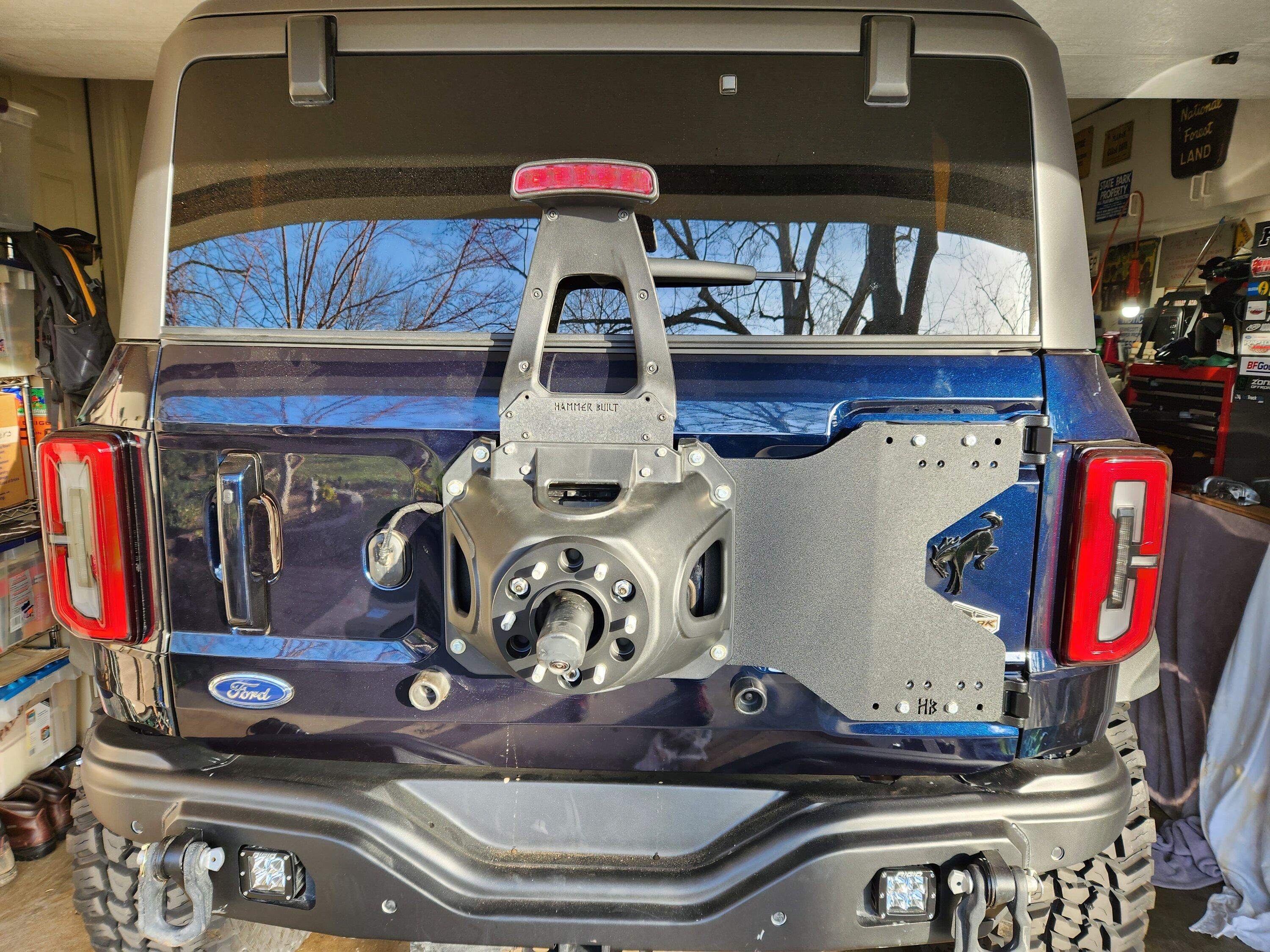

working on our own version of the RTR spacers so non raptor hinge guys can still run the HD bracket until they need to carry for weight and install the beefier hinge..
The original design has been Baja proven with dual 2 gallon rotopax, and a 37" tire. The HD bracket was conceived for the regular bronco owners who want to carry even more weight a 5 gallon jerry can and/or a spare tire platform rack with offroad boxes full of gear... It will also fit the Bronco raptor of course...

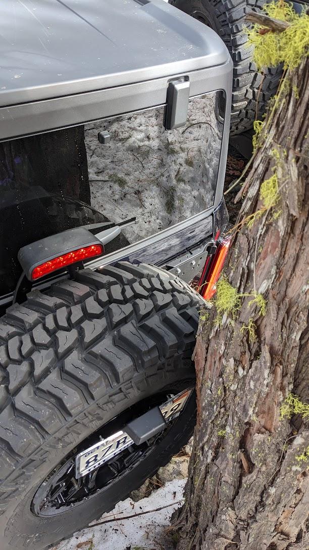

Trail tested in the Sierra this weekend installed last weekend.
Ford Bronco Raptor Tailgate Hinges installed with Hammerbilt Bracket 20230217_162852
Ford Bronco Raptor Tailgate Hinges installed with Hammerbilt Bracket 1676930223463
