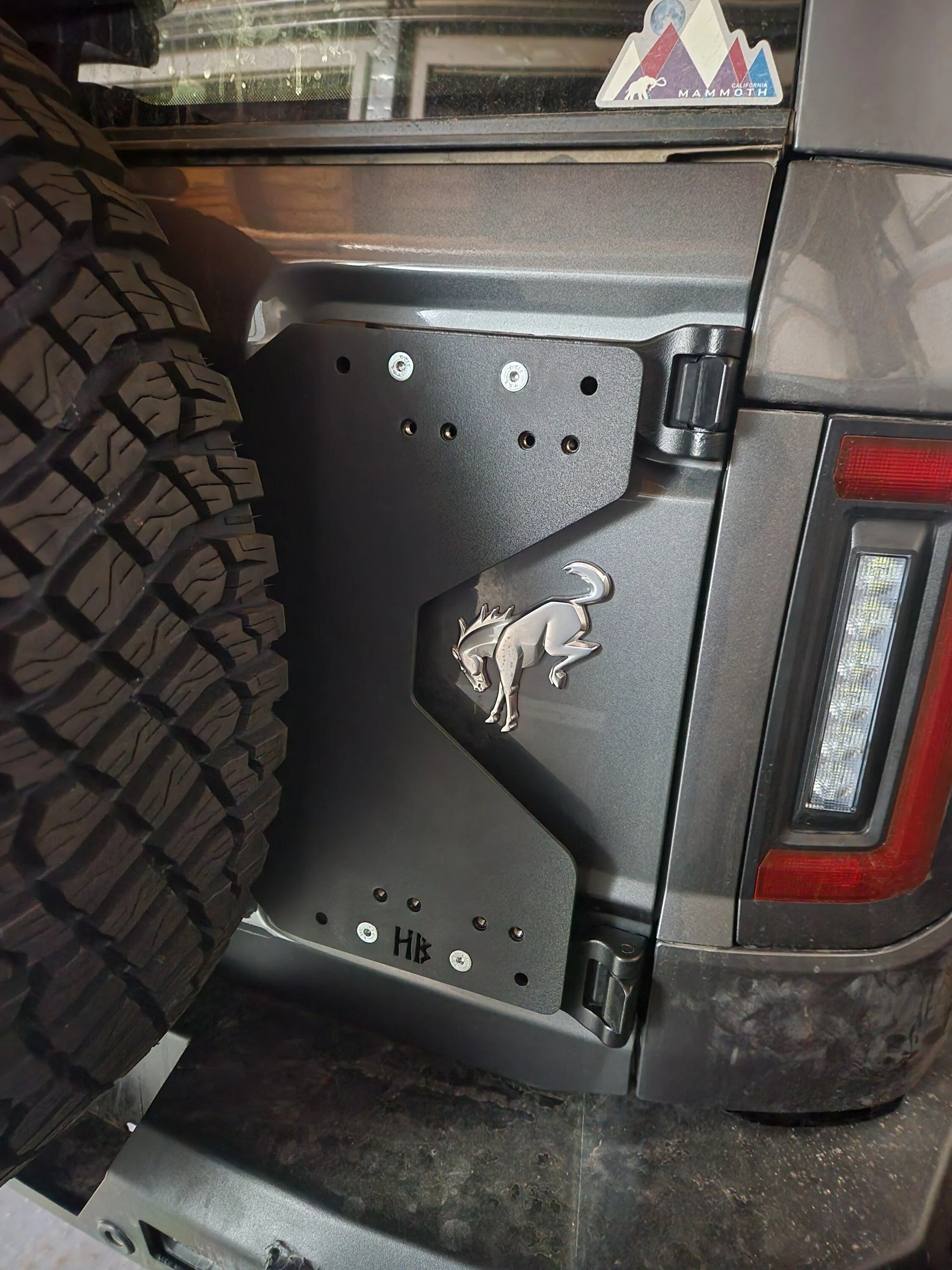

I installed the Raptor hinges and the Hammer Built plate (which will now work with OEM of Raptor hinges). The Raptor reinforcement will work with Raptor hinges, but you would need to notch your factory OEM tire carrier to fit the Raptor reinforcement underneath it (it would need to be notched on only one side). I believe the Raptor reinforcement lists for about 600 or so. Although I'm sure the Raptor reinforcement adds some rigidity to the tailgate, it doesn't have provisions for mounting other things like a Jerry carrier or other accessory mounts. I went back and forth on which system to go with and so far I've tried the RC, the BAMF, the RTR, and the Hammer Built. Here is what the Hammer Built looks like with Raptor Hinges.

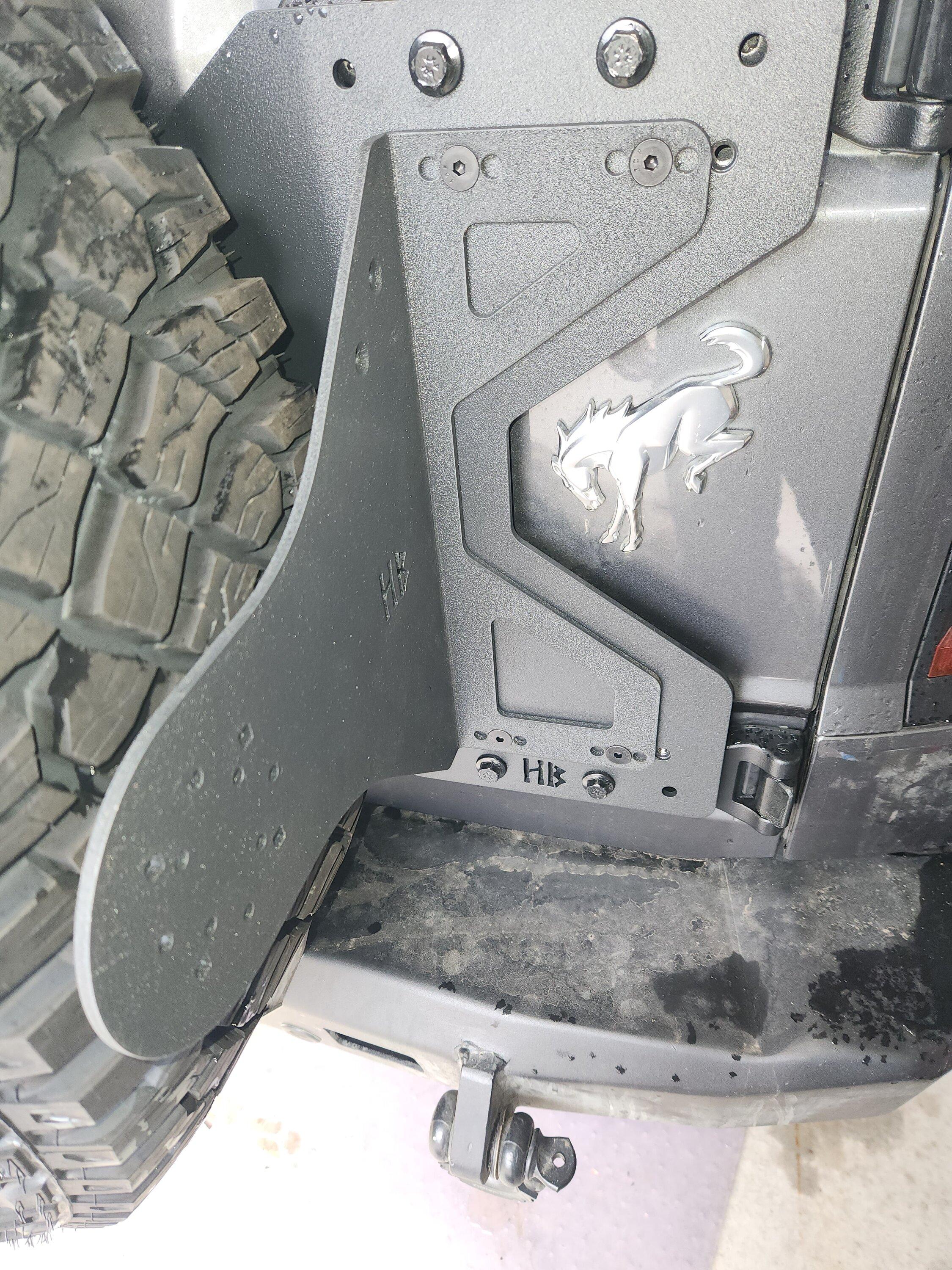

This is the accessory arm...you can mount a fuel can carrier, antenna, Max Trax, shovel, etc. If you decide to go with Raptor hinges I have part numbers and a good source that is like almost 40% less than from local dealers.

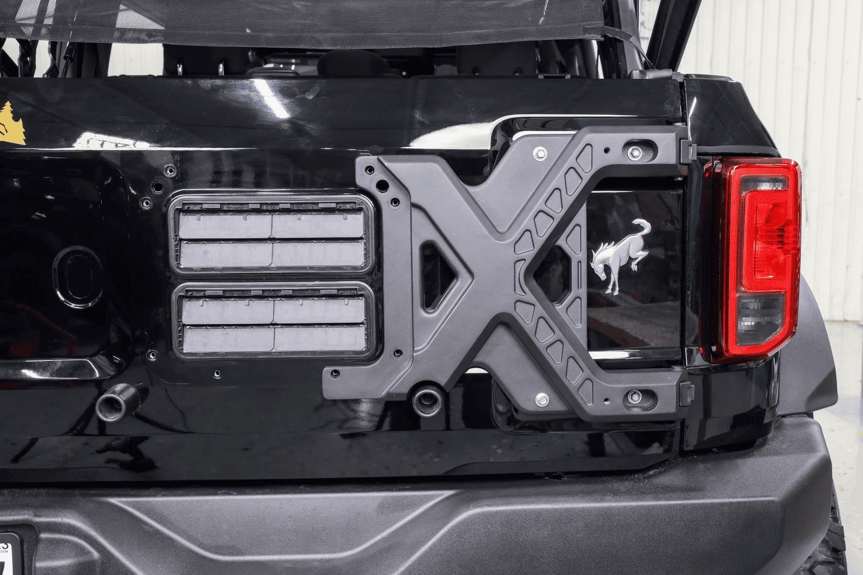

this was non-raptor bronco at the LA Auto show
Raptor hinges and the Raptor reinforcement....you can get the hinges for under 400 and that plate for just over 400 (both are now listed in the parts catalog). Also, Tyson at Hammer Built just finished the tweaks on the Raptor hinges Hammer Built plate, which will cost less than the Raptor reinforcement and fit either OEM hinges or the Raptor hinges (and it has functional mounting points for accessories). Lots of options out there now!
