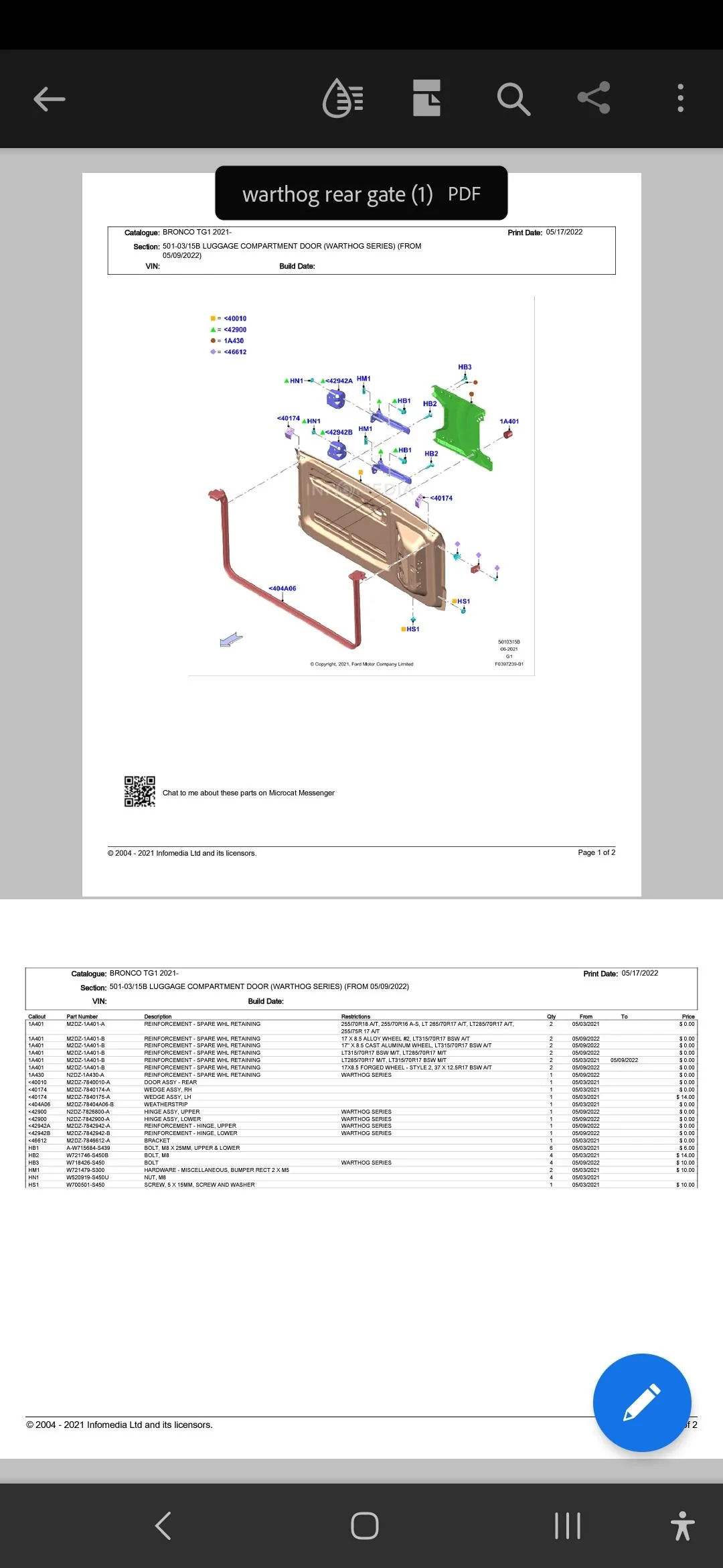

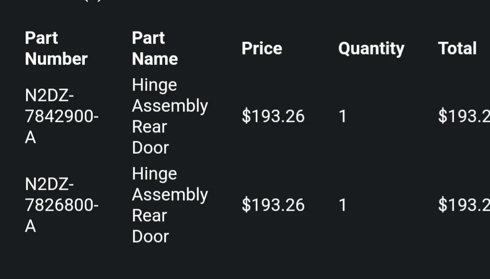

Might be able to find online but if you go to a dealership parts center they can usually look up parts and order for you.
Ford Bronco Raptor Tailgate Reinforcement part? Screenshot_20221208_155925_Acrobat for Samsung
Ford Bronco Raptor Tailgate Reinforcement part? Screenshot_20221103-172914_Gmail
Note that the Raptor reinforcement won't fit your OEM carrier unless you notch your carrier (that is why I went with the Hammer Built plate...that and because the Raptor one retails for over 600).

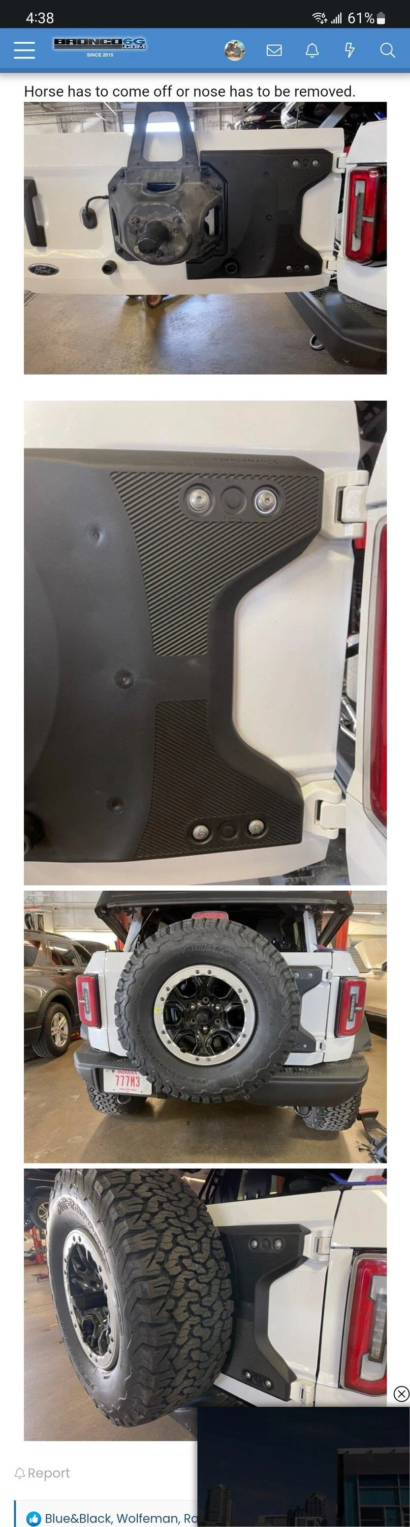

You can see the setup Flip went with here...he notched his OEM carrier and added Raptor hinges.

Note that the Raptor reinforcement is VERY flimsy. It may look cool to some, but in regard to actually structural rigidity the strength comes primarily from the angled upper and lower bends. The unit is so thin that Flip had to notch his OEM carrier only very slightly. Tyson at Hammer Built has a Raptor in his shop now, and he can share his thoughts if you reach out to him regarding that reinforcement from a fabricator standpoint.

it might be flimsy off the truck but is anyone actually bending their gates with a 37 and no other add ons? afaik the raptor reinforcement has survived every full send and has been holding up. it triangulates the hinges to the carrier, and doing so with the dynamic load of the 37 is impressive imo.

I believe the Raptor reinforcement with only the Raptor spare is fine...it is when folks start adding other things that they are pushing the structural limits. Some folks are hanging all kinds of stuff off their gates and then wondering why they now have a creak or misalignment...

Ok that makes sense!
