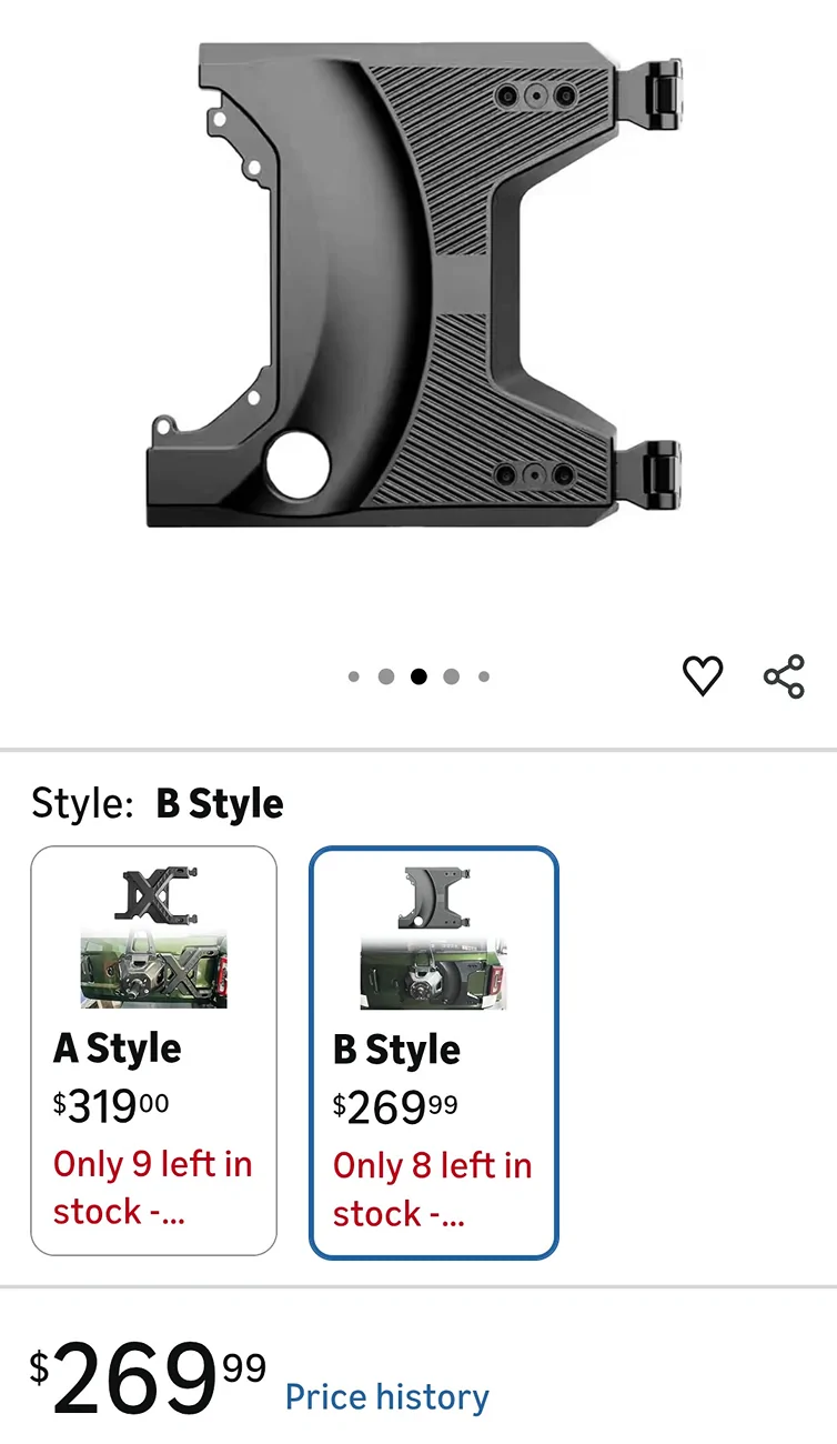

I've been wanting one of these for a while, but the price.....
Being picky about which style...of course the one that looks like the Braptor is the best looking for me.
Found this one on Amazon for a better price. Pulled the trigger risking a poor quality unit.
https://a.co/d/ewT4CeS
Ford Bronco Tailgate Reinforcement Install Screenshot_20260105-114204.Amazon Shopping (1)

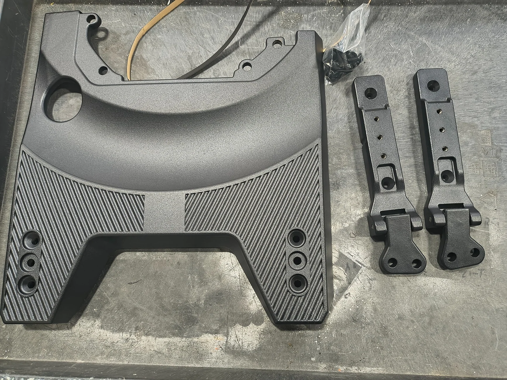

Just got it in and seems very good ... Heavy metal and beefy hinges....Powder coat looks good. Overall looks and feels right.
Ford Bronco Tailgate Reinforcement Install IMG_20260105_115240377_HDR

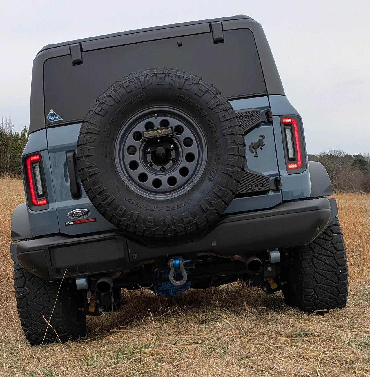

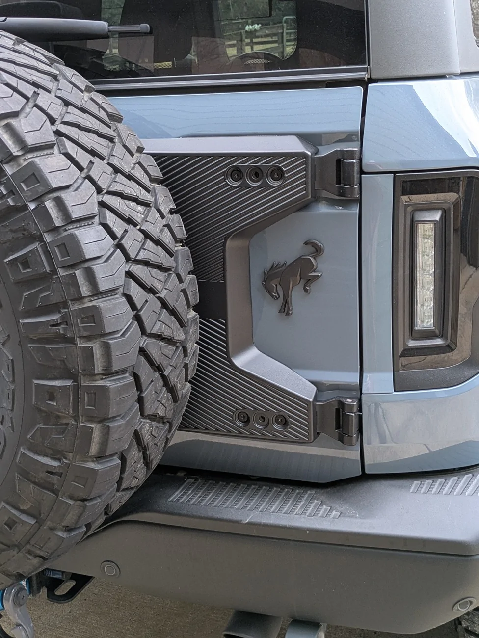

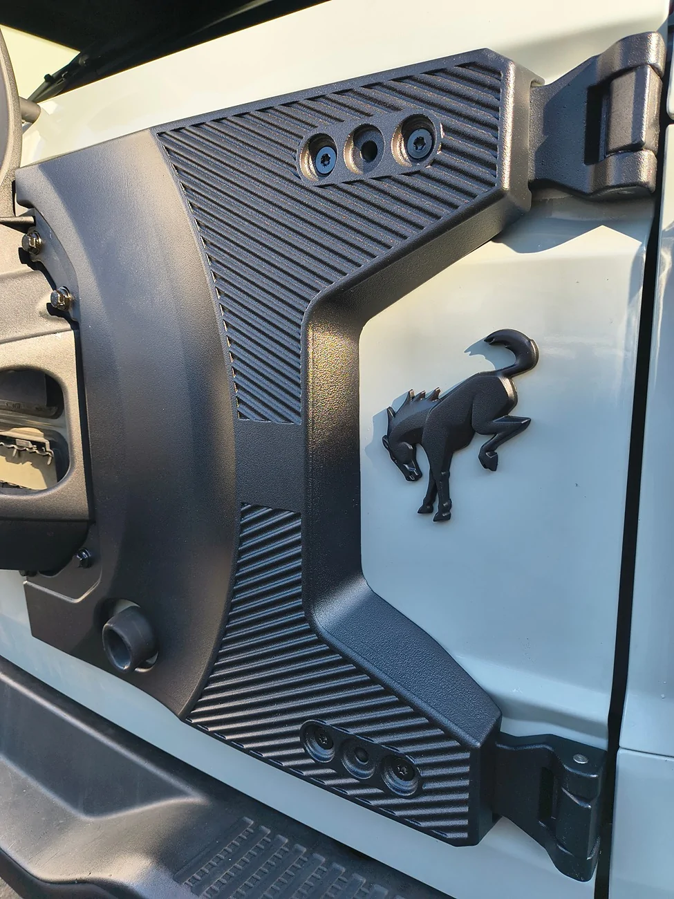

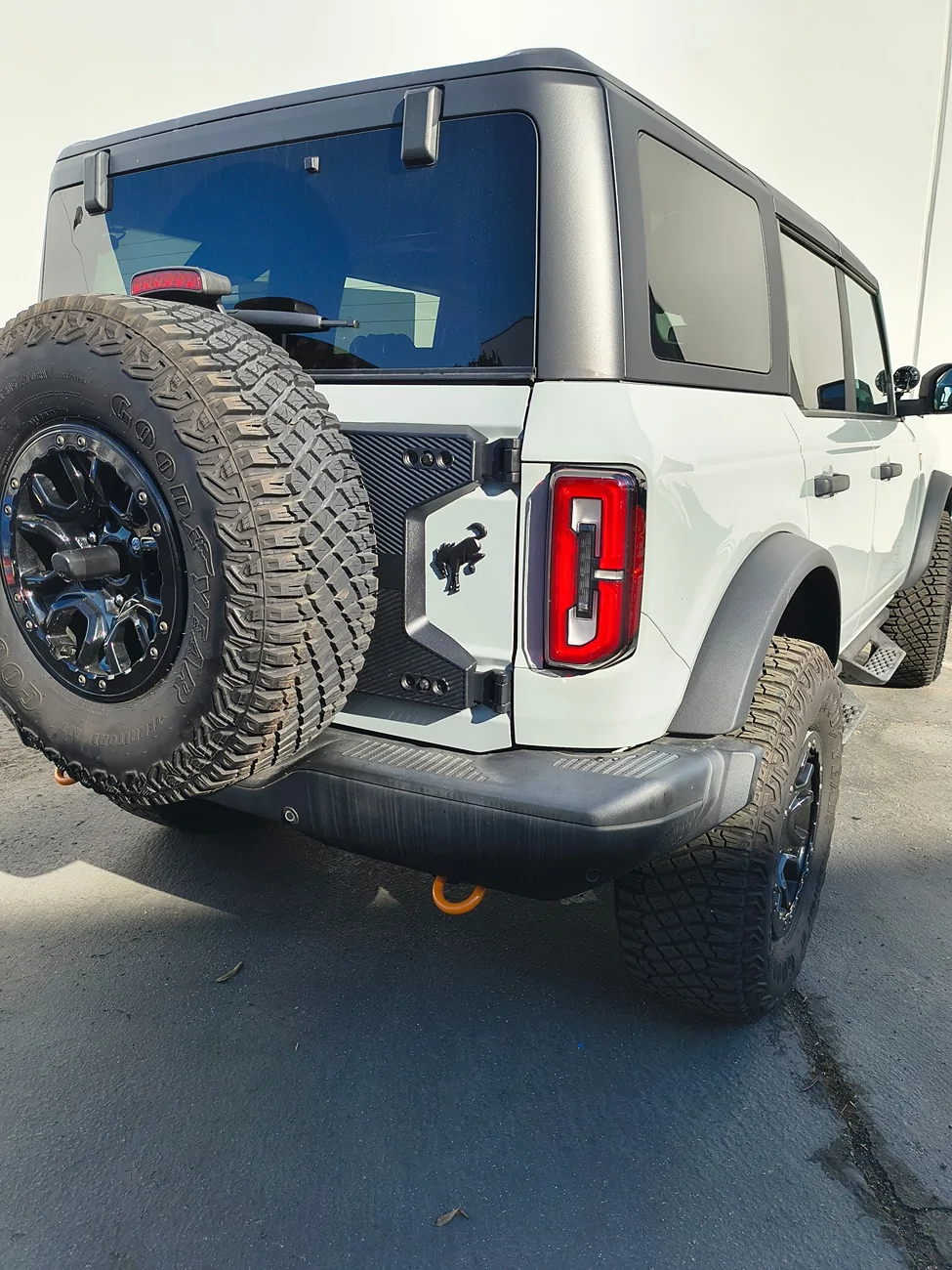

I just installed one of those. Fits good. Takes a little patience to get the tailgate aligned before final torque of fasteners. Wrestling my tailgate with a tailgate table installed was slightly challenging working alone.
Ford Bronco Tailgate Reinforcement Install PXL_20251227_222851060
Ford Bronco Tailgate Reinforcement Install PXL_20260102_180208551.MP~2

I have not noticed "squeaks, groans, etc" from the tailgate. I had a Barnes tailgate support before installing the BRaptor knock-off so I have had some support back there for awhile now.

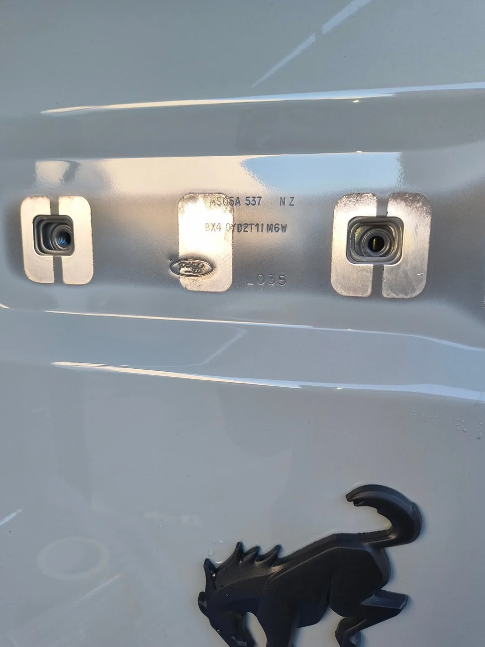

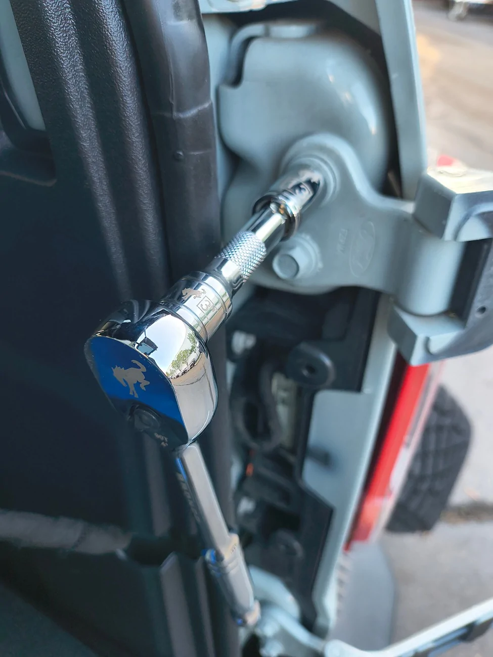

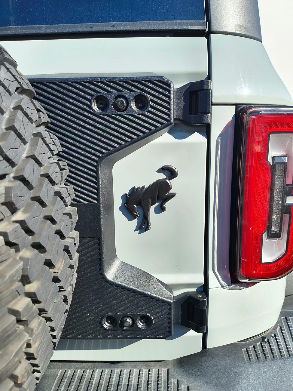

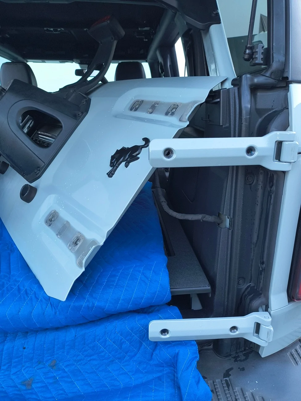

Installing was easy.... Lining up the door....was as expected, whole host of loosening and tightening a bunch of times. Well worth it in the end.

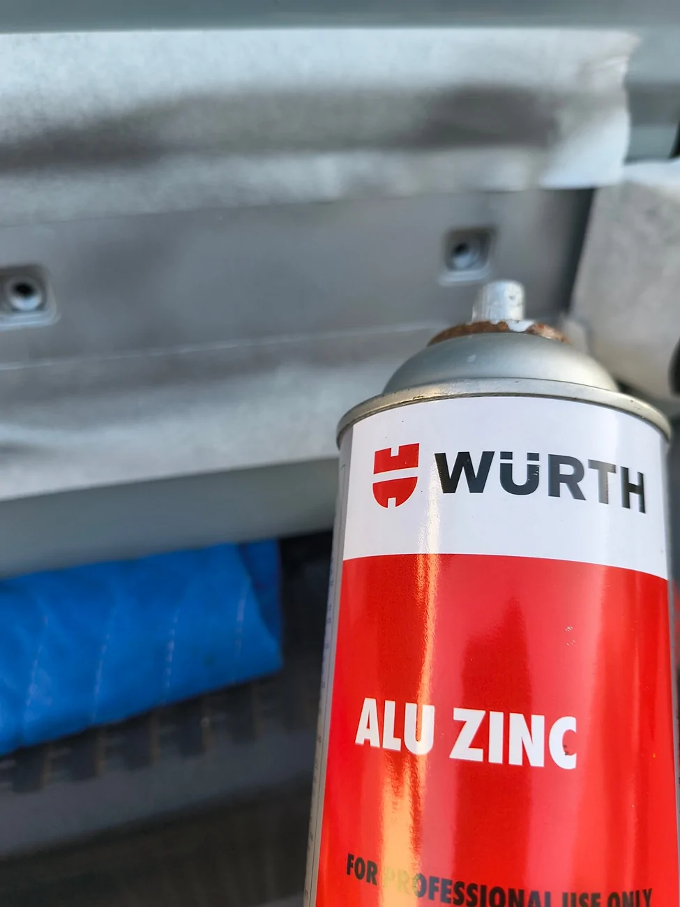

Bare aluminum under oem hinge.
Ford Bronco Tailgate Reinforcement Install IMG_20260107_080842820
Sprayed a little Alu zinc
