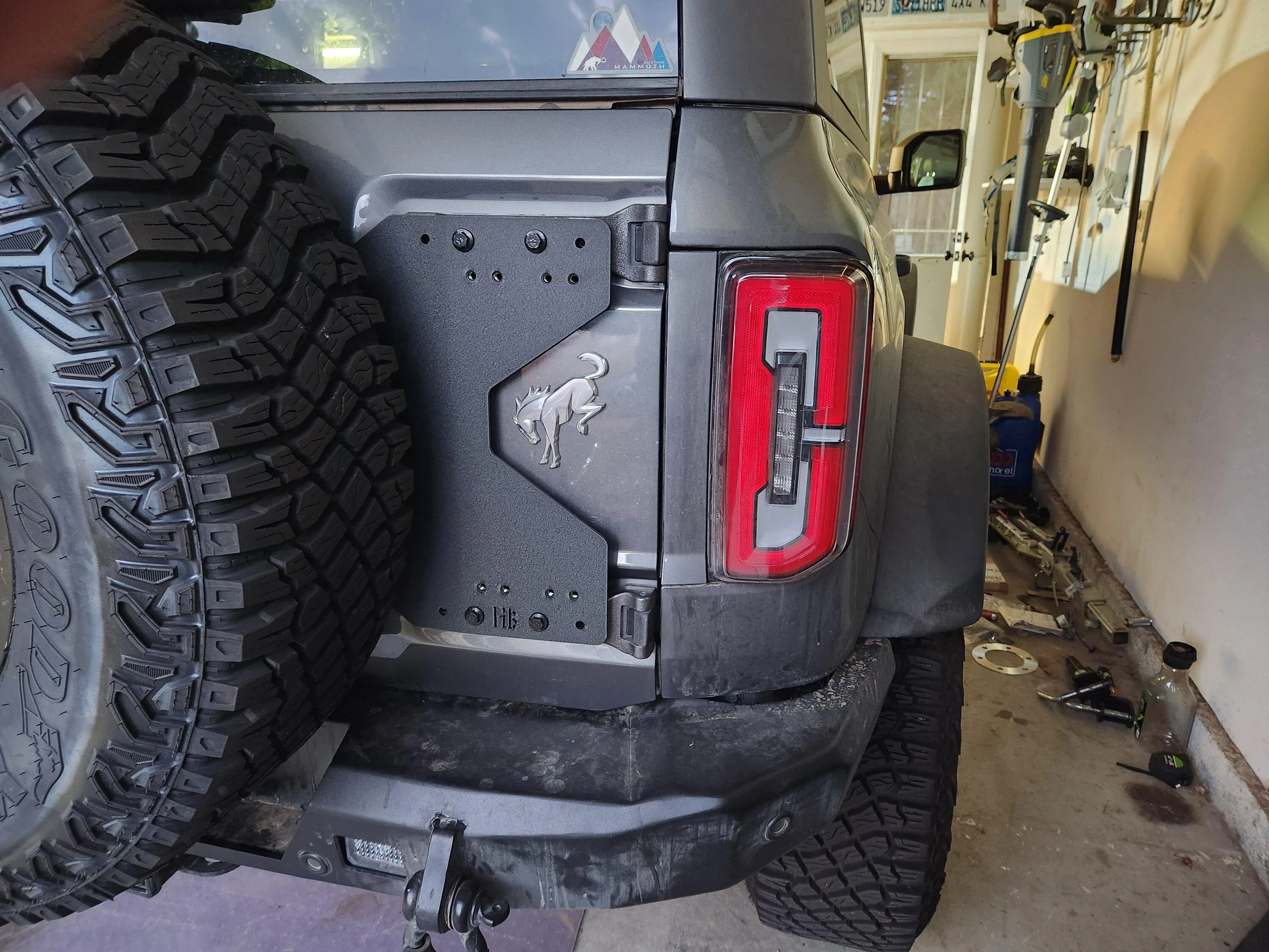

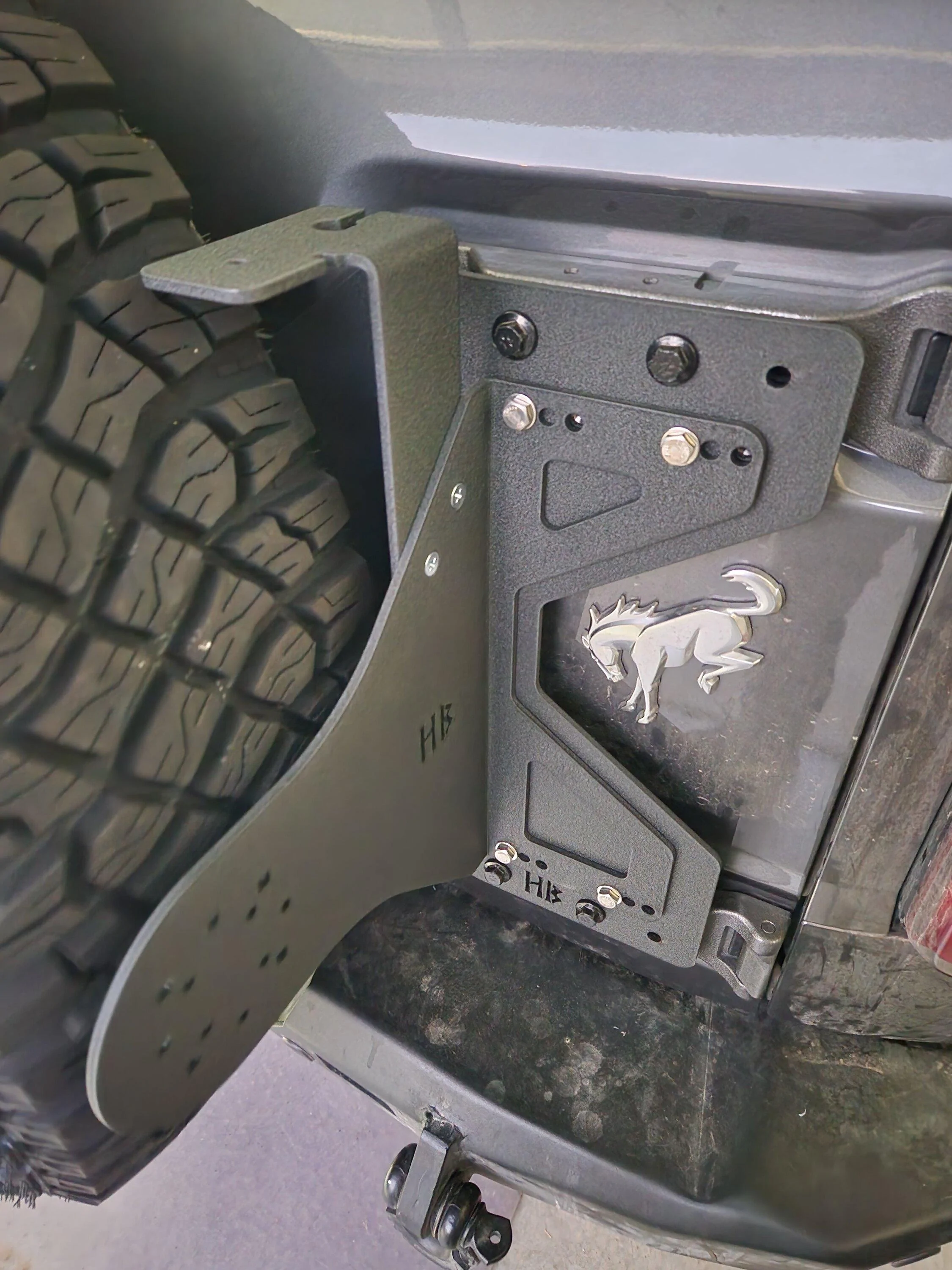

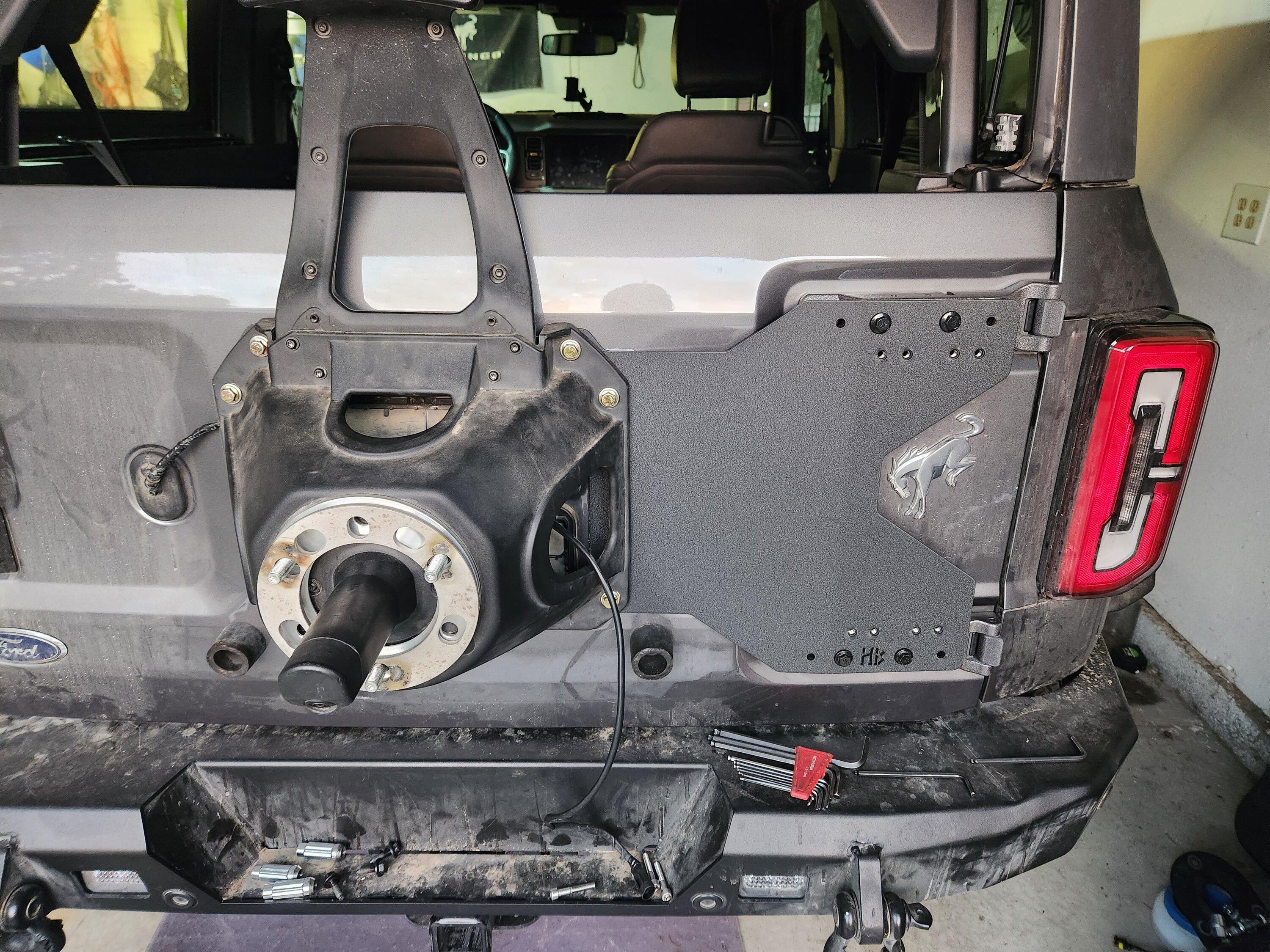

Does this mount Keep the tire centered and at the same height as stock?
Yes. The OEM tire carrier remains in the same location (the bracket goes underneath it, and uses the same through-holes for the bolts). In the picture you are referring to, I had used the Raptor hinges. You can use your OEM hinges as well with the first gen plate (or with the second gen plate and RTR spacers). I prefer either the spacers or the Raptor hinges and the second gen setup to the first gen setup. Either way, it is a clean install with minimal added weight.

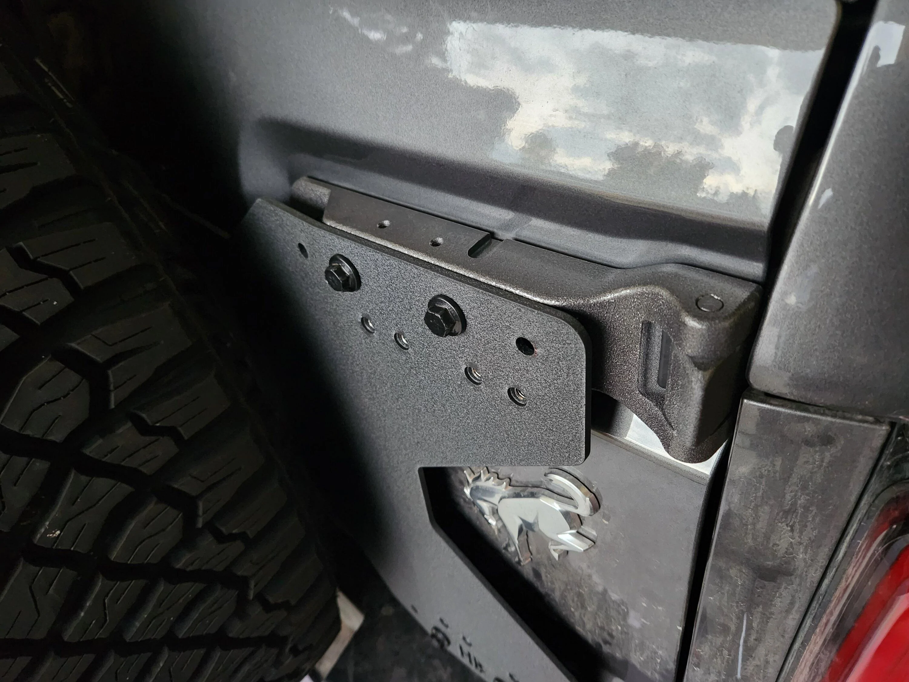

Excellent. Thank you for the info. Wondering also how easy it is to replace the hinges with the Raptor hinges. Are the factory ones painted on to where you have to crack the paint? Or is that not an issue?
broncorik
Rob
Mar 7, 2020
52
1,829
2,497
91320
Mine must have been painted separately...no issues pulling them off and good paint underneath. Raptor hinges come primed but I went with powder coat black.
