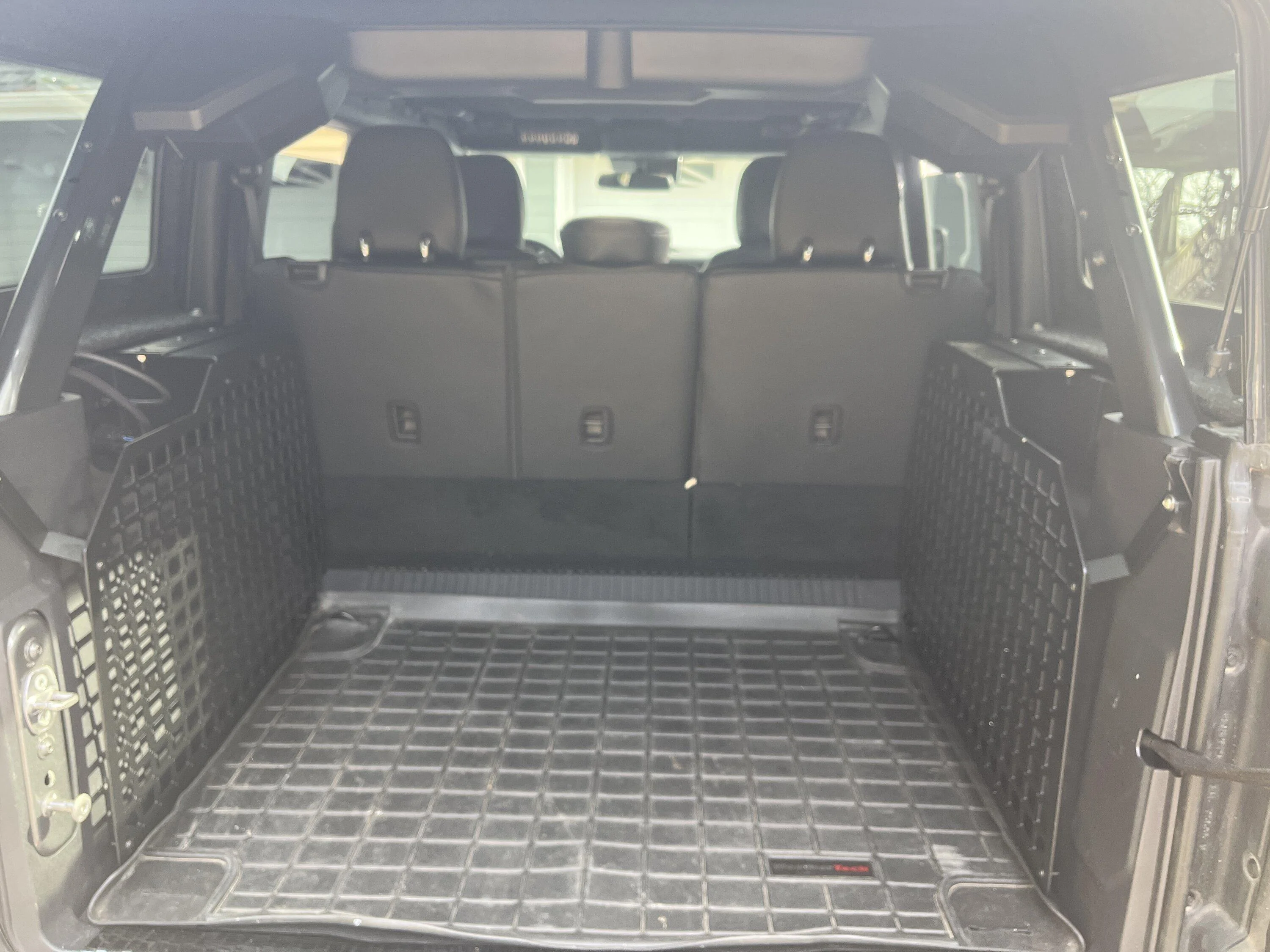

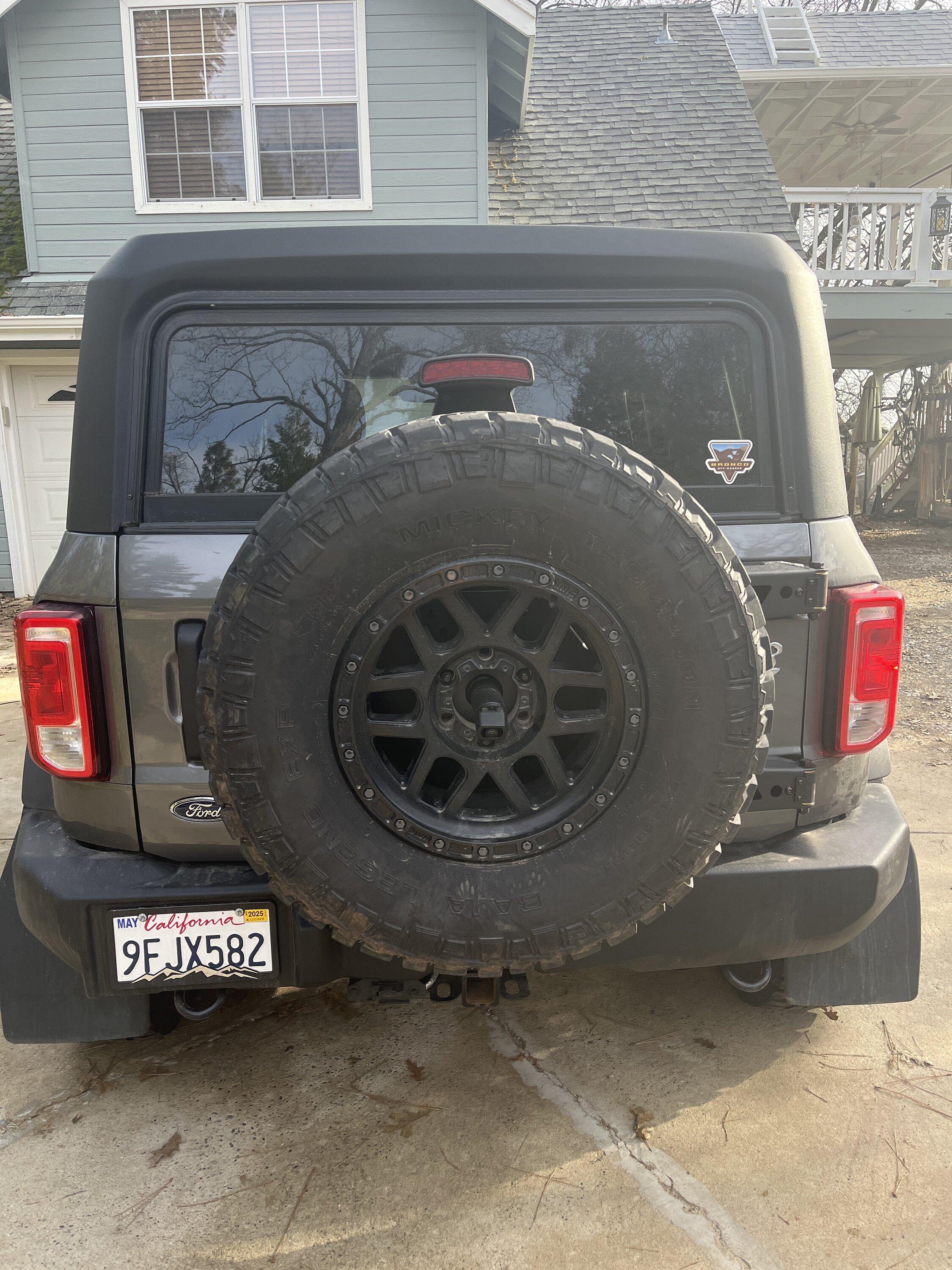

Excuse the paw prints. The tailgate still has a bit of alignment I need to adjust. It’s close but you can see just a bit of misalignment on the upper right body line, although I’ll never get it perfect since the tailgate is twisted a bit from before. The painted bolts on the strike plate are wanting to not move - I stripped out one T35 bit on them, so waiting on some stronger impact bits to try to get those loosened up.
I did manage to squeeze the Weathetech mats up around the M2M molle panels - it isn’t perfect but will do for now.

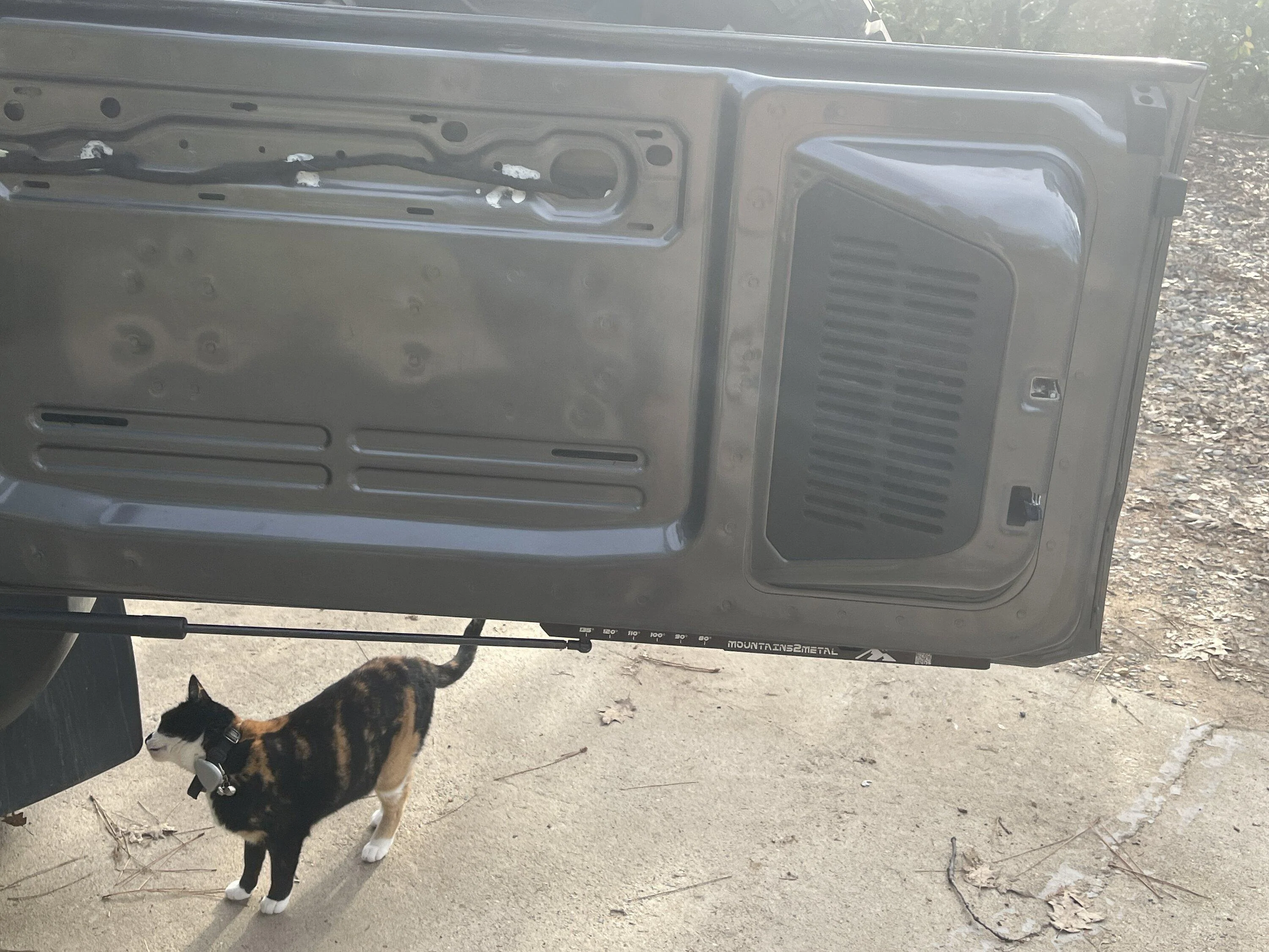

I have the HB. Not sure about customer service, it’s fine but nothing to write home about. I ordered their range limiting gas strut and the plastic mandolin fitting that attaches to the tailgate broke in half after just a few months, while I was in a parking lot minutes away from a Bronco in the smokies event in the fall. Never got that resolved, went back to OEM and a different limiter solution.
