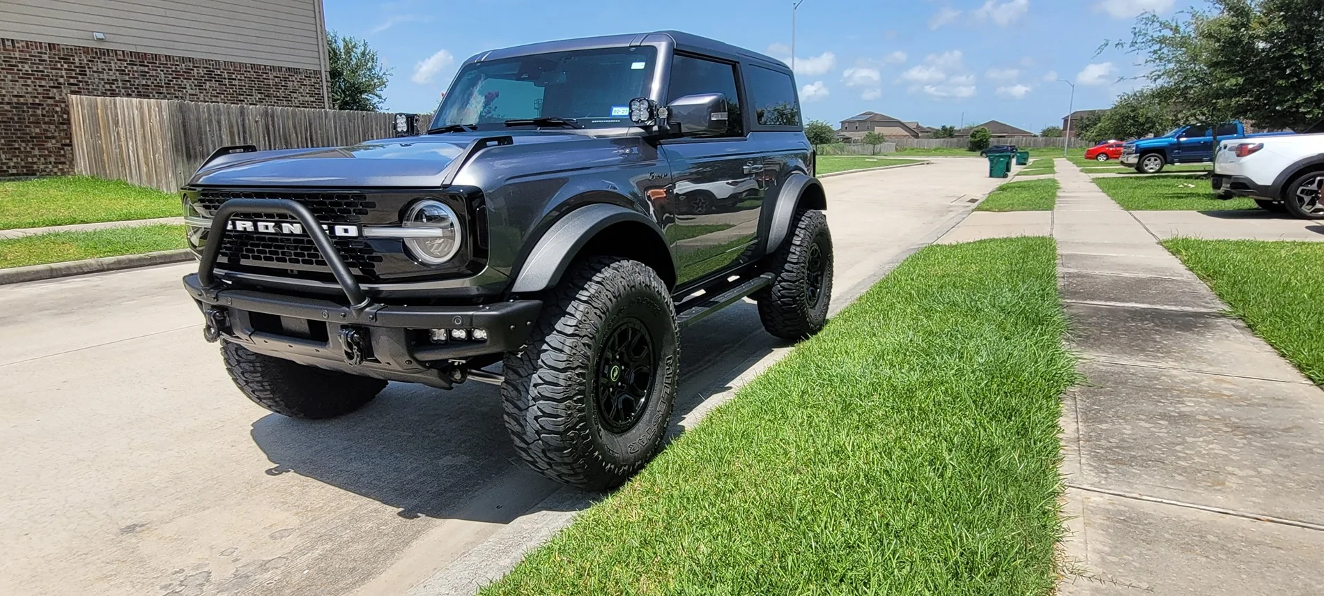

I'm working on my set up now. Running 38x13.5r17 patagonia mt. I got the red rock hinges and reinforcement kit. Got it powdercoated to match. Using prismatic powders. The 38's were to tall to fit, so I order the turn offroad tire relocation, hopefully it works with the support.
Ford Bronco Body-colored tailgate reinforcement: Anyone? 20260626_143520
