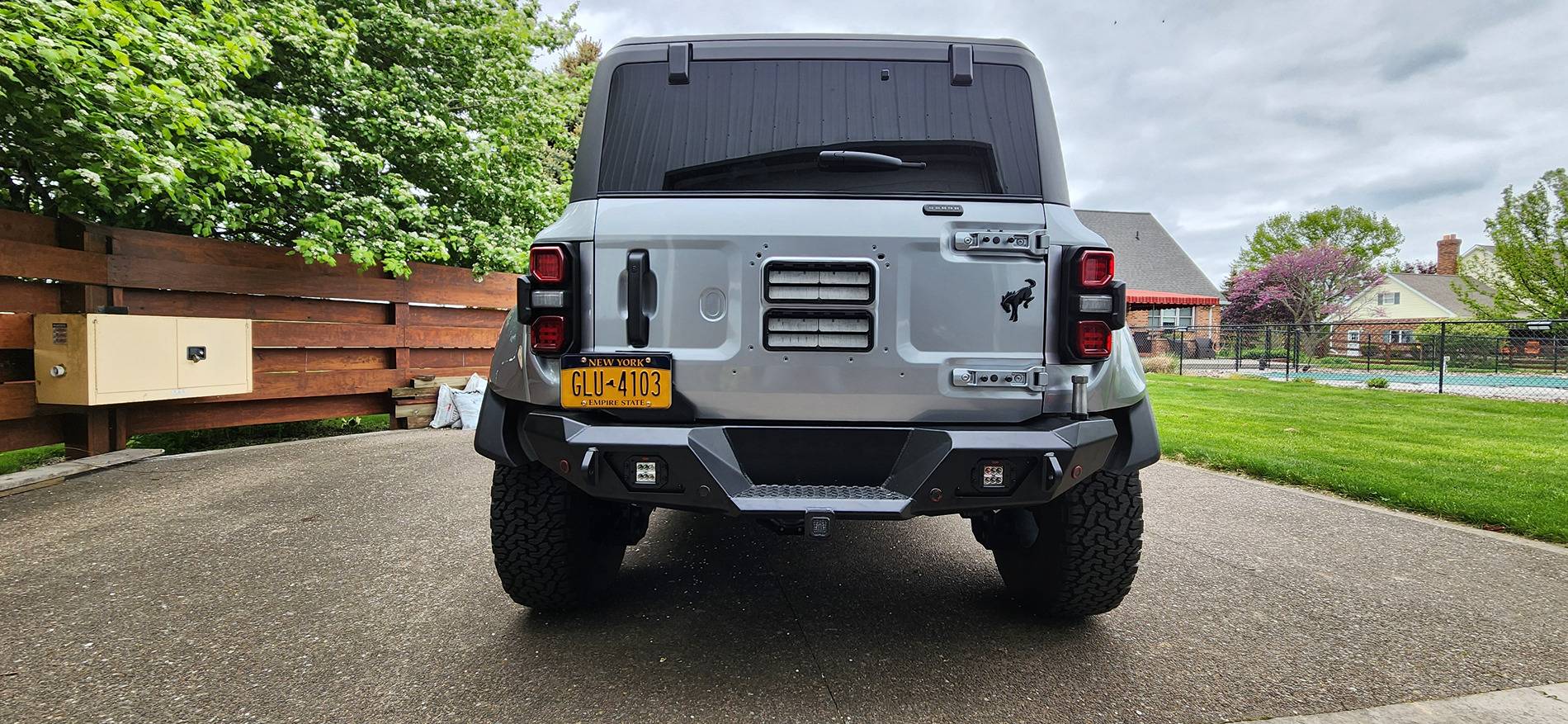

Has anyone done this? If so, pics please.
All of ford bronco hinges are painted body color … because they are assembled before painting. Including BRaptors
Ford Bronco Body-colored tailgate reinforcement: Anyone? IMG_7577

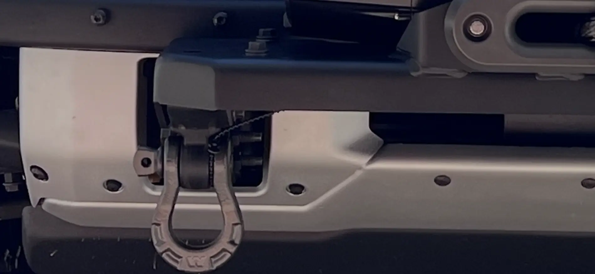

I have purchased the ford raptor kit and figured since you cannot really see them I would just paint the shield…

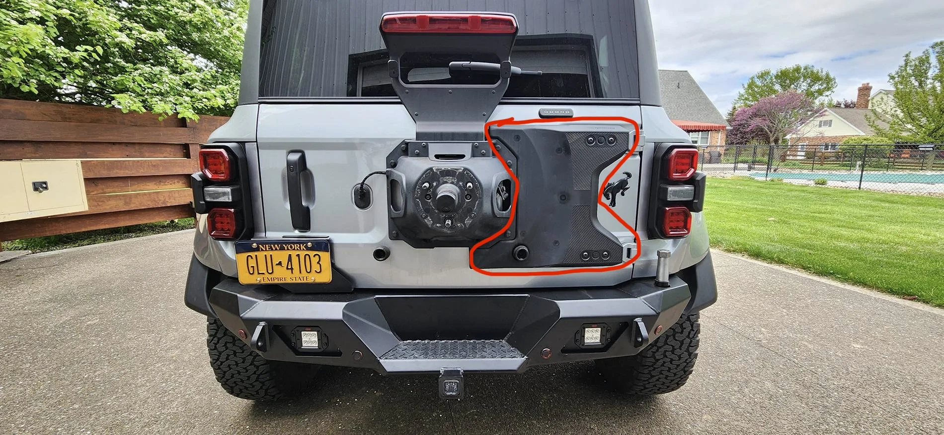

@Q1svt : Just to clarify, this is the part I’m talking about color matching:
Ford Bronco Body-colored tailgate reinforcement: Anyone? IMG_1962
Although on the Braptor version, it might look odd with the texturing. I’d have to see an example first. What @Hbrichman posted was more what I had in mind.

… okay , I painted my front plastic bumper tow hook cover but in a Braptor silver ish. Was going to also paint that support the same silver.
You may already know it’s plastic, with an internal thin metal support. Like all vehicles plastic parts, it’s paintable just need a flexible additive that helps adhesion and helps paint to be flexible. Like with plastic car bumpers… some paint suppliers can mix your color with the additives for plastic in a spray can.
With a textured plastic piece just need to not over paint it.. it will fill the texture. Personally the texture is very fine and will most likely be lost/smoothed out, the deep channels will be fine...
Since I am going with a fuel gas can carrier, no one is going to see that BR support piece, decided to not use the Braptor one, just fab an AL piece.

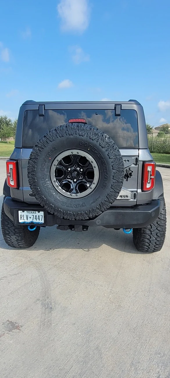

this is just the normal plastic cover not a Braptor one

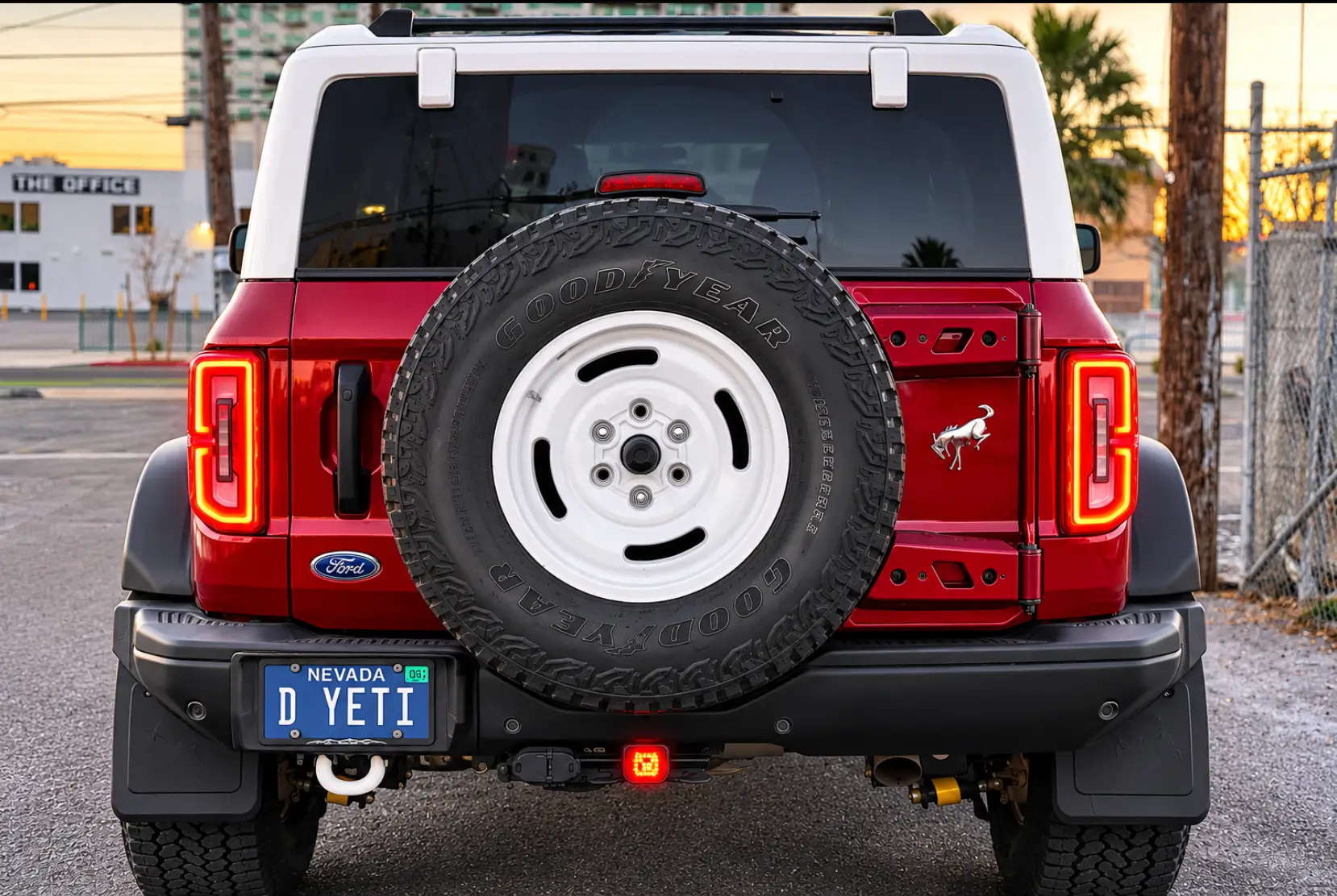

here is mine finally together, had it powder coated. And also have the Turn offroad TC4-M1 for the spare tire since the 38" didnt fit.

This looks great - would likely go this route if I ultimately decide to get the reinforcement. Thanks for sharing!
