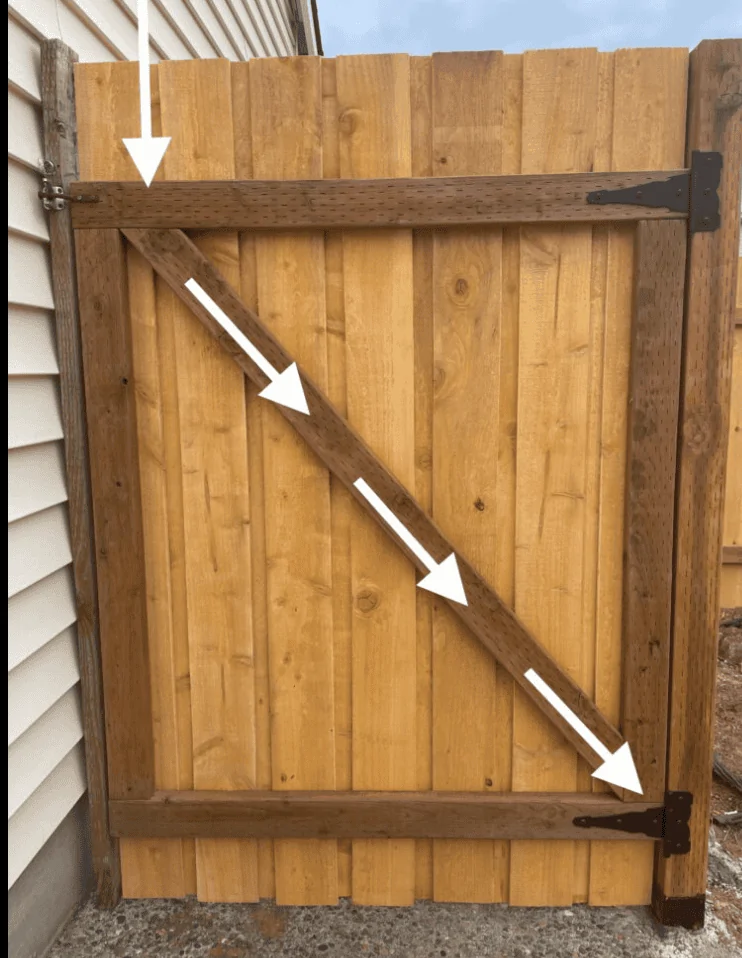

I don’t understand the entire dynamics of tailgate reinforcement- what is more important: reinforcing the hinges, beefing up the tire carrier, both? I will say these hinges seem to be the beefiest out there. Does that make them worth $529? Maybe, if hinges are the most important component.
Ok, full disclosure, I just installed a Turn unit on my Bronco recently - so take this for what it's worth.
The hinges on the stock Bronco are pretty beefy - they are solid steel and very stout. The raptor ones moreso. So I don't think the hinge itself is necessarily a weak point, but I'm not a mechanical engineer so I can just say that's my hunch there.
The problem is: stock - the spare tire hangs on the carrier, bolted to the tailgate. The tailgate hangs on the hinges, the hinges are bolted to the frame. The tailgate gets turned into a giant lever, with a lot of weight on it. It's just a very lightweight aluminum panel. It is rated for 133lbs on the carrier - so if it's just a tire, you are probably ok. But a lot of jostlying around off road, wanting to mount anything else back there, bigger tires, hanging things on the inside of the tailgate, etc... all that puts additional weight on that tailgate, which is a giant lever arm and pulling down on those hinges.
A "Standard" re-enforcement just cross-braces the two hinge points. Kinda like cross-bracing a fence or gate:
Ford Bronco Any consensus on which tailgate reinforcement has performed best? 1708714258885
That helps the tailgate carry that weight without shifting around or deforming. This would be like the Rough Country reinforcement plate, or the IAG tailgate re-enforcement. The weight continues to be carried by the tailgate, it still uses the same factory hinges, it just helps to brace and redistribute that weight.
There are some that upgrade the hinges, like the Mabett solution. It's a brace with different hinges, but it still requires the tailgate to carry all the weight. Or if you just upgrade to Raptor hinges.
Then, there are solutions that remove all the weight from the tailgate. The Turn carrier bolts to the frame with a new hinge, and the Turn carrier holds all the weight of the spare tire and tail gate - the tailgate just bolts to the new frame and looks pretty. Similar to the Smittybilt and APG rear-bumper / carriers, which moves the spare tire mount to the rear bumper. These pull all the weight off the tailgate entirely.
Do you need it? That is a question that can't be answered universally. Just there are these options out there.
Very well said! A great explanation for the different options. I went with TOR because I have a heavy wheel and tire and wanted to eventually mount accessories without having to worry.
