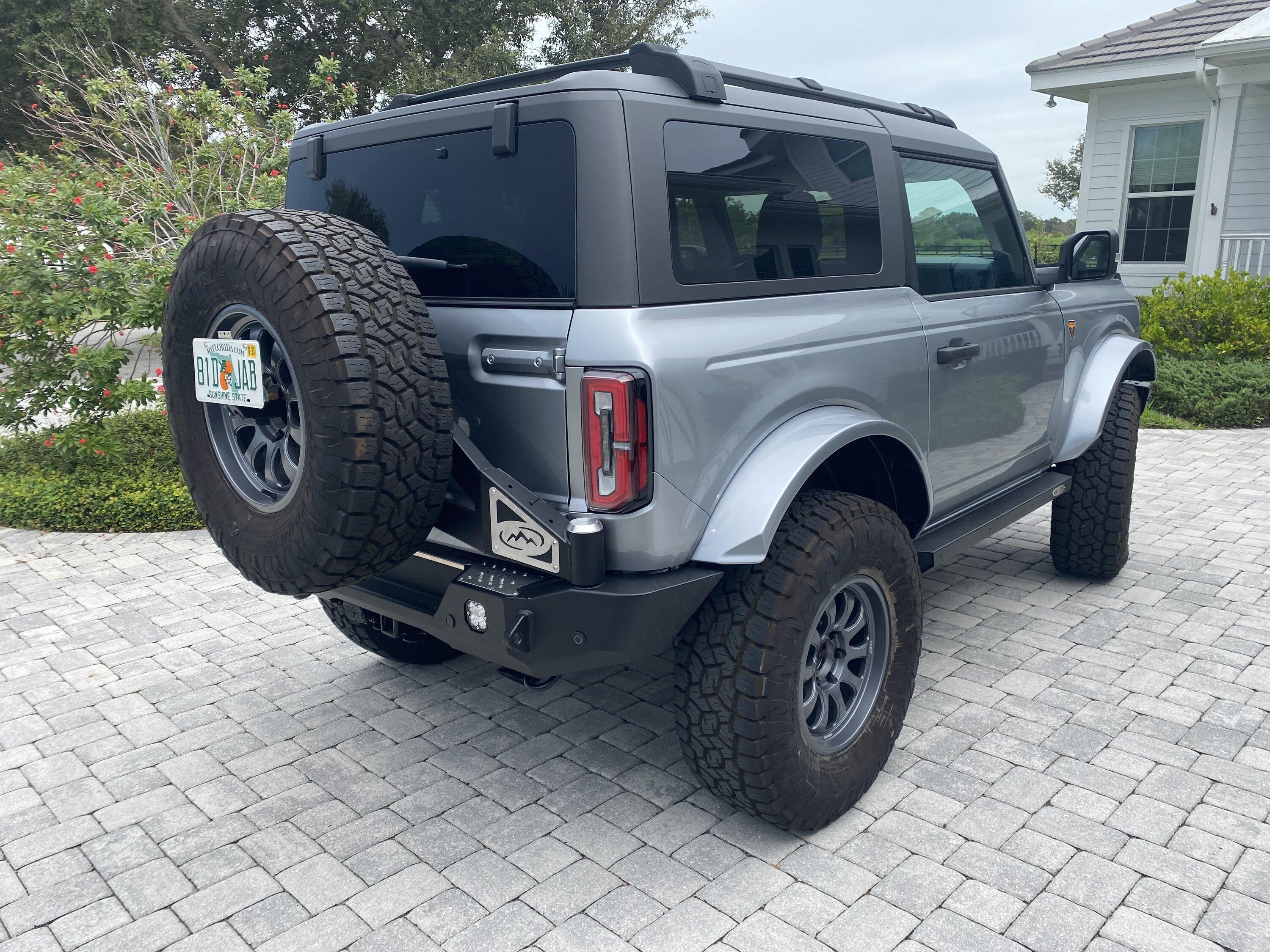

I went with the Expedition One Rear Bumper with Tire Carrier on my 2-Door with 37s. No weight at all on the tailgate and both swing out as one.

Lead time was very long for me too. I ordered the bumper last year. They also finally sent me a Brake Light Adaptor which uses the original Brake light. So, that should be available now too. The Powder Coat on the Bumper and Swing Arm is one of the Best I have ever seen. I hope they keep the quality up.
Overall I am very happy with the result.

A small pivoting arm with bushings on each end connects the Tailgate Brace to the Swing Arm. Both Tailgate and Swing Arm open as one unit.

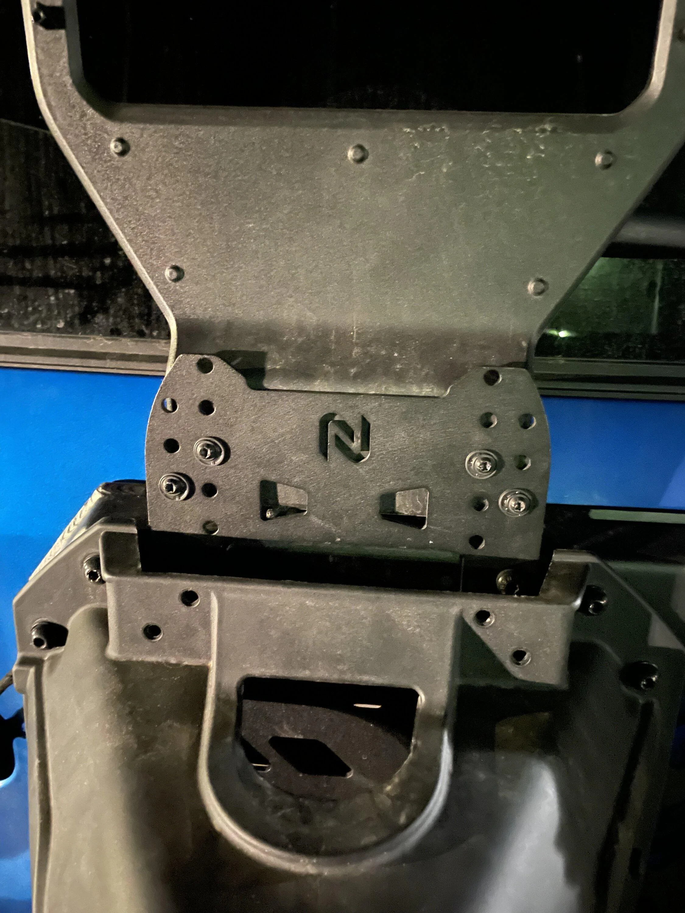

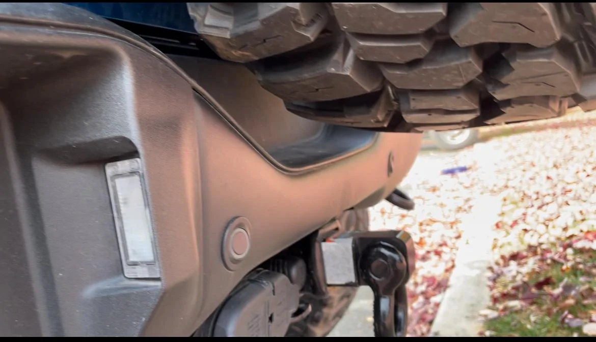

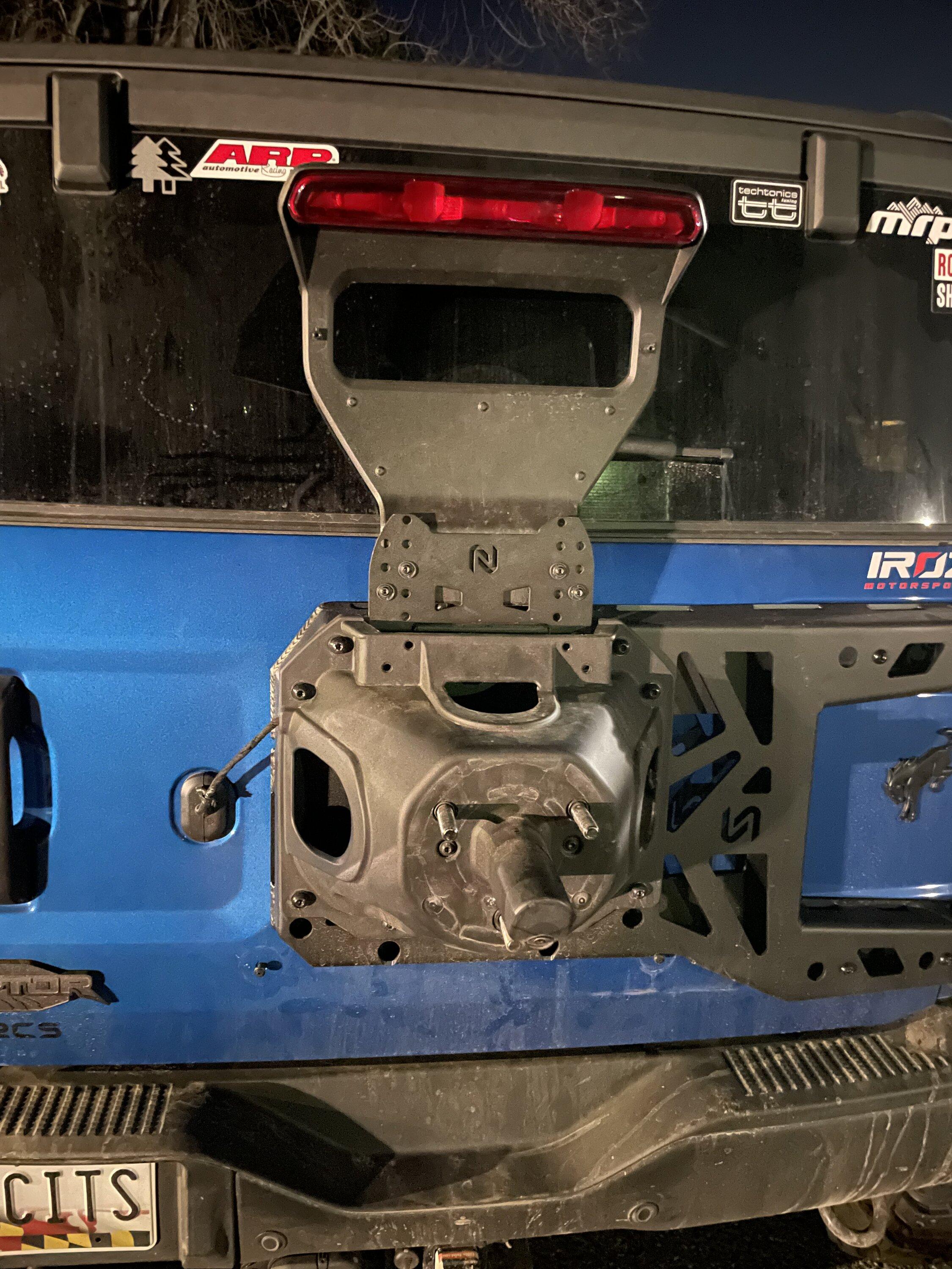

I just installed my @turnoffroad spare tire support brace
it works great on my factory rims and 40’s on stock bumper
Only issue is the Braptor lights hitting tire before bump stop cuz the lights stick out so much further

Dunno if you have one already but some tailgate limiters are available to address just that. Here's one from M2M.
I've got a Hammerbuilt reinforcement waiting to be installed. If I ever go harder with it I may consider the TOR option. Seems super solid.

Turn knows about it and I have sent them measurements from mine
they have a solution coming soon
I’d image it’s the same style limiter they have
Just bigger for the raptor lights

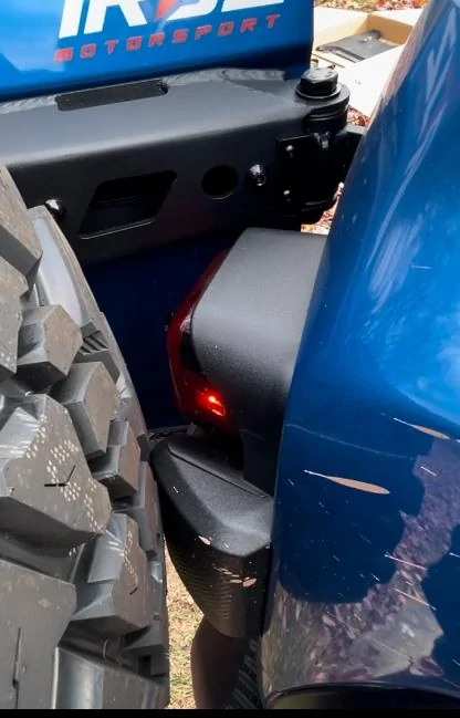

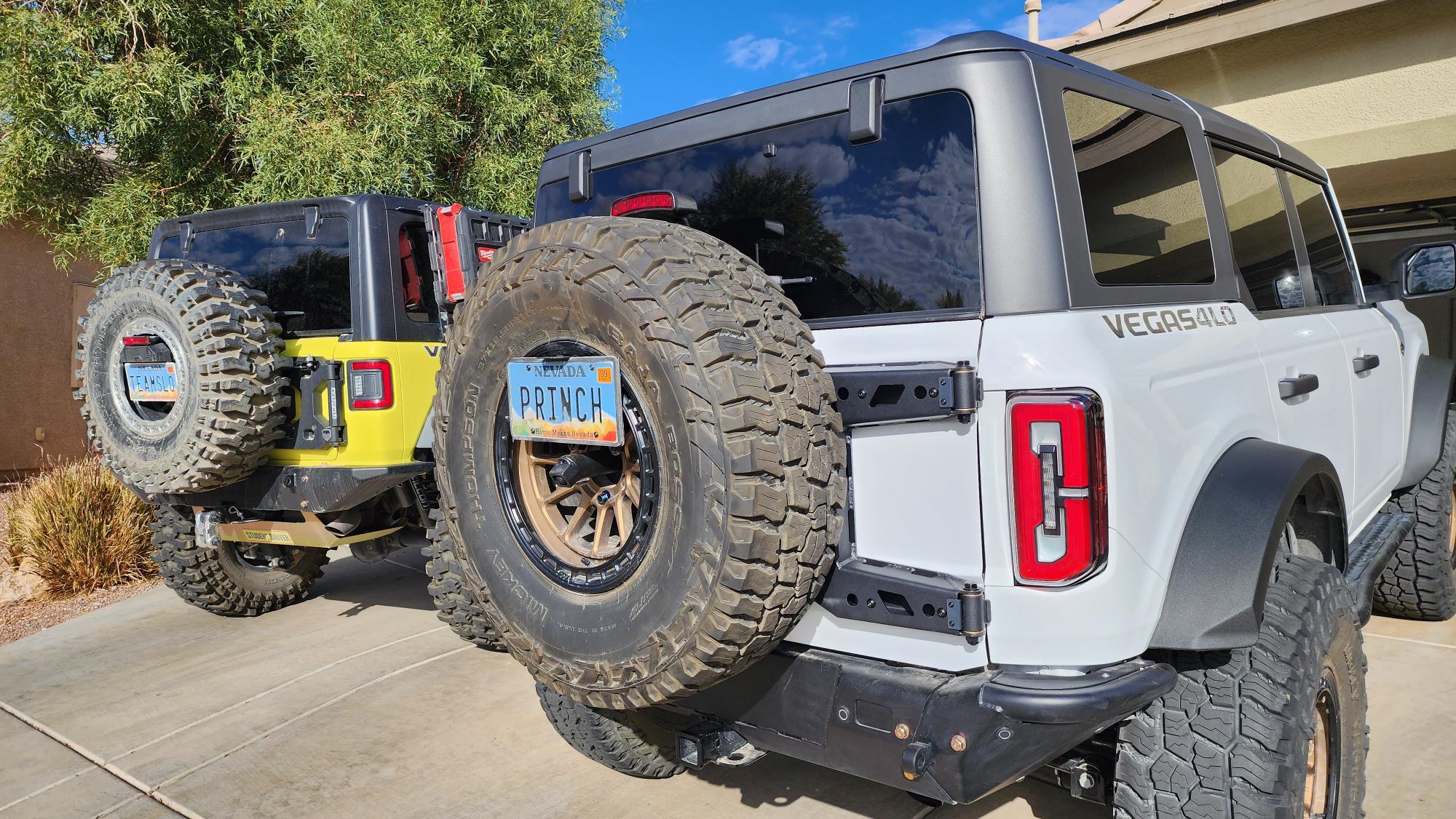

When choosing mine, had to have the following:
Full hinge replacement
- I wouldn't even consider one without the hinge replacement
No plastic, wanted full steel
Adjustability for different tire sizes both height and for different offset wheels meaning adjustability for depth
needed to have a license plate relocation available as well with all of the above
Went with the Turn Offroad reinforced hinge and carrier. If I could do it all over, still would make the same choice. I got all I wanted listed above and no more squeaky water bottle noise as well.

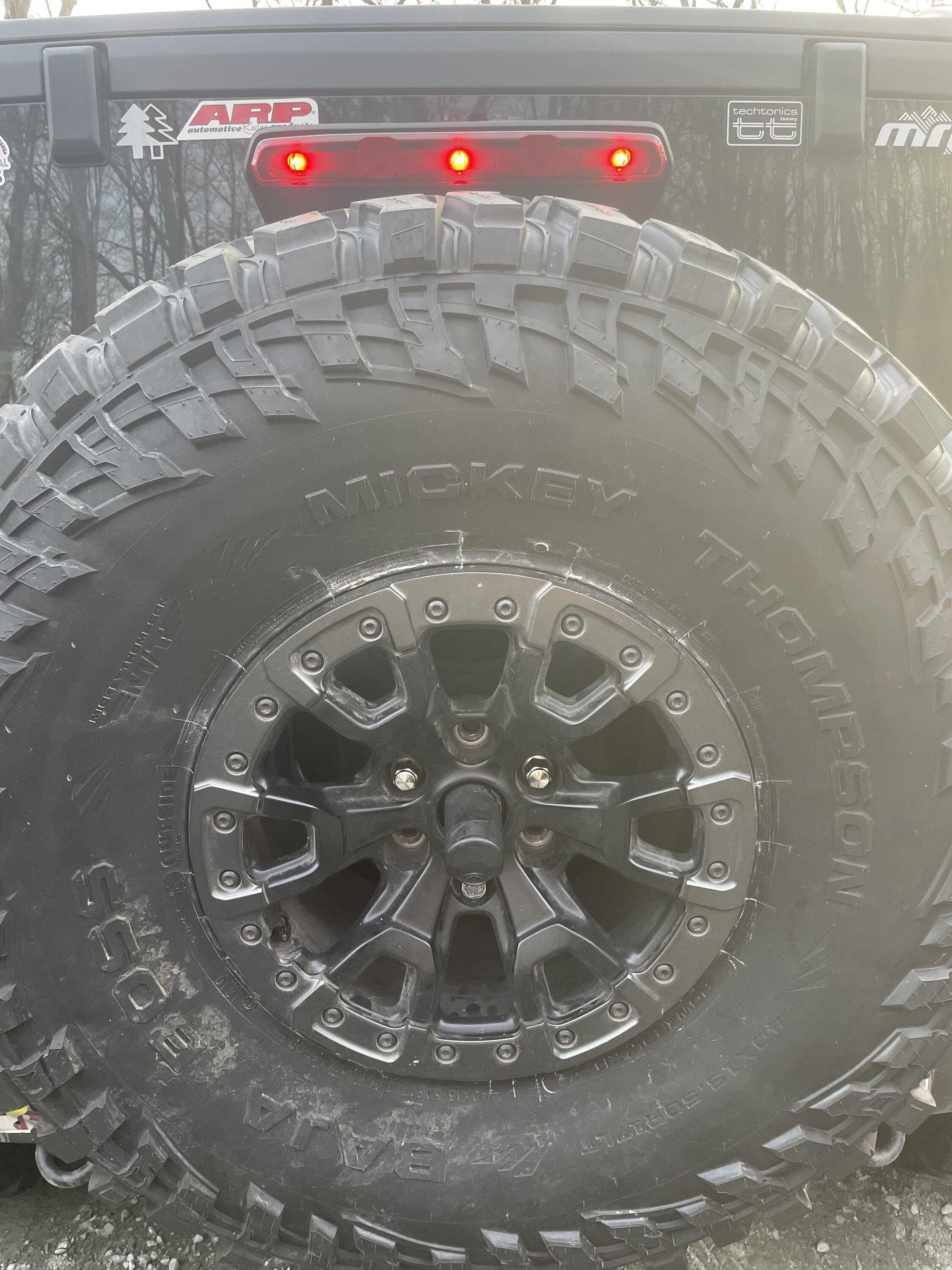

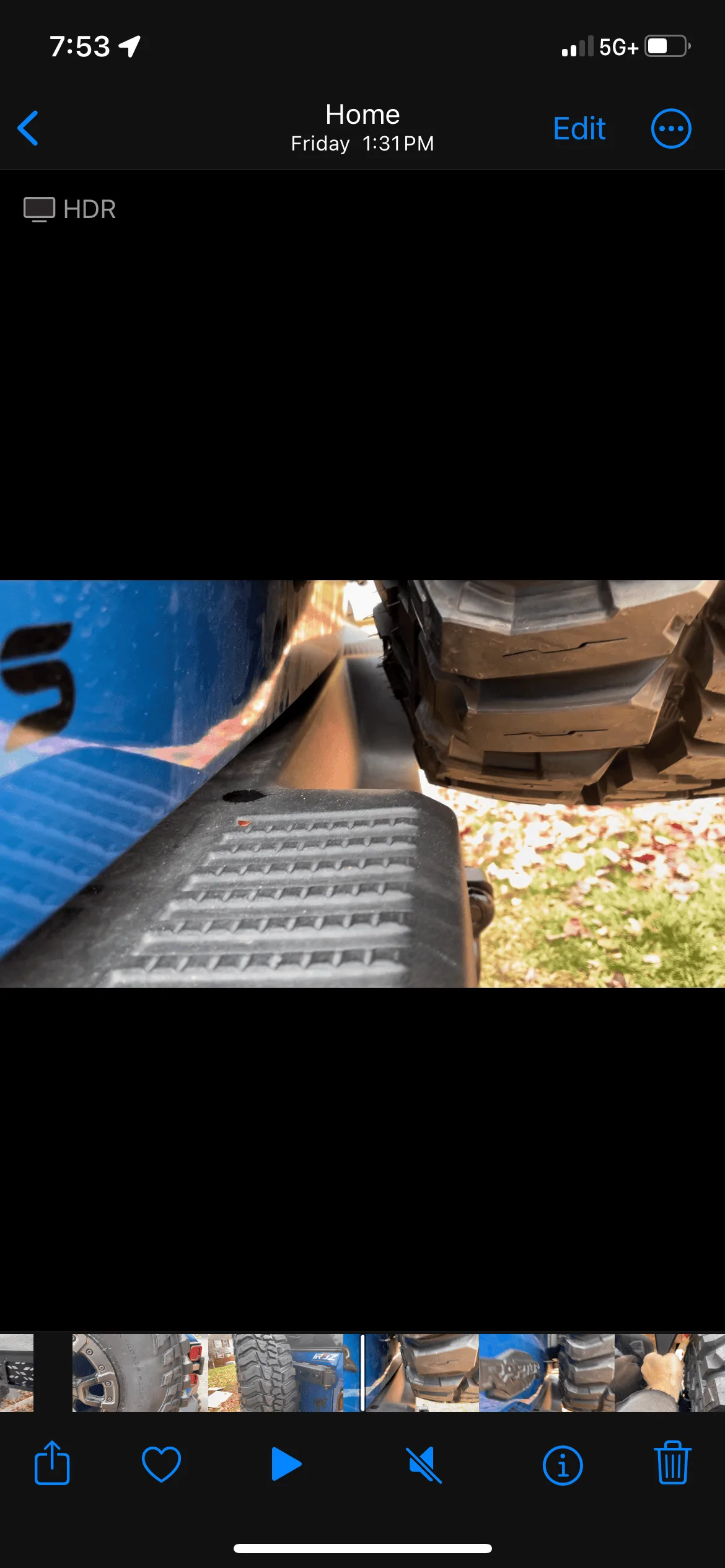

Turn also has these nice brackets to support the 3rd brake light
Even fits my 40’s on the smallest setting
this would help those with tire rack storage I’m sure as well
Great products in my opinion 👍
