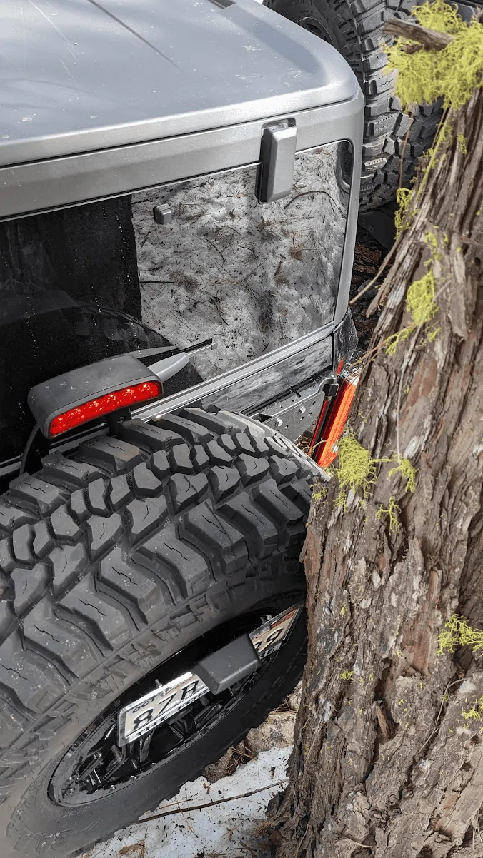

I love my RTR that replaces the hinges as well. Super stout for my 37's and I did the accessory mount for a gas can too. Really pleased with it all.

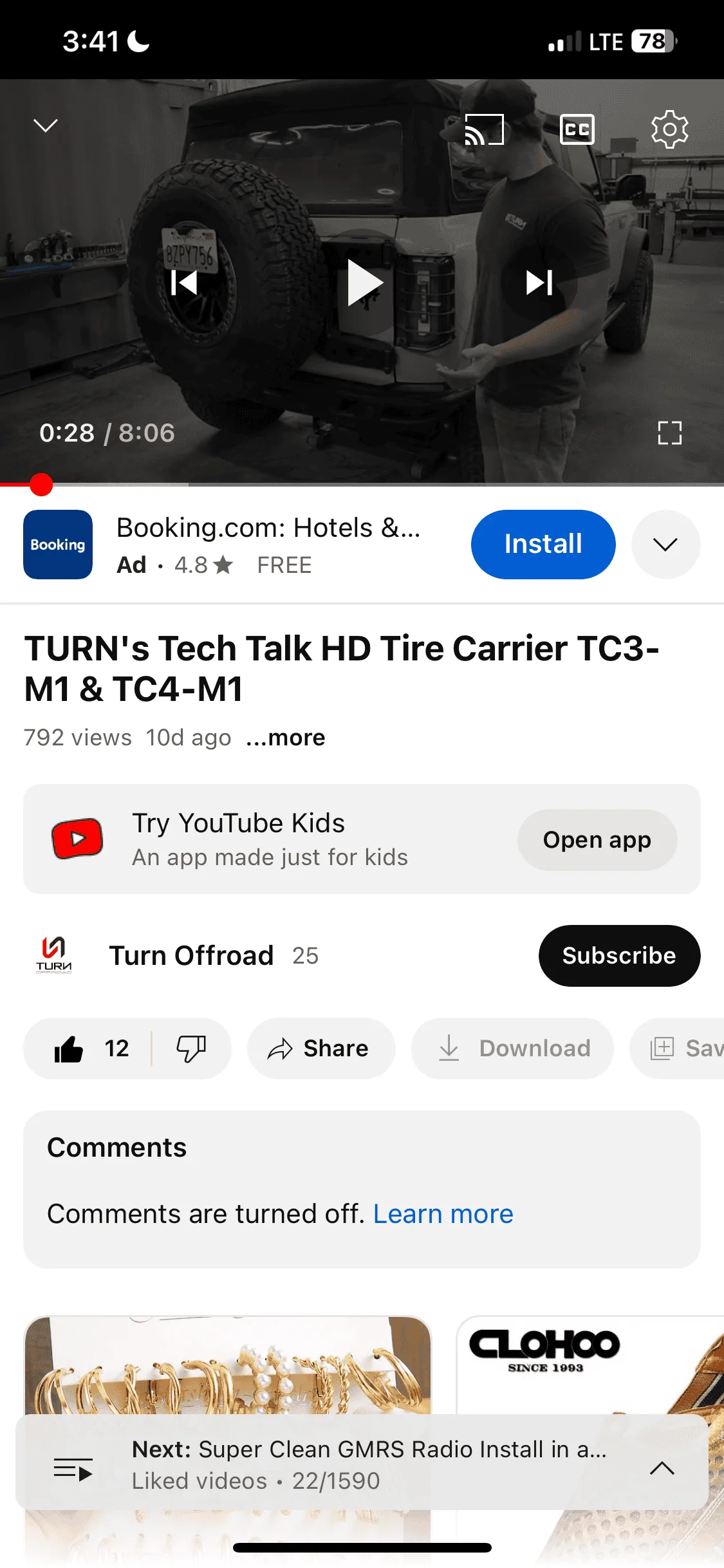

The tire carrier does bolt through one side of the X-Brace. That’s all that is needed. I bet if you used bolts and nuts, and bolted the carrier to the Brace you could leave the tailgate off and the brace would still hold the weight of the tire/carrier assembly. The key is the hinges. That’s where only a few tailgate supports companies are replacing the hinges to a stronger hinge. RTR, IAG, TC3-M1 & TC4-M1 are a few that changes hinges. Cool video on TC3&TC4
Other companies that make a brace are just equalizing the weight from stock hinges to the carrier but does nothing to beef up the load on the hinges.
With IAG’s set up, the tailgate is taken out of the load equation and all weight is on the carrier-brace-and hinges. Tailgate is there to latch and lock

https://www.rtrvehicles.com/collections/bronco-rtr-parts/products/bronco-rtr-tire-carrier
https://www.rtrvehicles.com/collect...rry-can-mount-21-bronco-w-rtr-accessory-plate
https://www.rtrvehicles.com/collections/bronco-rtr-parts/products/bronco-rtr-accessory-plate
I don’t love the tailgate stop they offer and had to have one warrantied for bending in on itself so I didn’t include that link.
Also the Jerry can they offer is also available on Amazon and elsewhere and wasn’t in stock when I ordered the rest from them.
Pretty stout system and I love the look and strength of it.
