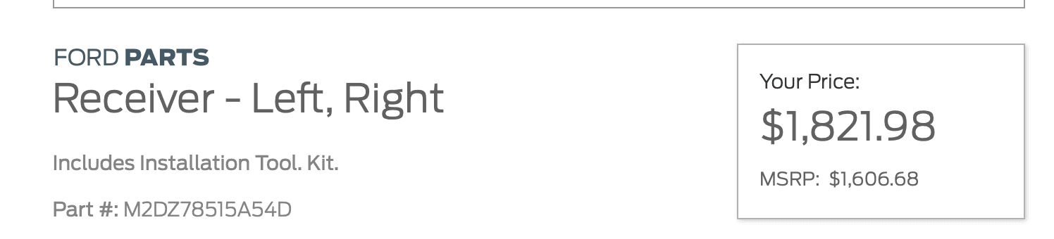

Soft Top tailgate Receiver $1800 for a bracket ?!

The mountains2metal product saved me $600+. That price is a scam. They are plastic with metal at the hit point. sure to wear out or break. the M2M product is solid stainless. Fit exactly the same. Easy to adjust. came with stainless bolts. Highly recommended.

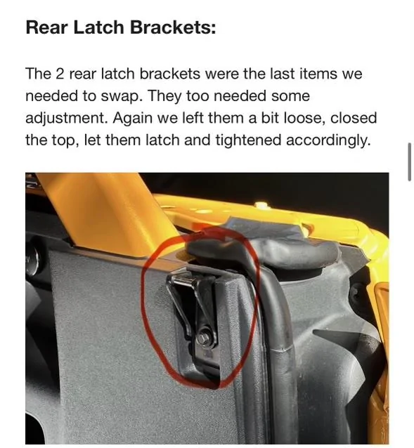

7) install M2M receivers (catch set) and close the back
