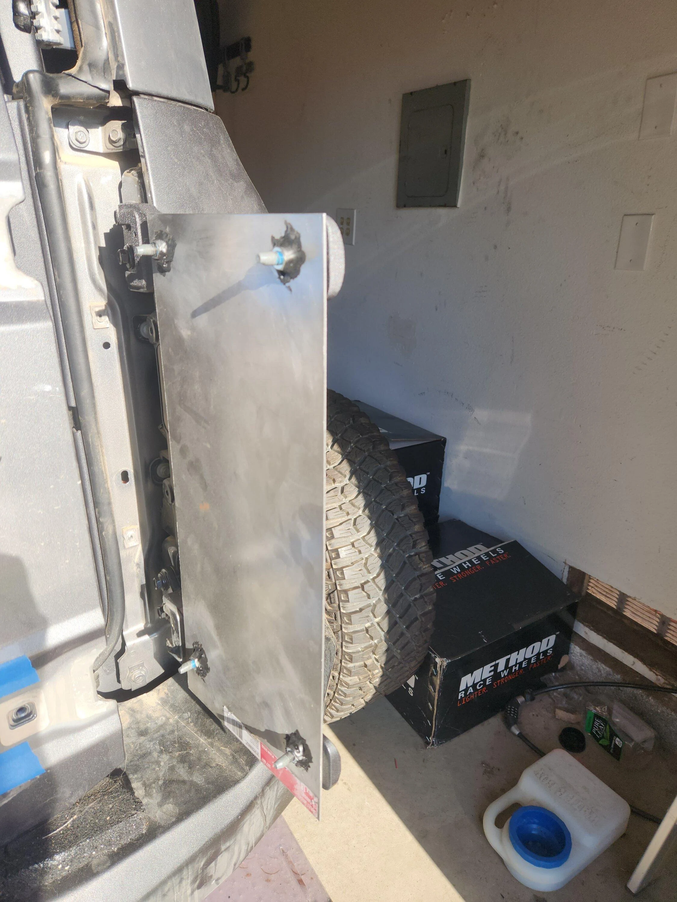

I was told one can use a magnet on the end of a semi rigid line (like thick weed eater line) and fish the plate into approximate place that way...the tailgate is aluminum so the magnet should pick up the plate without sticking to the sides.
Ok I'll try it out thanks

So, can you change one hinge at a time? For swapping to raptor hinges ??
That is what I recommend...and using an alignment plate (I used a piece of sheet metal and nuts epoxied onto the back). I used wedges under and on the sides of the gate and took pictures for reference, then unbolted the gate and moved it off to the side, then swung the hinges out to make my alignment plate, then unbolted the top, mounted the Raptor hinge, then repeated.
