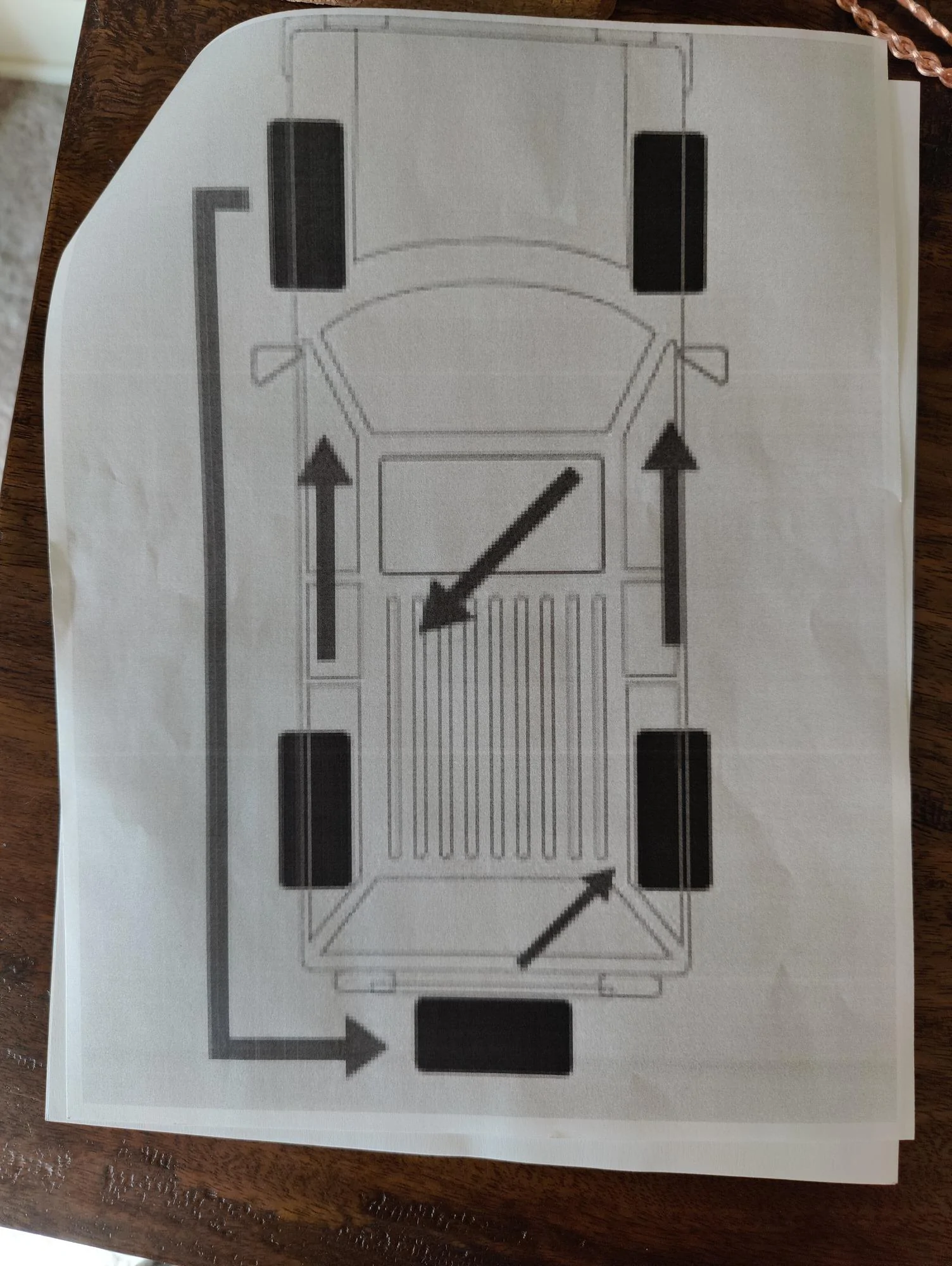

The owner's manual for the 2021 Bronco only has a diagram for a 4-tire rotation. For five tires, you swap the spare with what would have gone on the right rear.

I've taken my truck in for service every 5,000 miles. I say "truck" because I've been doing this on my 2001 F-150 to the Pierre Ford Service Center since around 2002, and now I take my Bronco in to the same place and hand it over to Greg every 5,000 miles. I've got the service agreement, so it's all pre-paid. That may have been a tactical error on my part, as now that I'm retired, I barely get 5,000 miles per year on the Bronco. Going in for the 15,000 mile service on Tuesday. First time I took in the Bronco they did "the usual" 4-tire rotation, and I complained, but said "Oh well," and swapped the right rear with the spare myself. Used the scissor jack that came with the Bronco, figuring it would be good practice for an actual roadside use. For the 10,000 mile service Greg said that I'd be getting the full-on 5-tire rotation, and that's what they did.
Guess what? I cannot find a 5-tire rotation diagram in my Bronco Owner's Manual!
I just saved the "correct" rotation diagram on my 'puter, and printed it out to take in on Tuesday.

I confess rotate (5 tire, every 5k when I change oil) in a clockwise circle looking down (so spare ends up on driver rear, that ends up on driver front, etc.).
