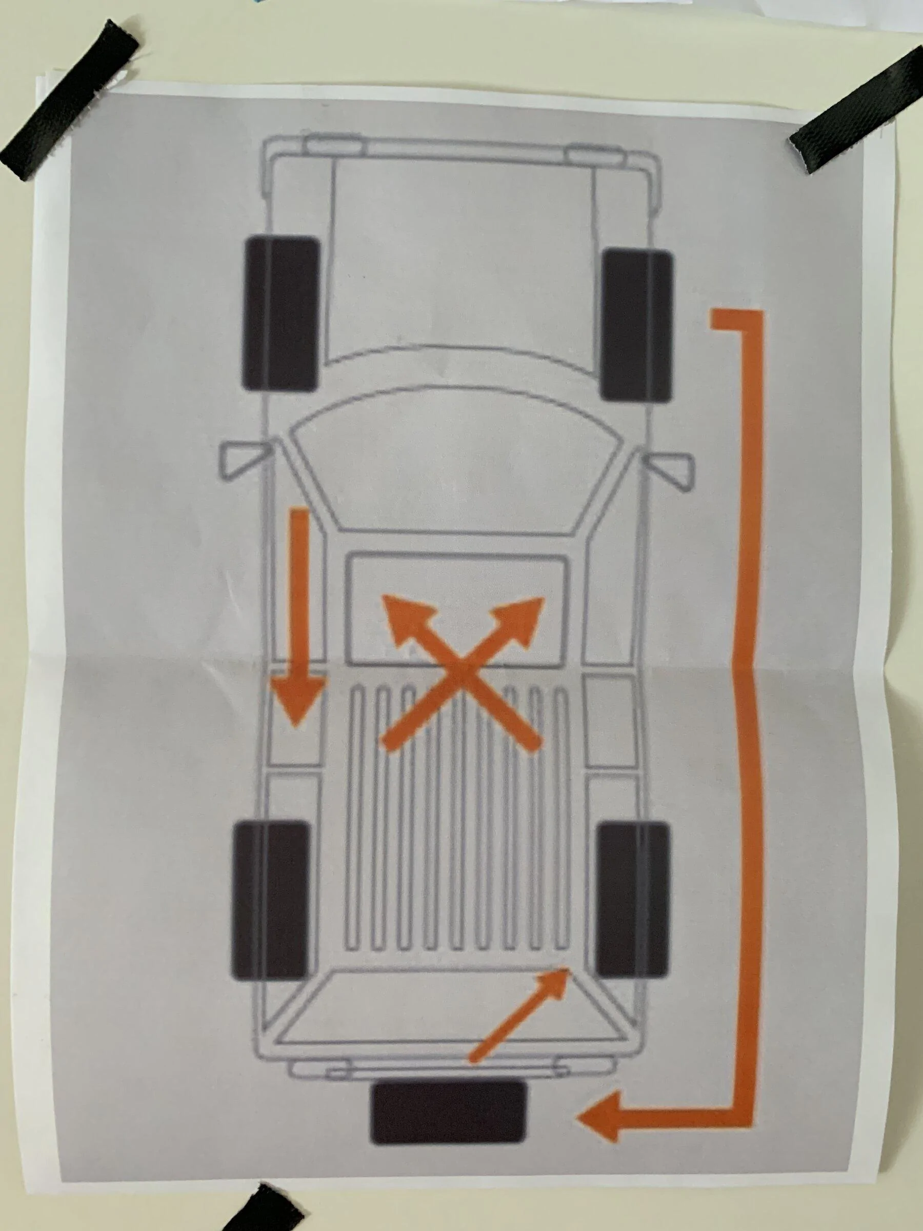

I keep this taped to the inside my my garage cabinets. Lots of different “correct ways” it seams, just pick one and be consistent.
