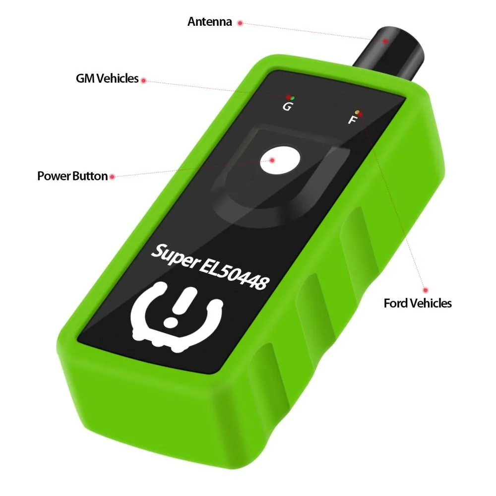

I originally planned to do a 5 wheel rotation myself. Now that I have my bronco, I noticed there are no wheel weights on the spare leading me to believe that it either balanced perfectly(not likely) or it may not have been balanced at all from the factory. Has anyone else noticed no weights on their spare?
I am also reading mixed answers on if TPMS will auto learn after rotating the spare in, or if a dealer visit would be required to reprogram when the spare is rotated in. Does anyone have an answer on this?
Doesn’t re-learn on its own. Inexpensive TPMS tools are available.
Ford Bronco Best Practice 5 Tire Rotation? 33387159-b3bc-4717-b6a6-f7c32c168ee2-jpeg
https://www.amazon.com/gp/aw/d/B076KL82JP?psc=1&ref=ppx_pop_mob_b_asin_title
