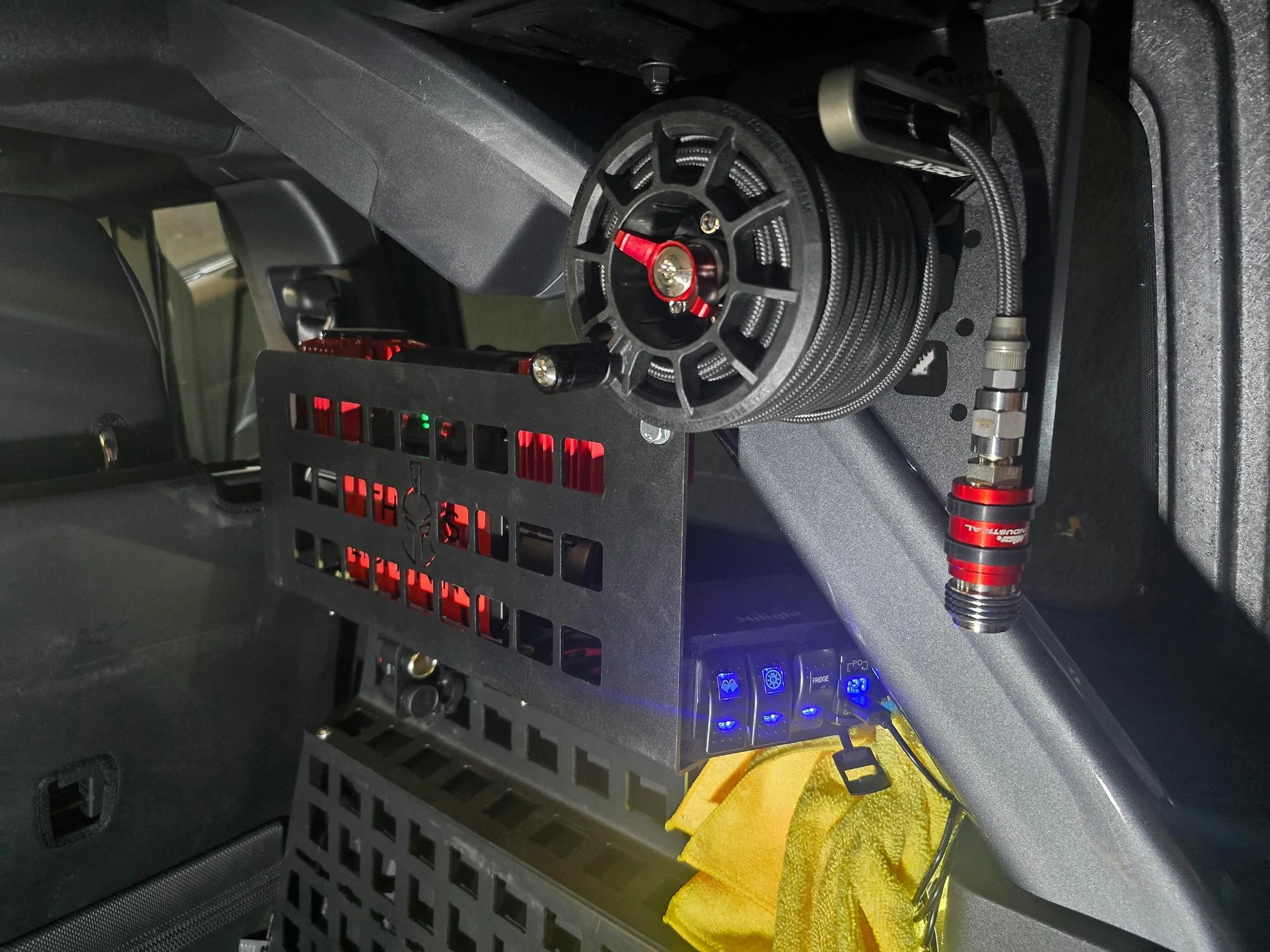

I mounted my Thor's system using their molle mount. Hardwired with a relay and switch. Plumbed to a CRS mini hose reel. Works awesome, single hose or the 4 tire system.

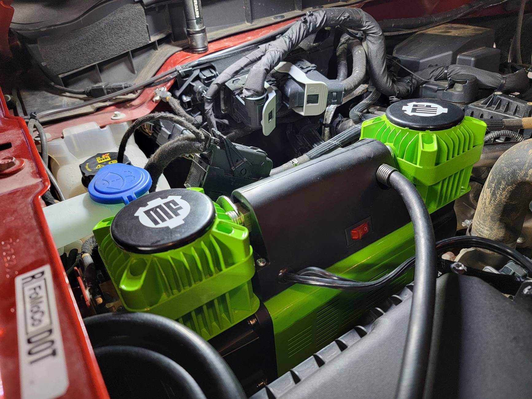

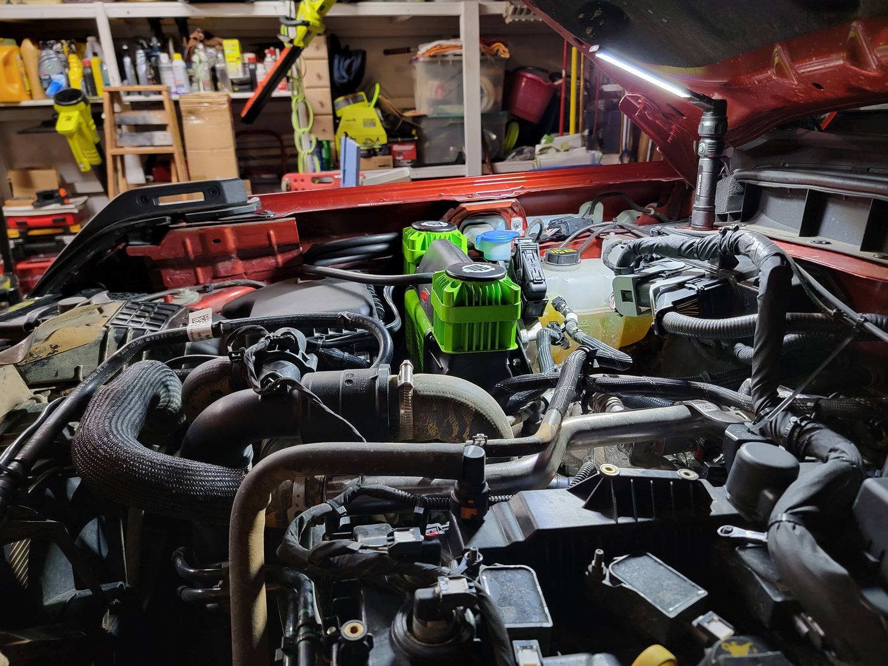

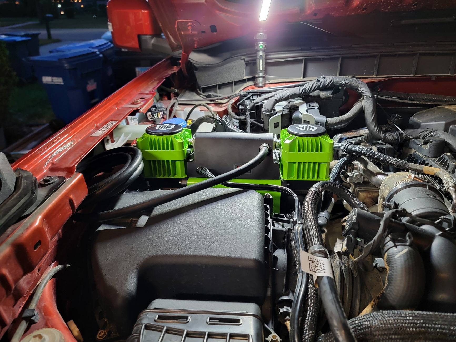

That’s pretty cool. How did you get th
I did this set up from TD MARZ.
How did you get that to mount? Seeing as how it’s a portable compressor how do you wire the power?
Winds of Change
Feb 6, 2023
171
123
Chicagoland
2022 Bronco Obx SaS/2021 Bronco sport Badlands
For now the cable reaches the battery and clamps on the OE way. I just rolled it up when not in use. Same with the short air line. At some point I may cut off the clamps and make a direct connection.The mount Is from a guy that I posted a link that now I can not find. I'll keep looking. Here it is sorry I kept thinking TD instead of JD Marz https://broncoaccessoriesusa.com/pages/about-us
