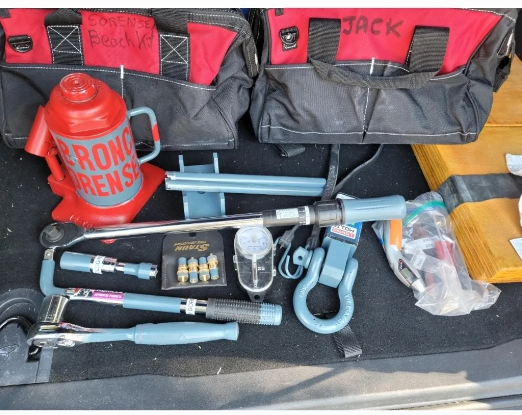

Makes life easy, storage & use, wife or not! It's all in the bag! (I also have a jack bag and a tow/extraction bag!)

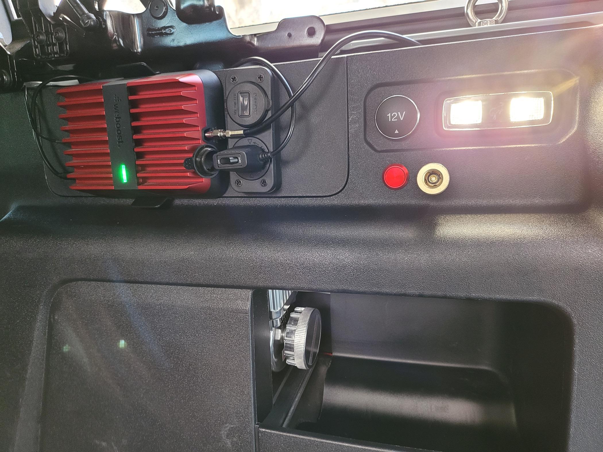

It should be noted that the viair in the video is in need of a tune up/rebuild. Also, it looks like it's missing an air filter, running that from the ground will definitely cause an issue.
I have the Viair 400p that I use with my DIY 4 way hose and it takes about 13 mins to inflate all four 35" toyo rt Trail.
