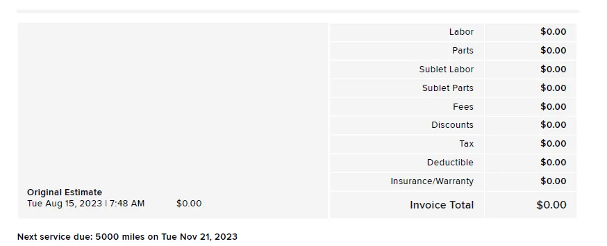

Well, I got our Bronco back from the dealership. When I asked the service manager about what caused the self destruction, they said they had no idea. They also said they could not determine if it was or was not put into neutral tow correctly. So, for everyone else out there, it doesn't appear to be an easy determination. For me, they replaced transfercase and transmission. I no longer own the Bronco, as flat towing is a requirement for me.

Consider yourself lucky if Ford covered it. Hopefully they see the writing on the wall and a class action is coming their way if this continues.
Very lucky. I was resigned to paying for it. Their coverage blunted the loss in trading in a three month old vehicle. It was painful, but not that painful.
