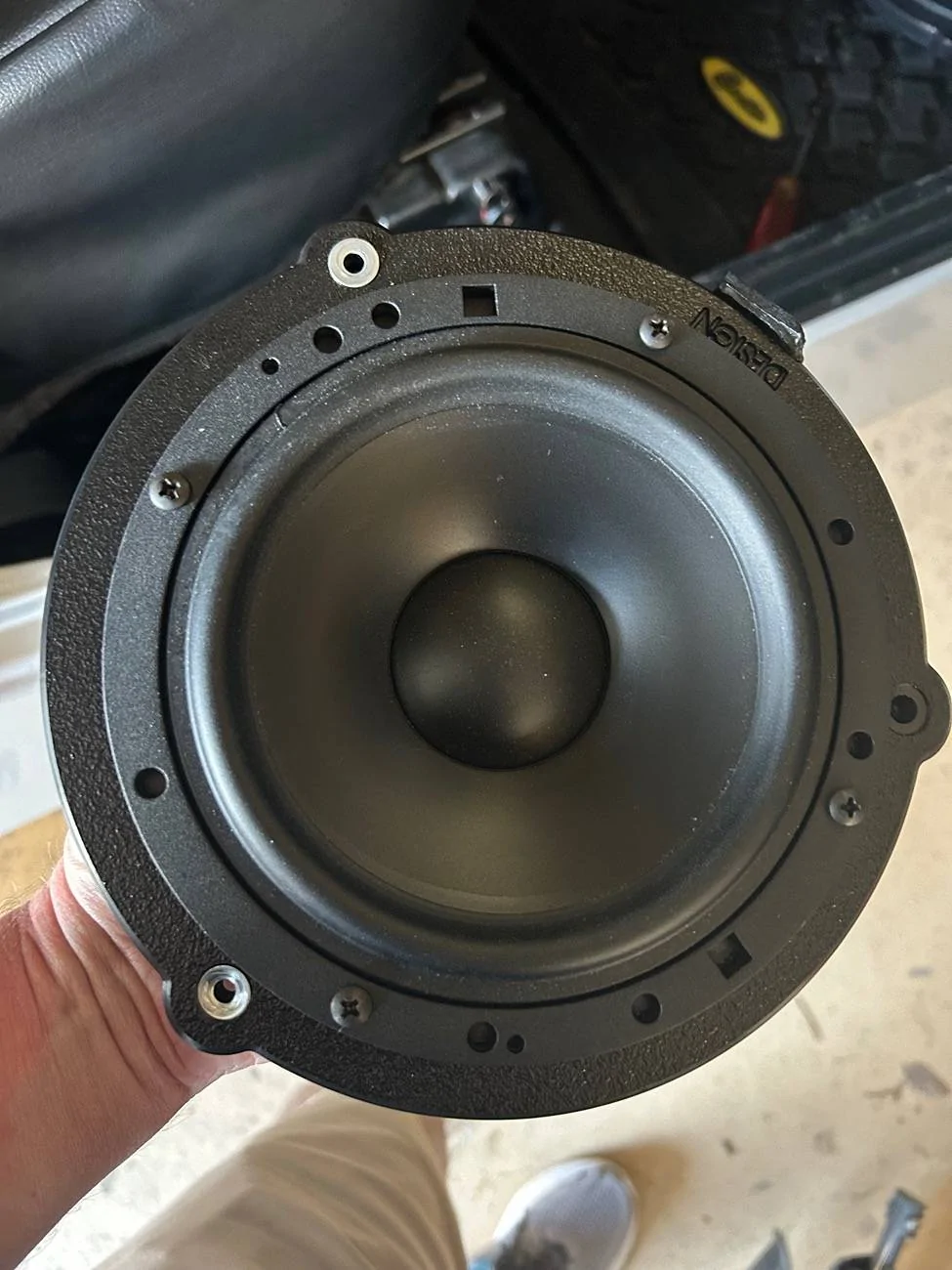

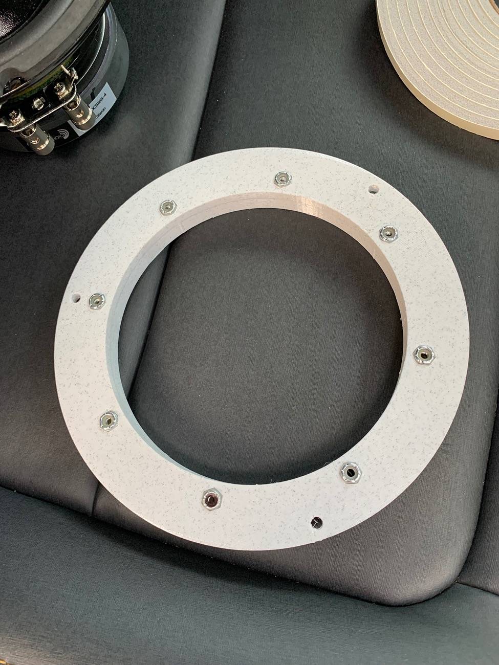

Pics of the Sounds Good Stereo adapters I used. Really good quality
Ford Bronco Midbass from kickpanel speakers IMG_0402
Ford Bronco Midbass from kickpanel speakers IMG_0403

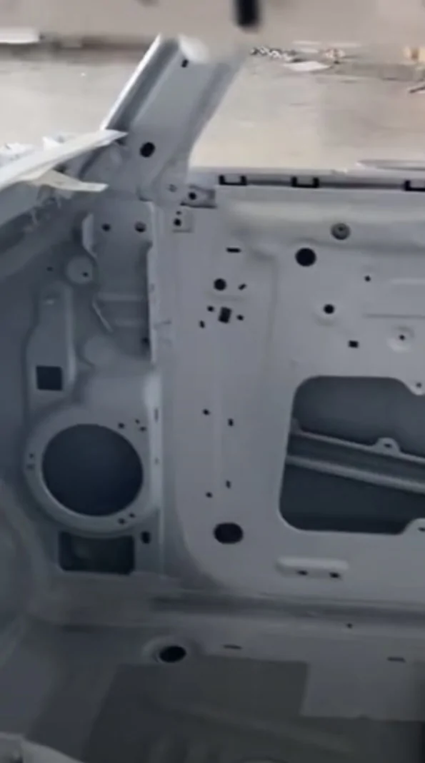

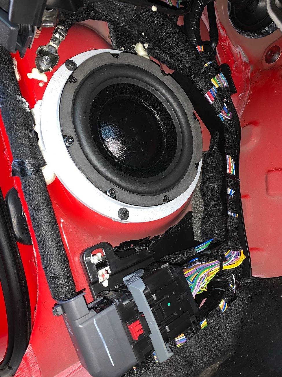

Late to the conversation but wanted to share my experience for what it's worth. Main issue has to do with airspace in the kick panel of the bronco as to why hard to get decent midbass. Car speakers are predominantly designed to work in larger door cavity. FYI, attached photo of passenger side where you can see the openings but can still be sealed up somewhat.
In my quest I started to look at speaker TS parameters, in particular lowest Fs and QTS. I am no expert so those in the chime in on the technical, but in small air space a low QTS and Fs driver is an indicator of a speaker that will play lower frequency in small air space.
I guessed on the airspace in the kickpanel at approximately .2 cubic feet then started looking at drivers and found the following at Madisound and with their help identified the following:
SB Acoustics SB17MFC-4 will play down to 85Hz in .2 cubic feet
Morel CAW634 3db down at 80Hz
Satori MW16P-4 or MW16TX-4
Scan-speak 18W/4531G00 3db down at 80Hz
Scan-speak 18WU/4741T00 3db down at 85Hz
Sealed up what I could, purchased the SB17MFC-4 for testing. Made some adapters tuned with dsp, band passed frequency to 80-400Hz and what do you know, magic.... midbass out of the bronco. Happy with the results and knowing I was heading in the right direction, moving on to upping the wattage (300 watts a side) to the kick panels so I stepped up to the Ciare HWG160-4 speakers. I am after SQ so I like headroom. If anyone is interested, I have the SB Acoustics SB17MFC speakers with custom adapters listed on ebay.

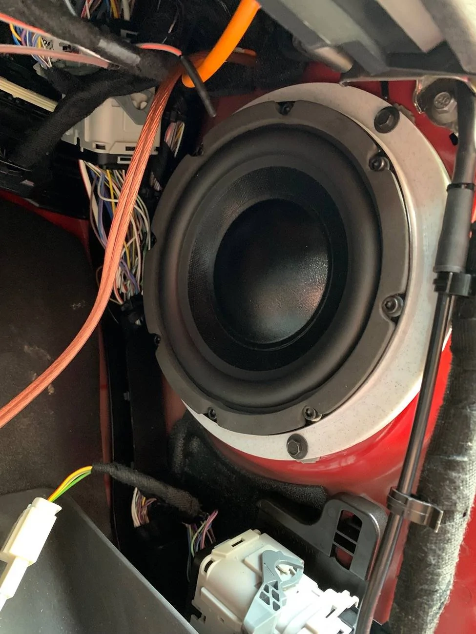

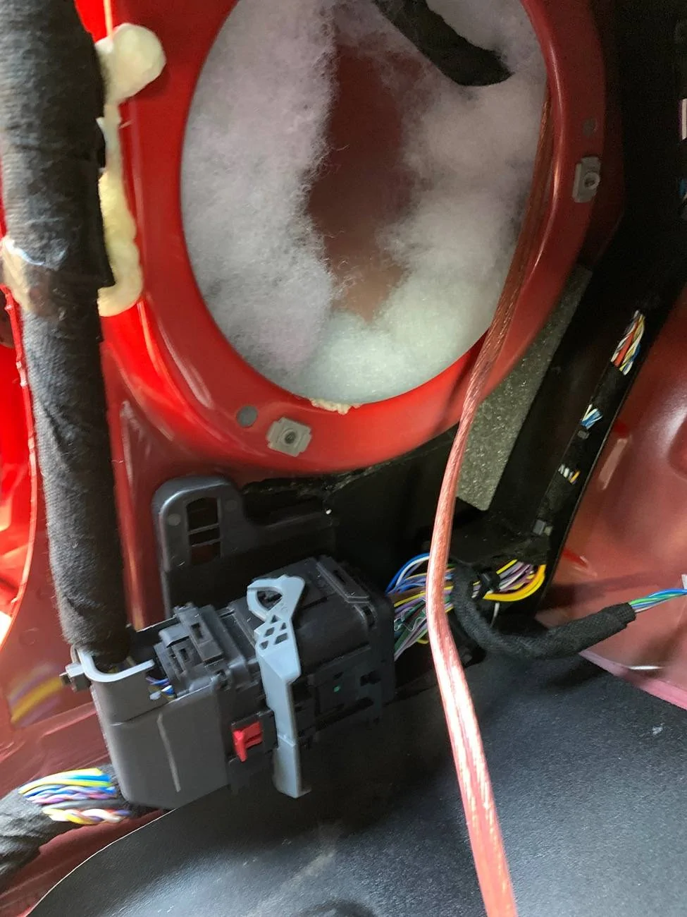

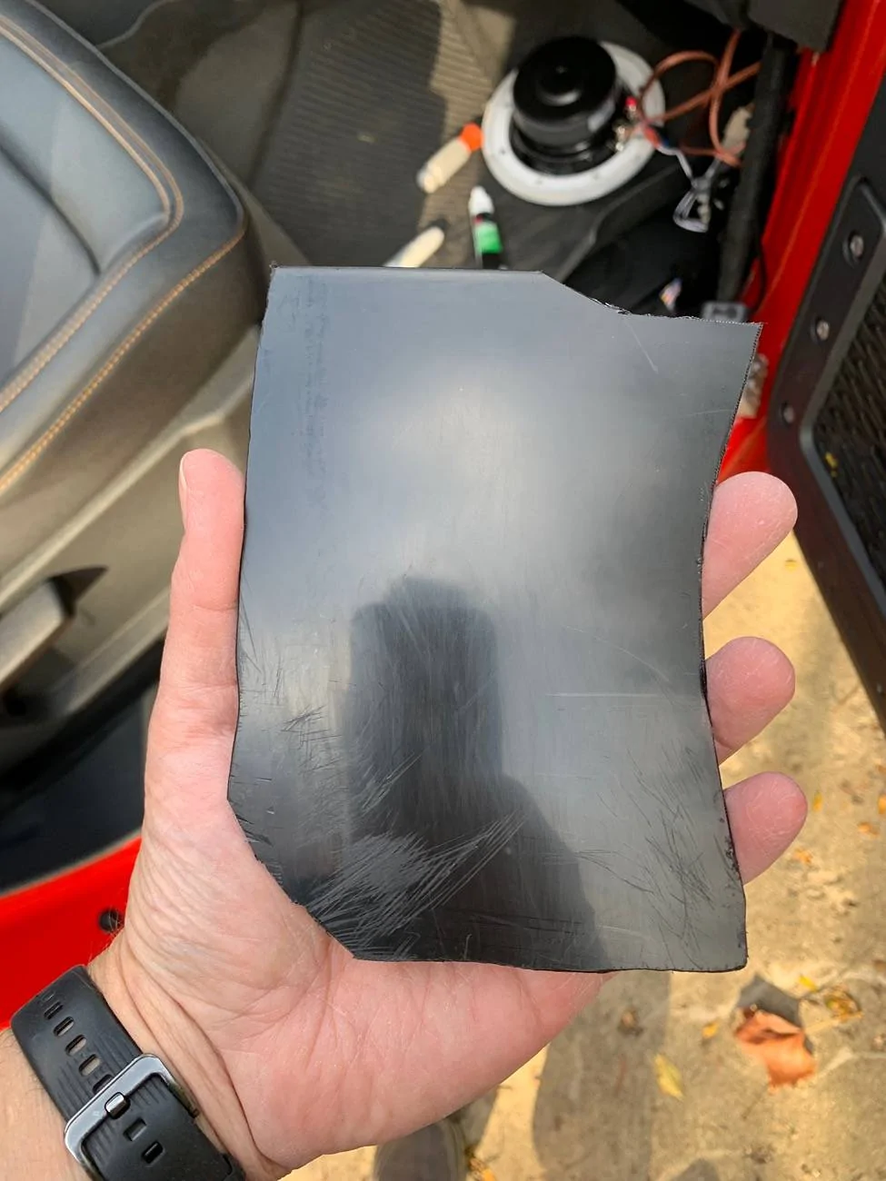

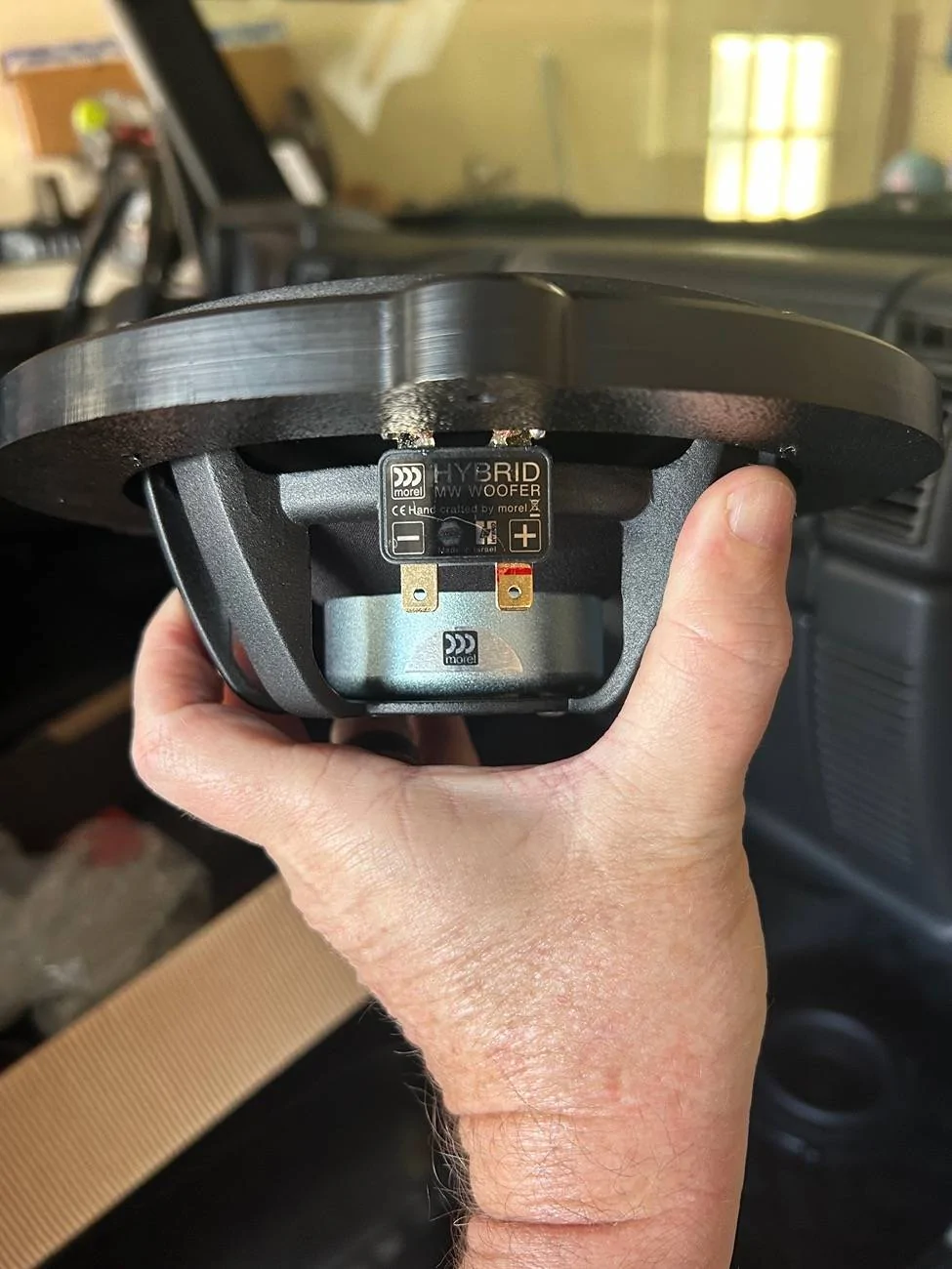

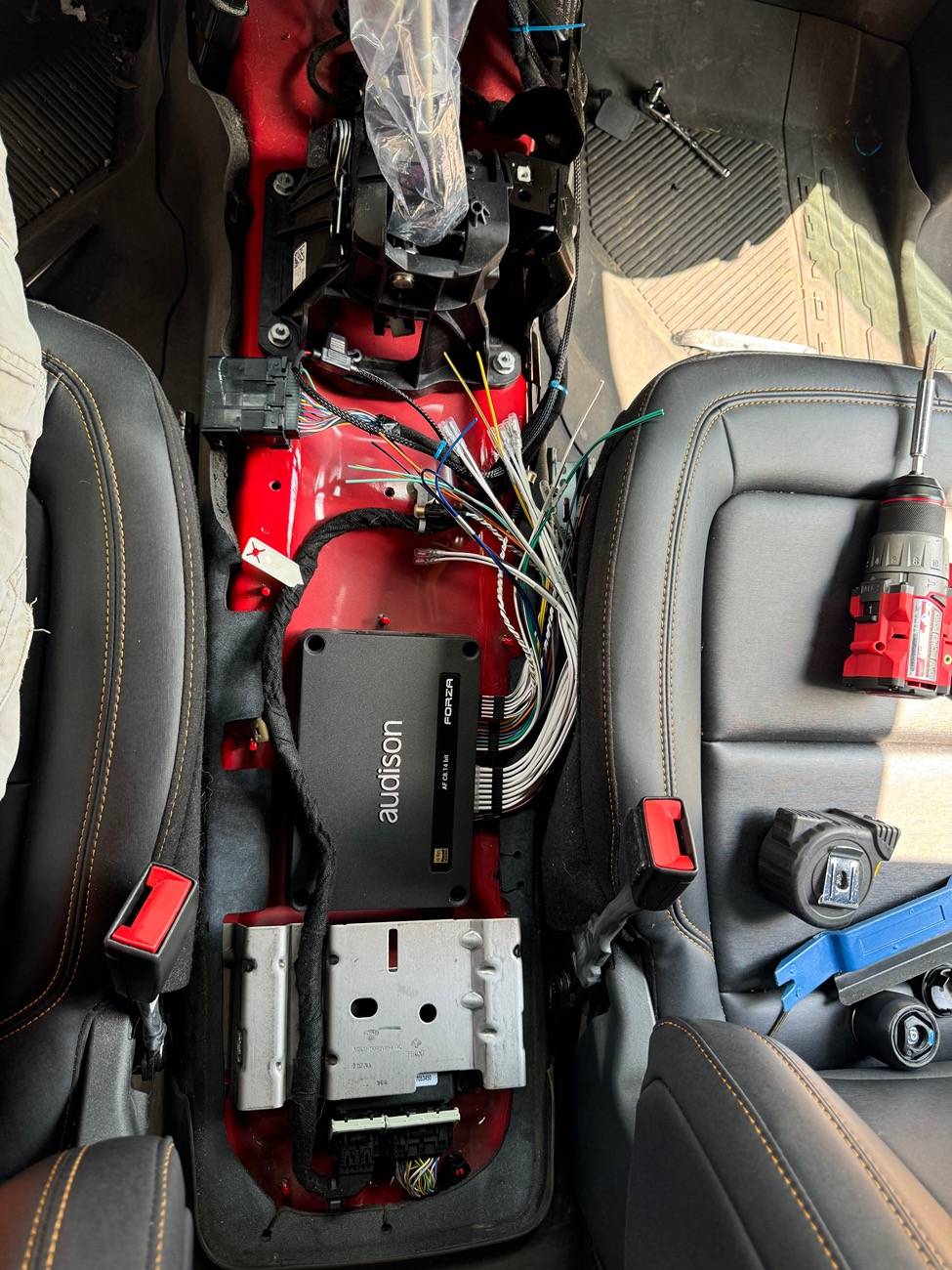

I don’t have a write up. However here’s some pictures of what I did.
what was the black rectangle of plastic used for?
Did you actually mount the amp underneath of the center console?
Do you have a link to the 3-D print file by chance?

The black plastic was used in place of the foam pieces that the factory puts in behind the big electrical connector. I glued them in trying to make it airtight. I also used spray foam to seal the area where the body clips pop in and where the foam is that allows wiring to pass thru up high under there.
The amp is located just in front of the center console more like where the cupholders are.
Unfortunately I do not have the link for the 3d model.

Are we talking Home Depot wall sealer foam or somethingSpecial?

I used the home Depot special. Just use it sparingly!

I went through this effort I cut plastic pieces to close the large hole and glued it in place. Then I 3D printed some adapter rings for dayton audio 6.5’s. Ran them to a kicker key mounted above the glove box. I used spray foam to seal up inside where the clips protrude into the cavity. I ran the speaker wire in from above where there is a foam seal and sprayed some expanding foam to seal that as well.
I measured this setup with REW and it gets down to about 55hz fairly decently. I ran that for over a year before I threw in a sub.
