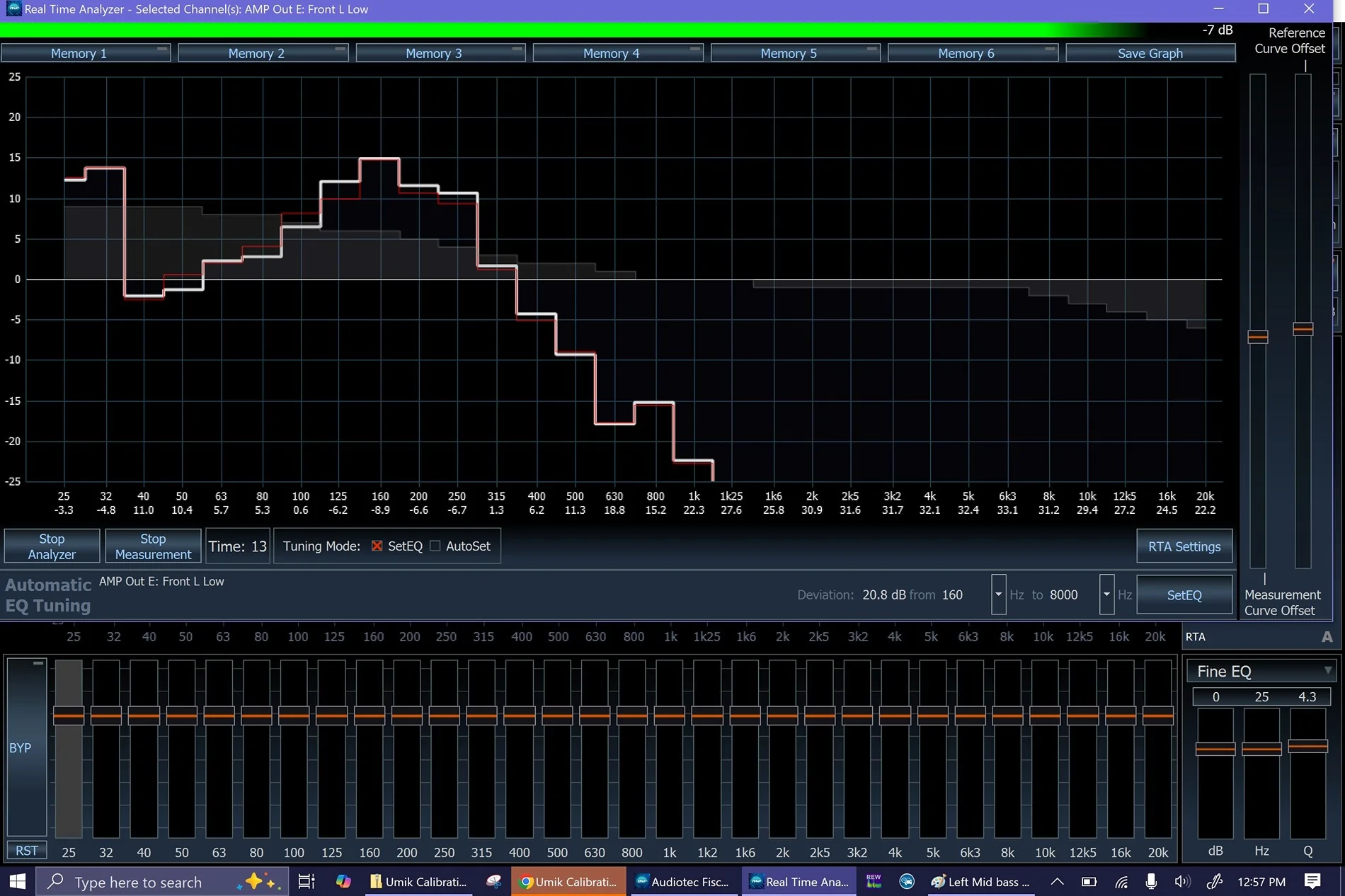

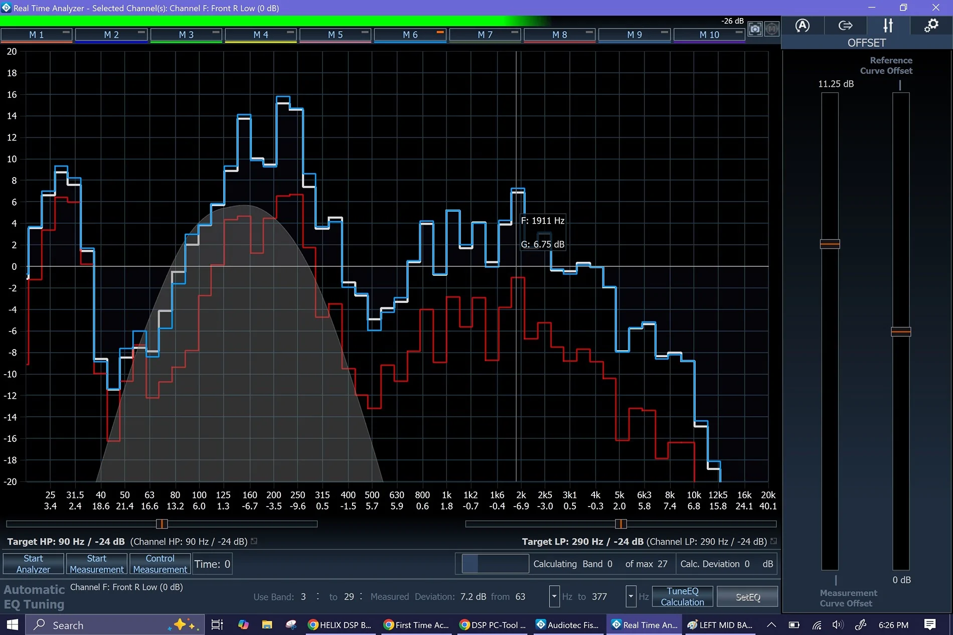

@heathw101 Attaching two RTA from my Helix before and after I added the Acoustic Putty that @akturbo recommended. I also change Speaker rings from Metra to the SoundGooodStereo ones and removed that dumb speaker baffle I had lying around. I did a rough tune and called it a day. Too much work to change crossover points and retune. Midbass are the Hertz MPK 165.3
Ford Bronco Midbass from kickpanel speakers RIGHT MIDBASS
Ford Bronco Midbass from kickpanel speakers Right midbass 12.11
I guess I will be working on my kicks. What putty are you using??
