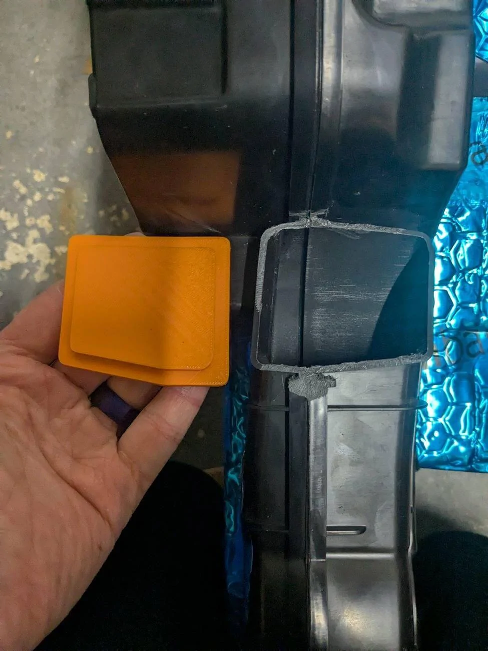

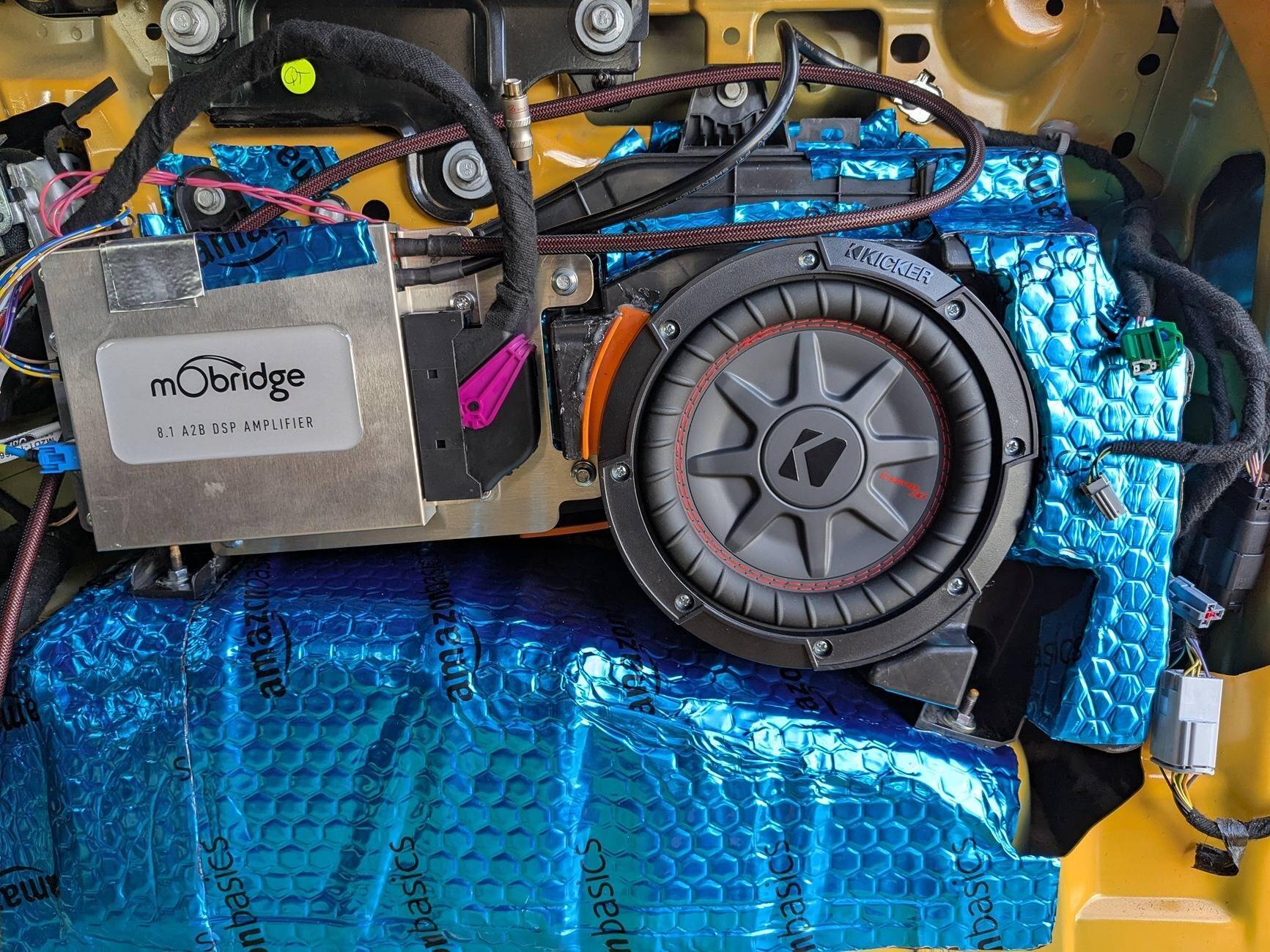

If you have a printer you can download a port blocker from Maker World.

Granted I'm running an amp, but the bass is tight and doesn't drop off at random frequencies. (measured the spectrum with a UMIK-1 microphone)
