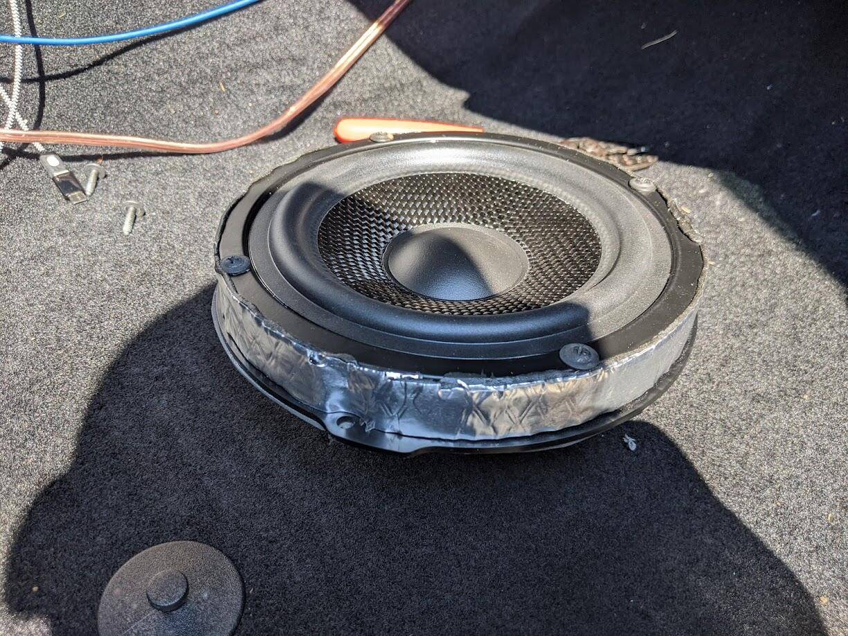

I used sound deadening also. Also used some to make sure to seal between the speaker and the mounting ring as well as using foam between the face of the speaker and the plastic kick panel to direct as much air into the cabin as I could.

I sealed up the hole at the bottom of the kick panel and it made a significant difference. I got about 3db more output on the lower end. The change added some impact I felt I was missing.
