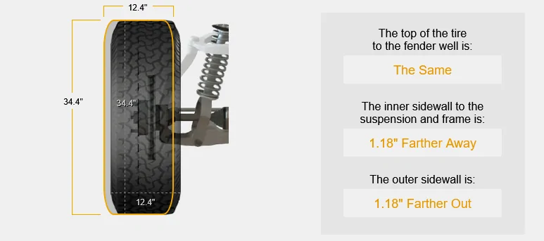

There will be no issue as far as rubbing is concerned. You'll just have more poke - about an inch.
Ford Bronco Method OFFSET??? 1762910453426-9x
