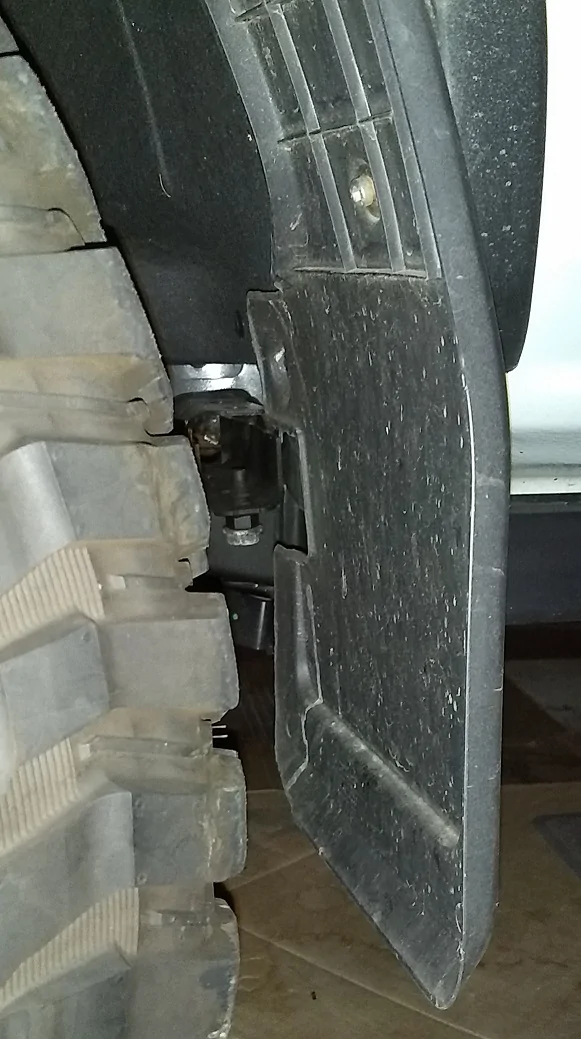

Did you need to do this? It is confusing to me that some people say that a 0 offset absolutely works with no issues, while others claim it rubs.
I could possibly understand why you might need to do this with this mud flaps given the large bracket, but wen still, it doesn't look like there was actually an interference issue.
It depends on the style of mud flap. Some of them have a raised edge for extra strength and that is where mine where hitting with true 35's.
Here is my truck with the mud flap ground down along the raised edge on the inside of the flap. It would still rub when backing up an incline with the wheel fully turned. My driveway is sloped so it happened a lot. The mud flaps that angle straight back will probably be fine, but this style that drops down will rub.

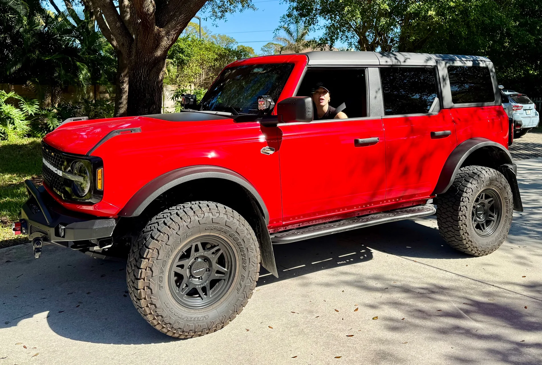

No clearance or rubbing issues running Method 706 w 0 offset and stock size 315/70 tires and RokBlokz flaps. I did have to remove the brackets from behind the fender liners as directed in the video.
Ford Bronco Method OFFSET??? IMG_7817
