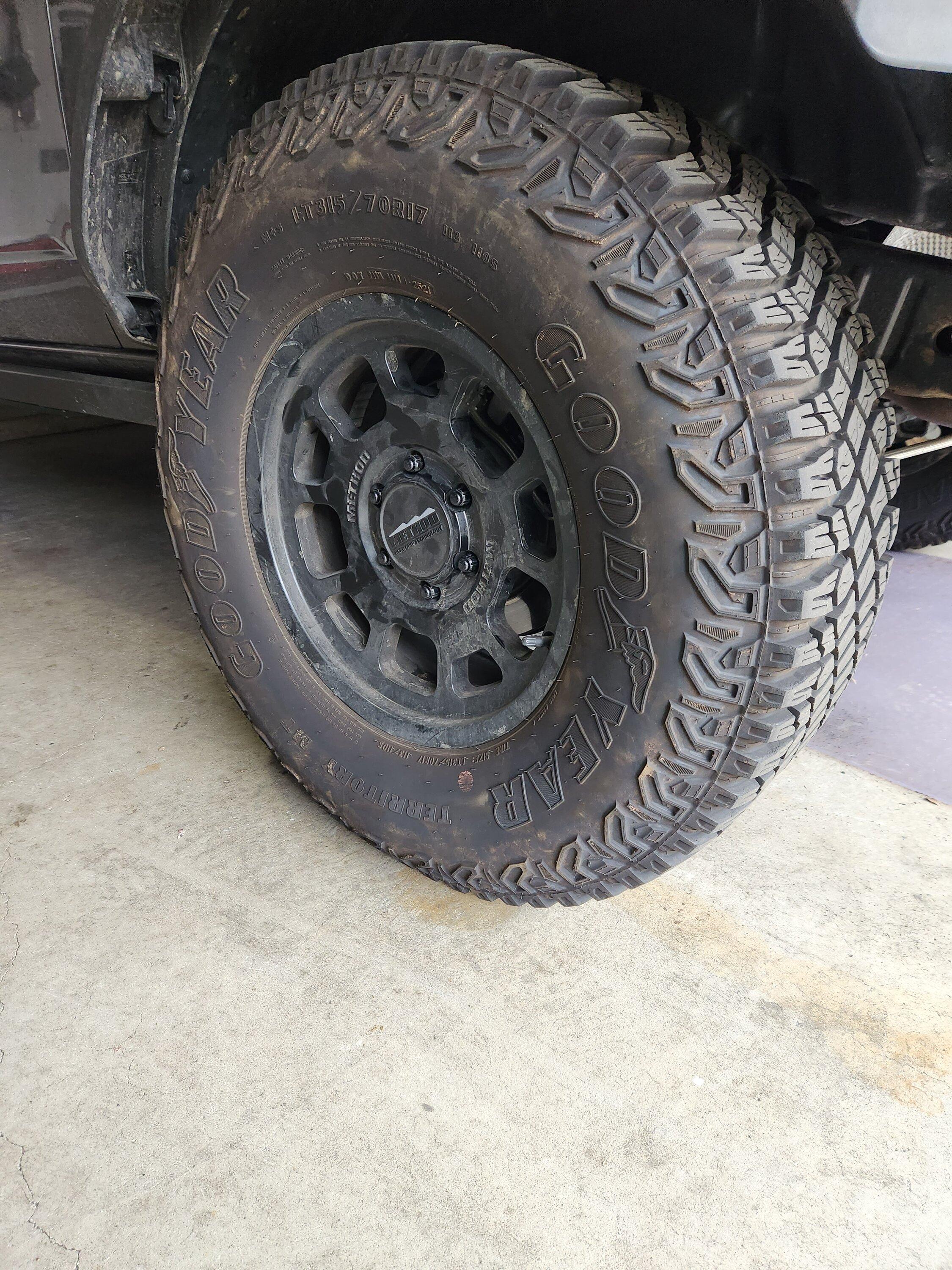

These are my Methods with a 35 offset...close to stock and they do not dish outwards at all.
Ford Bronco Replace Sasquatch with Method 703 Offset question. 16770247766293157731861272579794

There's a sizeable difference between zero offset and the 30 offset that the Sasquatch wheels come with...maybe not in appearance, but certainly in the impact it will have on steering geometry/wear and tear on parts. https://www.drivingline.com/articles/steering-you-straight-what-is-wheel-offset-and-scrub-radius/

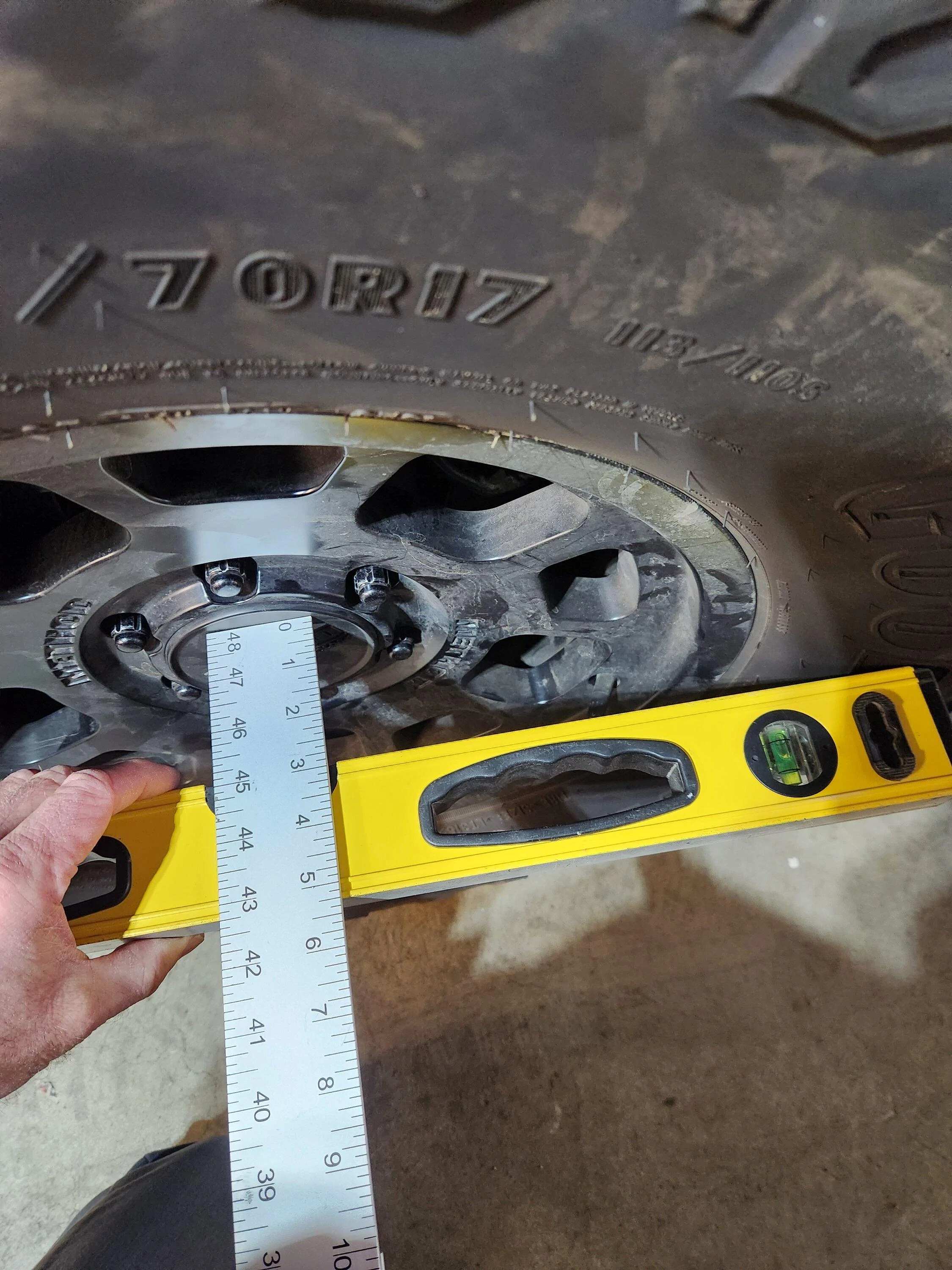

Correct, the 35s do not dish out. As I clearly said above the example was 90 and an extreme example.
Care to put a flat edge on your wheels to show how much or how little they dish?
I'm not concerned about wear or scrub radius or the like with a smidge more than 1in in difference. 1in is very little when talking about 12.5 inch wide tires.
I bet that article was more for people who put wheels on with crazy offsets.
When I got my methods my only choice was zero or 35... I bought the series I bought because I wanted to go with the bead grip technology so I could air down without heavy true beadlock wheels (in many cases which are only on the outside). With many Bronco folks going for the poke look, and lots of Bronco folks blowing up their steering boxes, I would wager that there is some correlation with not only much larger wheels but also pushing the wheels out farther because that absolutely changes steering geometry and stress on components. The scrub radius is easy to check just with return to center... And I'm happy on mine that with the 35 offset that the road manners are as I'd like them to be. Here is my offset...
Ford Bronco Replace Sasquatch with Method 703 Offset question. 20230221_162847
