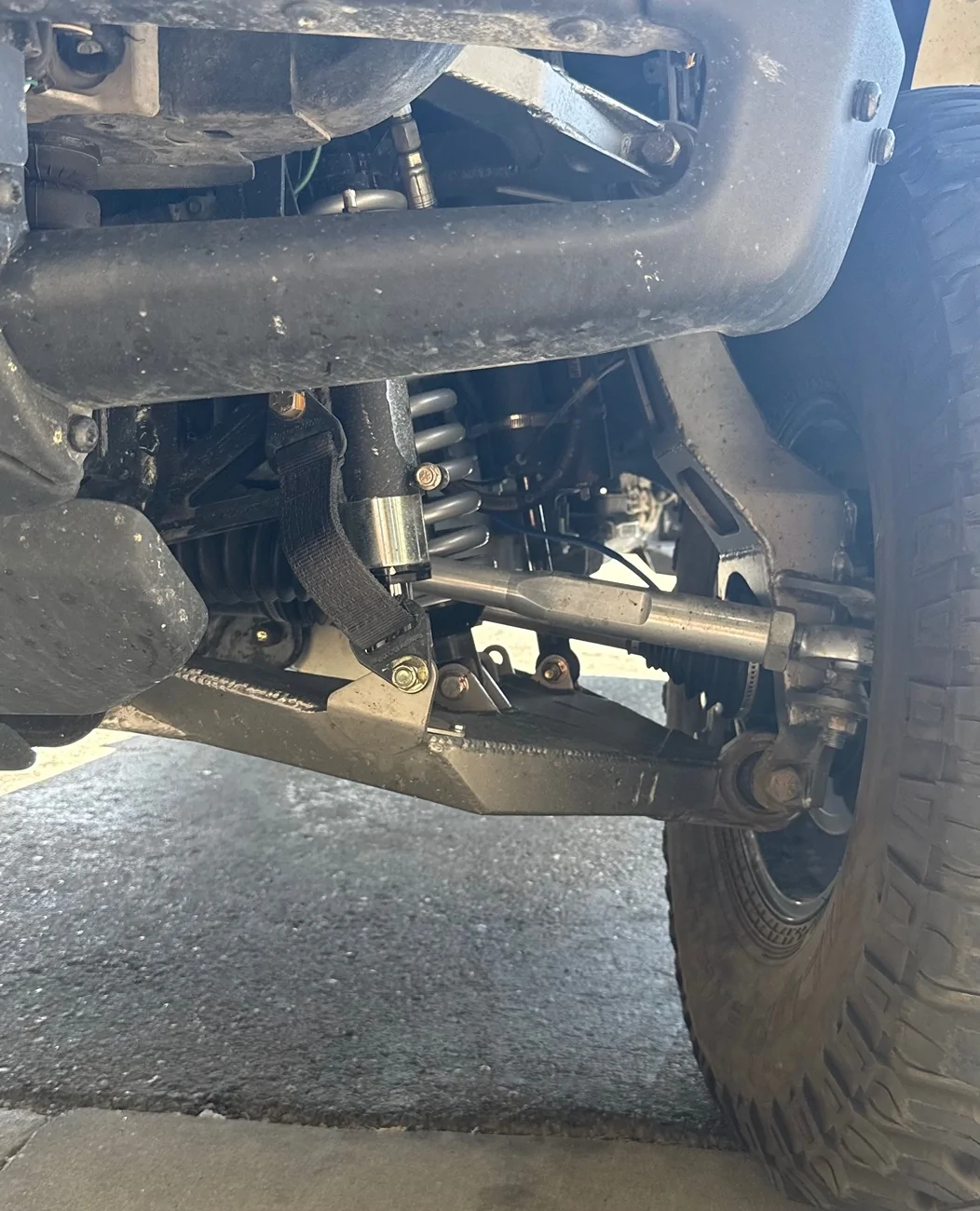

I gotta say, I'm not so sure this is 'as built by Ford,' since with 13k miles on it it's already got a new set of tires - those aren't factory tires on any model I'm aware of. If it's been lifted or any of the suspension has been worked on, without a cross-hole for a cotter key there's a good bet those were 'torque to yield' nuts, meaning they should have been replaced when it was taken apart.
I have a sneaking suspicion that what you encountered with that rig (presuming it's not yours) is someone who isn't telling the entire truth.

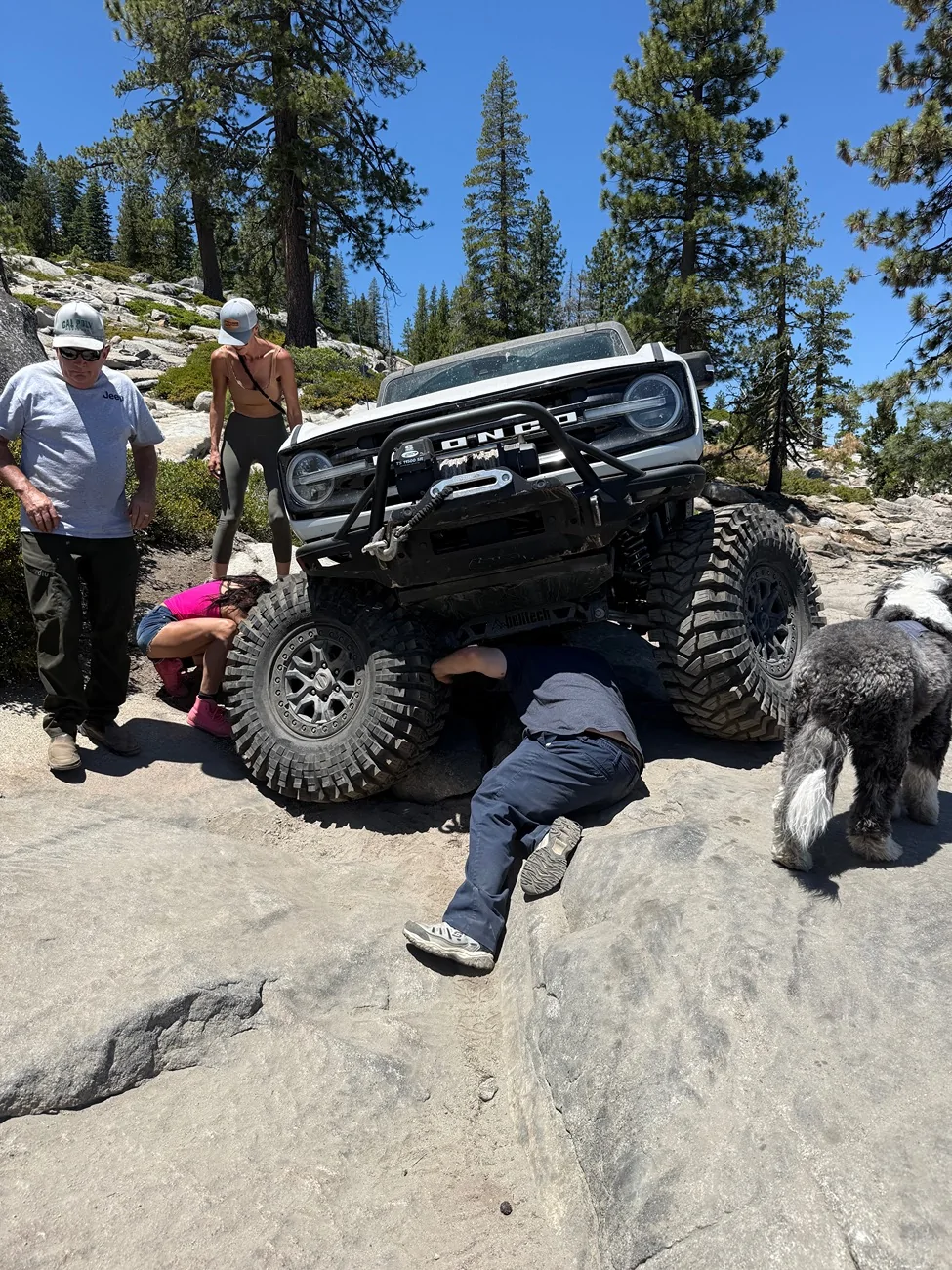

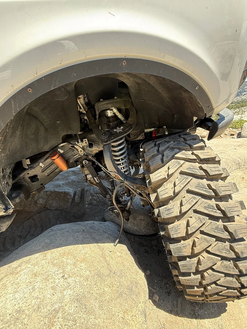

So far we’ve seen Ford balljoints outlast the LCA and tierod connection points on 74weld portals, and now the LCA connection on Belltech knuckles. (With Tibus portals)
Starting to feel pretty damn confident on how strong those factory ball joints and nuts are…

Well I’m not done, but I torqued all my bolts on driver side. The only loose nut was the lower ball joint!!
Swaybar, upper ball joint, tie rod, top hat bolts upper and lower shock bolts all tight to ford spec. Skids all tight and upper control arm bolts to spec. Only the dam lower ball joint was loose. I bet it had 75 pounds of torque or maybe less. From what I read it’s suppose to have 85ft pounds. I paint marked all the bolts. Gonna do passenger side in the morning.
