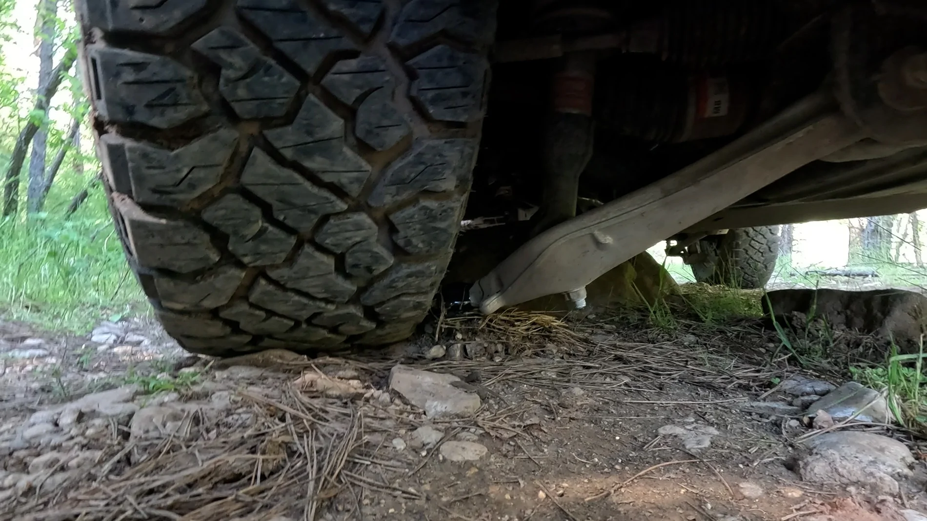

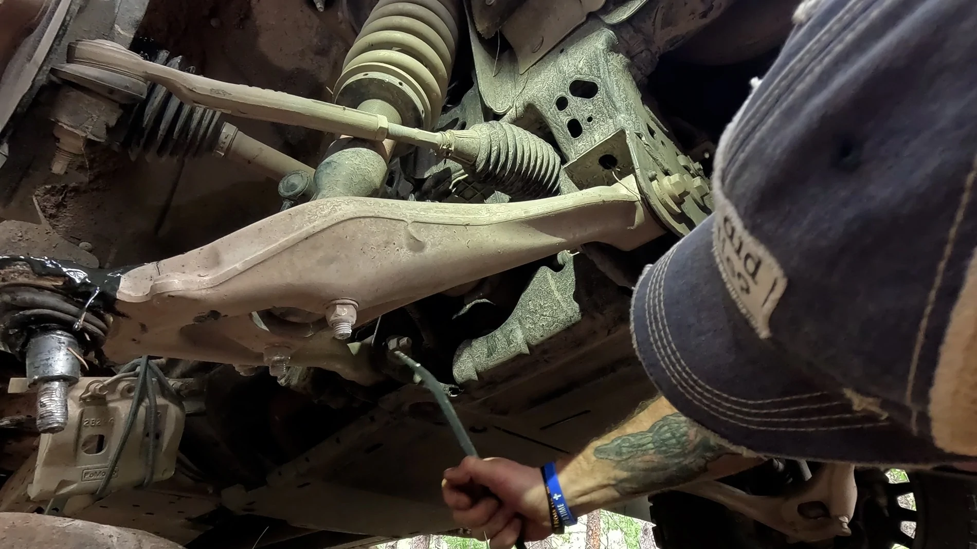

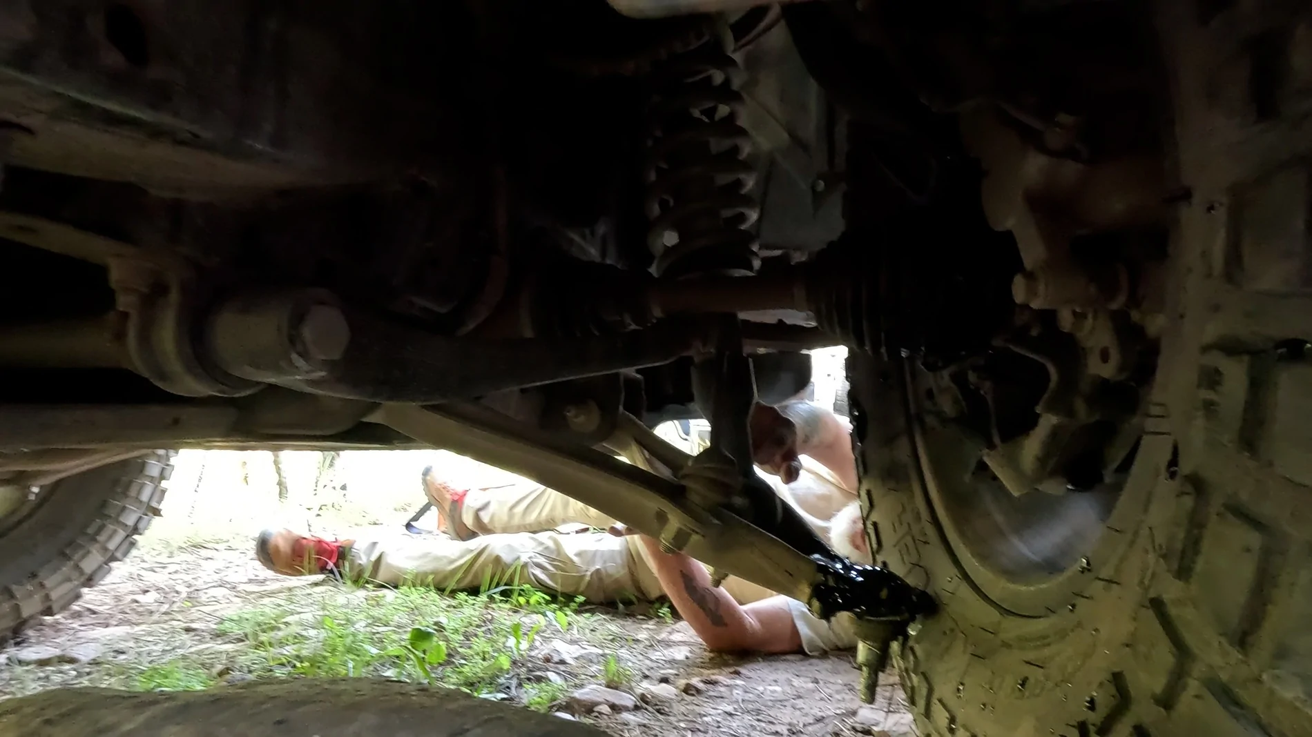

diagnosing what happened:
Ford Bronco Lower ball joint nuts missing or fell off?? main video.00_16_14_06.Still003
working on pulling the broken CV (broke at diff - pulled boot off at hub)
Ford Bronco Lower ball joint nuts missing or fell off?? main video.00_21_04_08.Still005

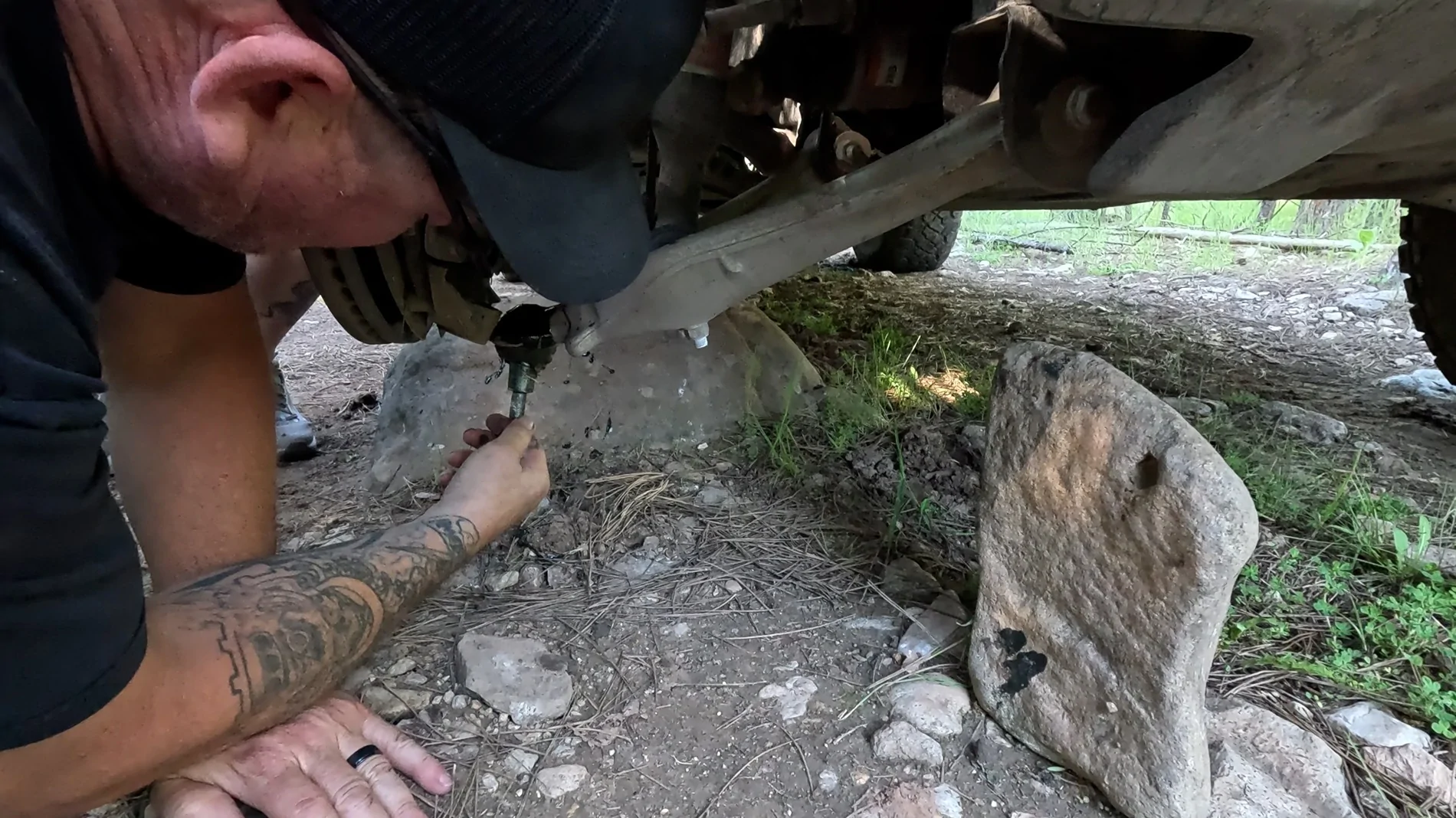

inspecting the smashed threads
Ford Bronco Lower ball joint nuts missing or fell off?? main video.00_17_43_21.Still004

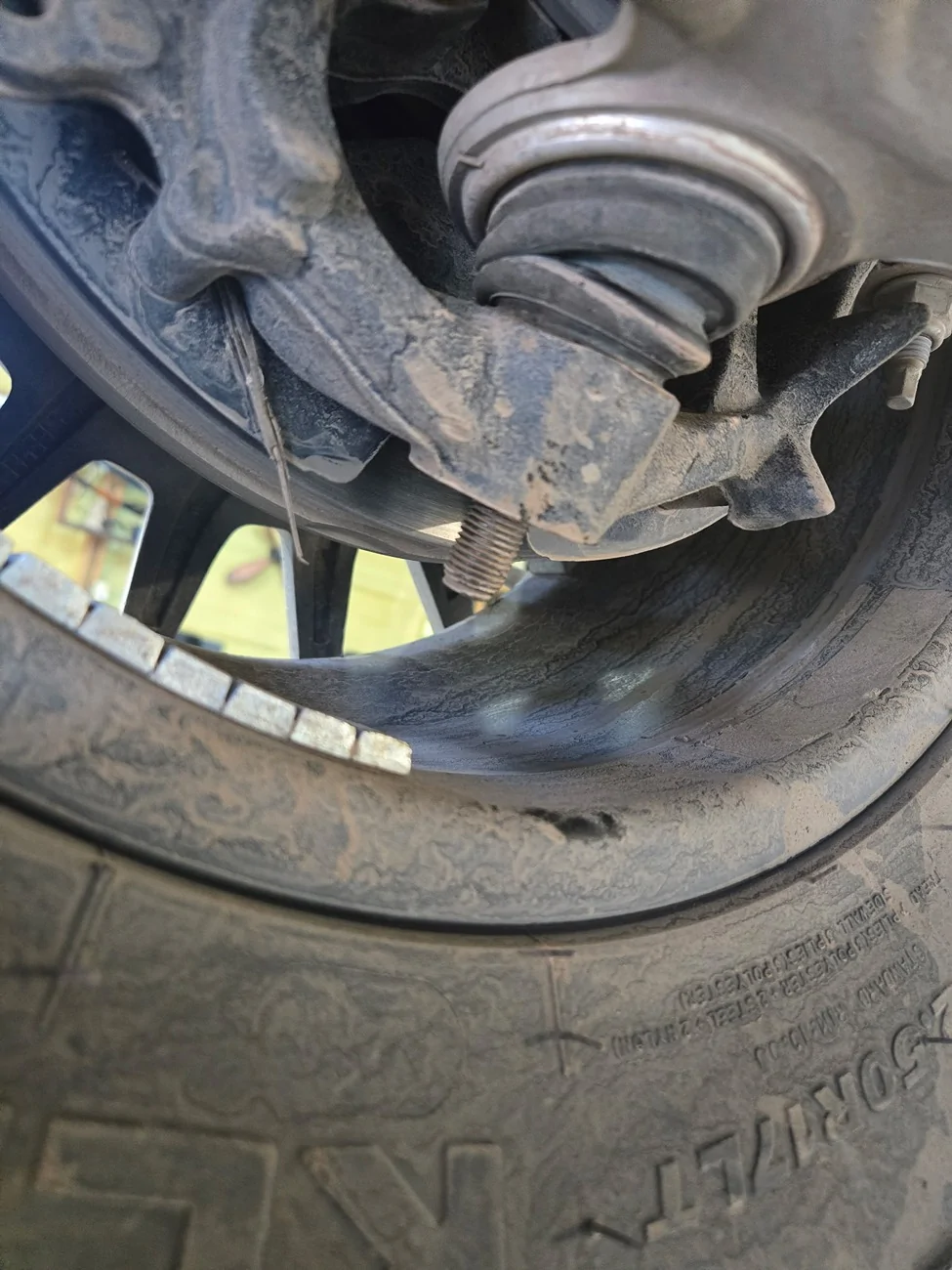

driver's side nut missing next morning during inspection. we had gone through numerous deep mud puddles so the threads were dirty, but the coloring of the threads makes it look like no nut was ever on this side.
Ford Bronco Lower ball joint nuts missing or fell off?? pic from dav
this pic was as we walked up to it "on the ground" per say. just uploaded in wrong order sorry.
Ford Bronco Lower ball joint nuts missing or fell off?? main video.00_15_35_03.Still002
