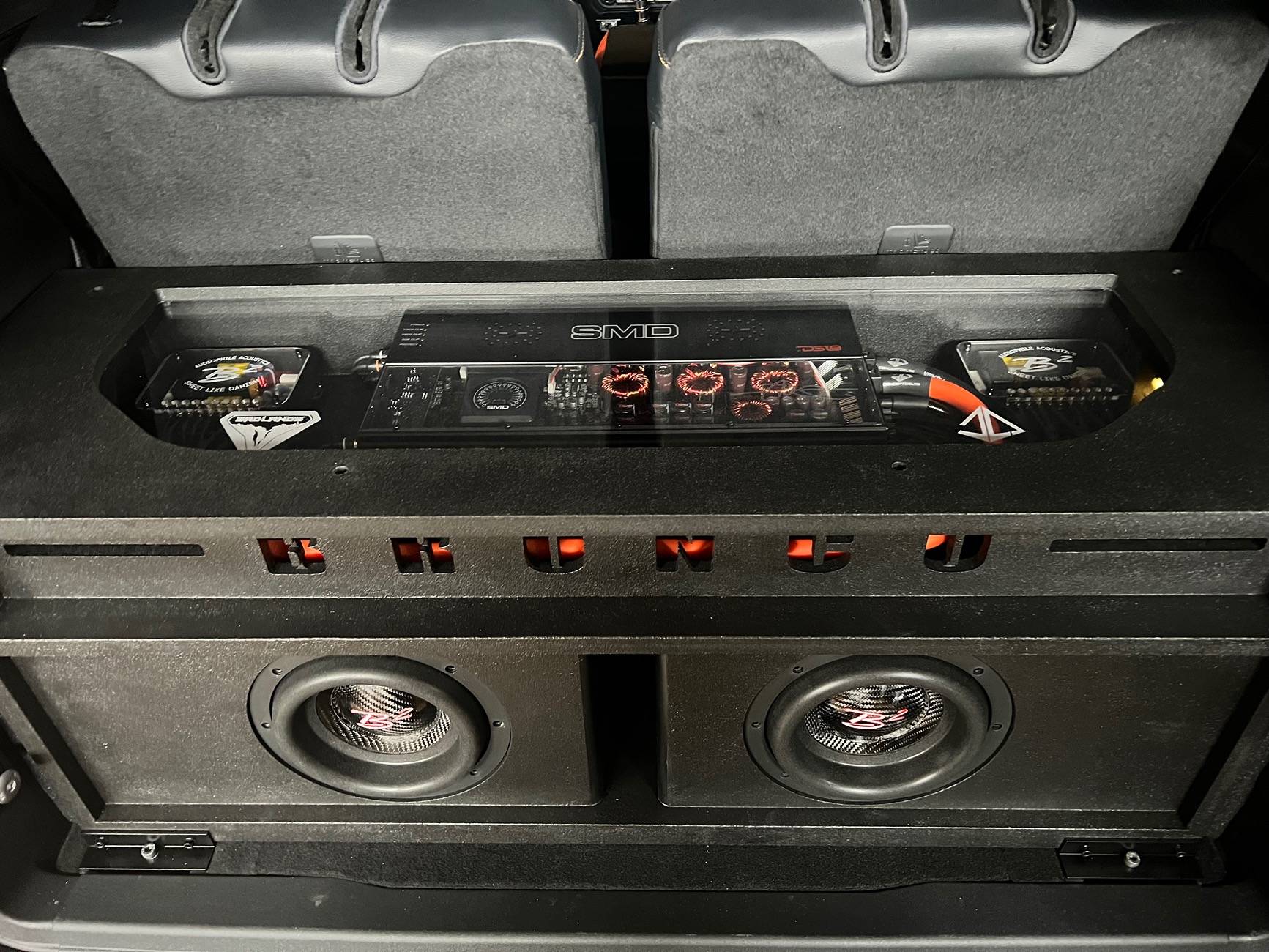

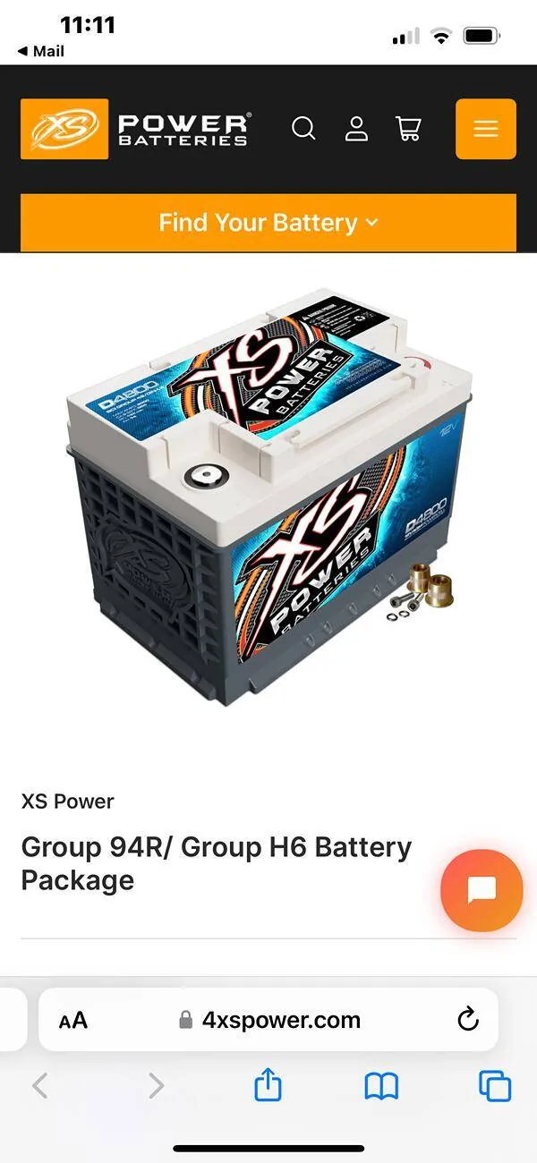

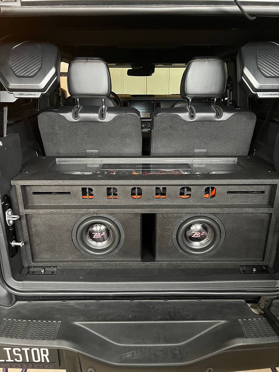

Just had the XS battery installed to power new audio.
Ford Bronco Looking to upgrade my battery IMG_4768
Ford Bronco Looking to upgrade my battery IMG_4682
Ford Bronco Looking to upgrade my battery IMG_4681

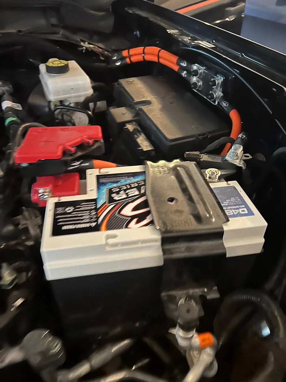

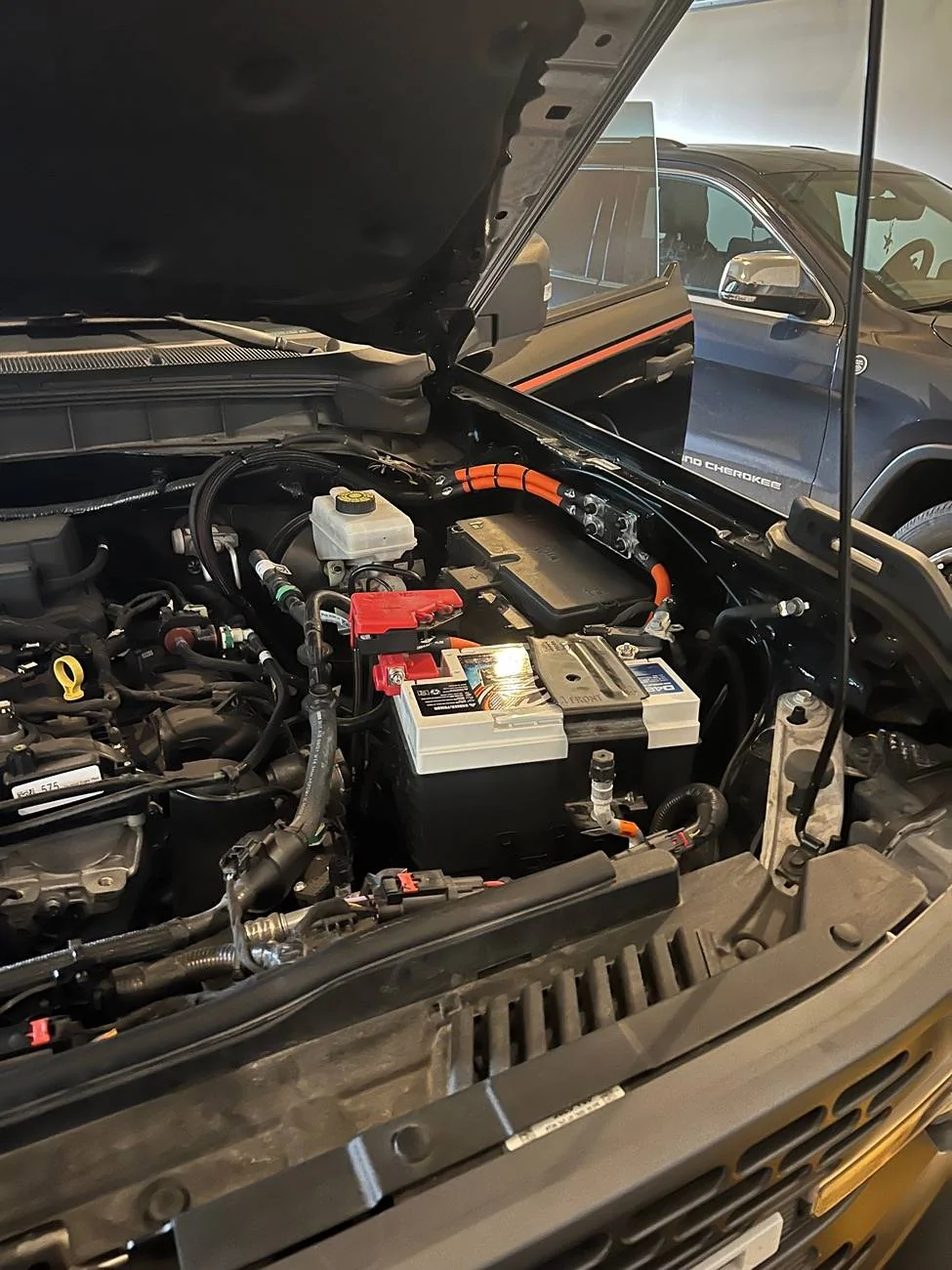

What did you mount uour audio fuse block to? Love the clean look. Is that 2 wires of 1/0 you are running?
Also, what made you choose
that xs battery over their Titan8 line of batteries?
Dawgzz
Jason Johnson
Apr 17, 2023
32
2022 Bronco
It is 1/0 and the fuse block is just to right of the battery 300 amp fuses. Used the orange wire as runs back and can be seen in the sub box. The installer is the local distributor for the battery, we didn’t talk about other options.
