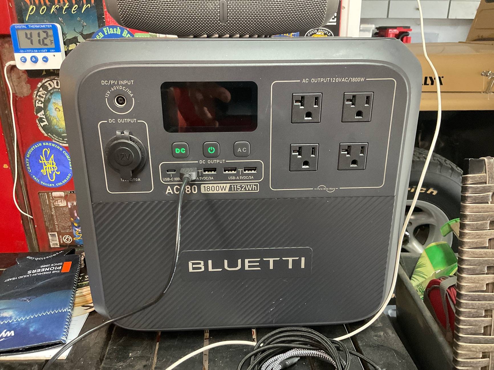

I take fairly long off-road adventures in remote wilderness every year. I have an ARB refrigerator that I have used since the 90s. I keeps my cold storage foods and drinks. I have found after the refrigerator is used overnight my Bronco OEM battery voltage gets low enough that sometimes the power port shuts off. I don't have a problem with that but if it is hot at night the refrigerator might get too warm. I need a battery with more reserve power. The OEM battery is only good if conditions are good and I am afraid as is gets older it may get worse.
Rather than add another hour or so to my starting battery capacity, I went with this:
Ford Bronco Looking to upgrade my battery image
It also opens up many other options with regard to refrigerators, etc.
You can sleep better at night knowing that your Bronco battery is not being loaded, even though the Bronco protects it from discharge fairly well.
Just my opinion with camping experience with a fridge at very remote sites. Hope to see you out there!
EDIT: And…with solar panels, I can do multiple nights at a remote site without running the Bronco.
