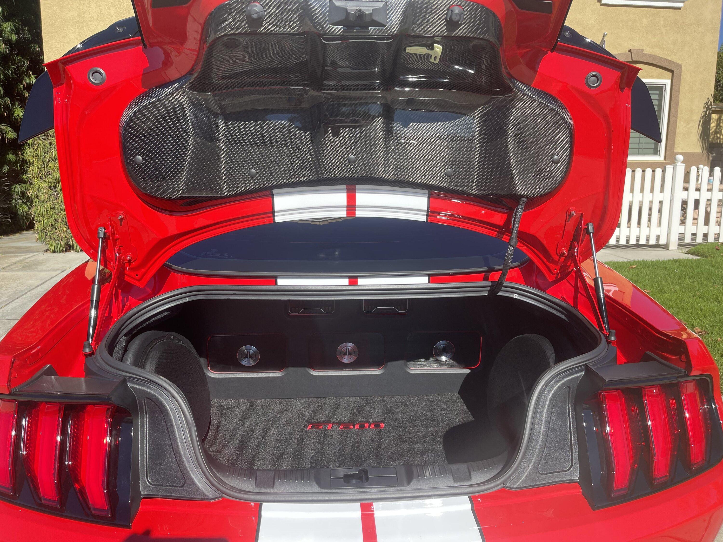

Thinking about speaker upgrade or going full new amps/dsp and speakers. I went a bit over board on my last audio build in my GT500. I don't think I need that much in the Bronco just Clean with good loud sound.

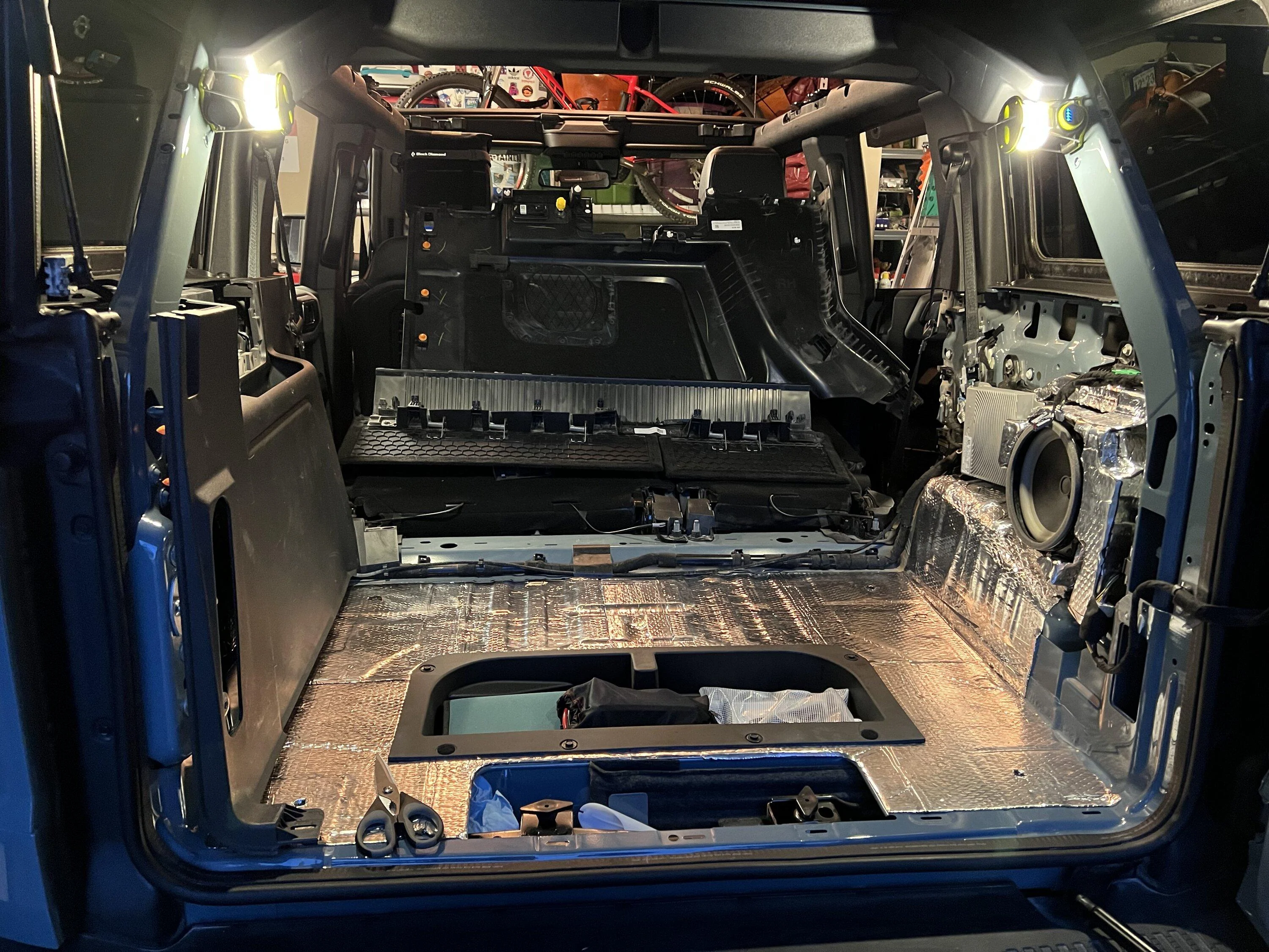

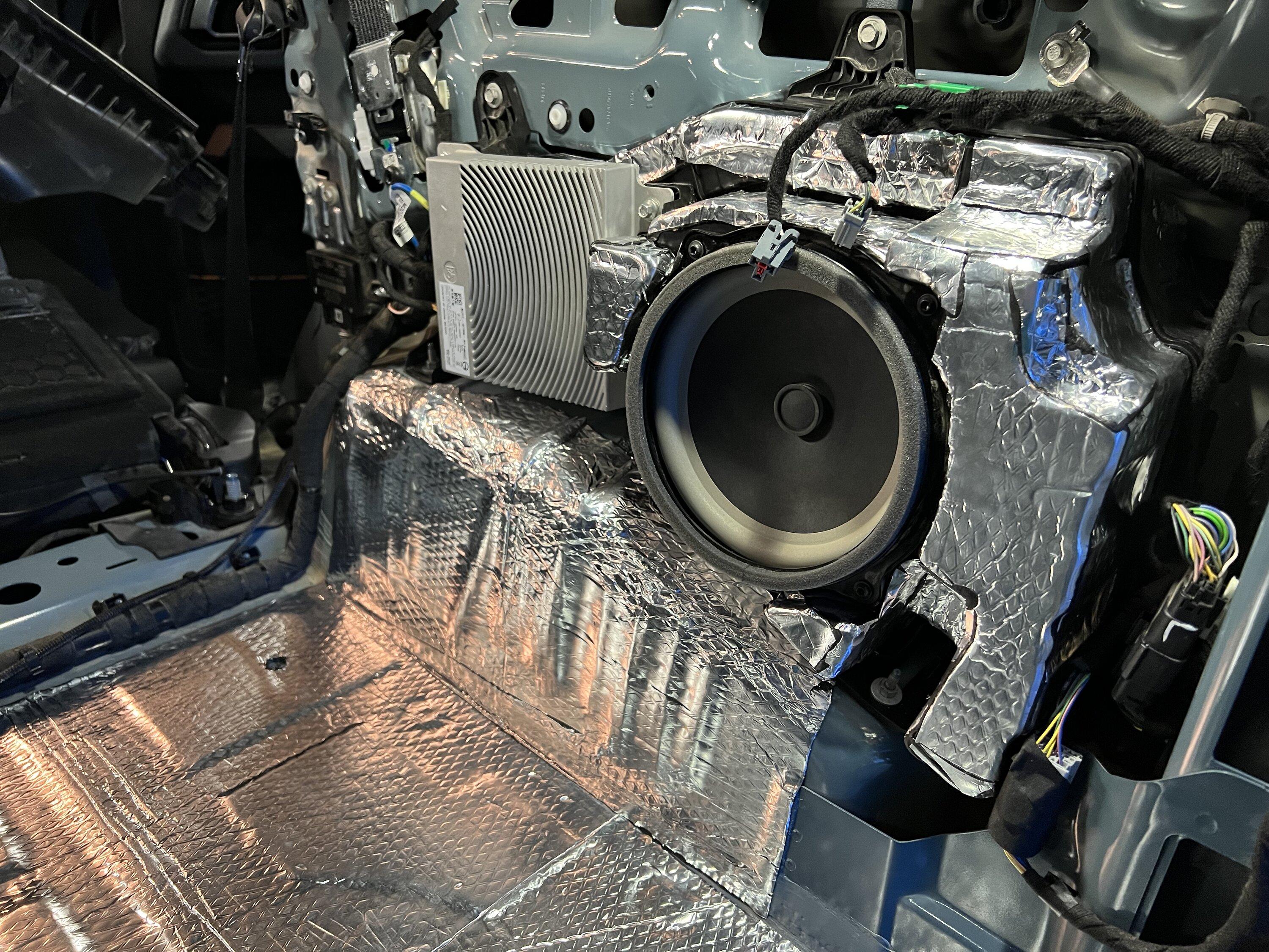

Boosted2.3L
Robert
Dec 17, 2022
34
Detroit, MI
Badlands Bronco
I can 100% confirm that simply replacing the B&O speakers with aftermarket ones makes a huge improvement. The key is to choose a speaker with the highest sensitivity rating possible. This is because the factory amp only puts out so many watts and a speaker with a higher sensitivity rating will make more efficient use of the limited power and therefore play louder and have less distortion.
Crutchfield lists speakers that are compatible with the Bronco and you can sort by sensitivity. I went with the Hertz DCX 100.3 for the front corners, center, and rears. Upgrading the kick panel speakers next. I also Dynamated the rear cargo area, subwoofer enclosure, and inside of the plastic panel covering the sub. It helped with the rattles and the bass seems punchier now.
I know a lot of haters on here mock any attempt to record the before and after sound improvement but you can definitely hear the difference in this video. Right side is stock B&O and left side is the upgraded Hertz speaker.
UPDATE: I just upgraded the kick panels to Hertz DSK 170.3 6.75” woofers. Definite improvement in mid bass and low end response. I’m upgrading the sub and adding a Kicker Key 500.1 to round things out
I don't care what people say, you can totally hear the clarity with the new speakers even with the compression! What type of music do you listen to and at what volume? I'm debating to go with those Hertz or get the Kicker KS series, but leaving stock amp/DSP means I might want to do you like, buy highest sensitivity speakers. When will you notice improvement for higher sensitivity speakers? For my use case, I play bass heavy music and listen to at least 20 on the volume dial, even higher when I take the top/doors off if that helps.
