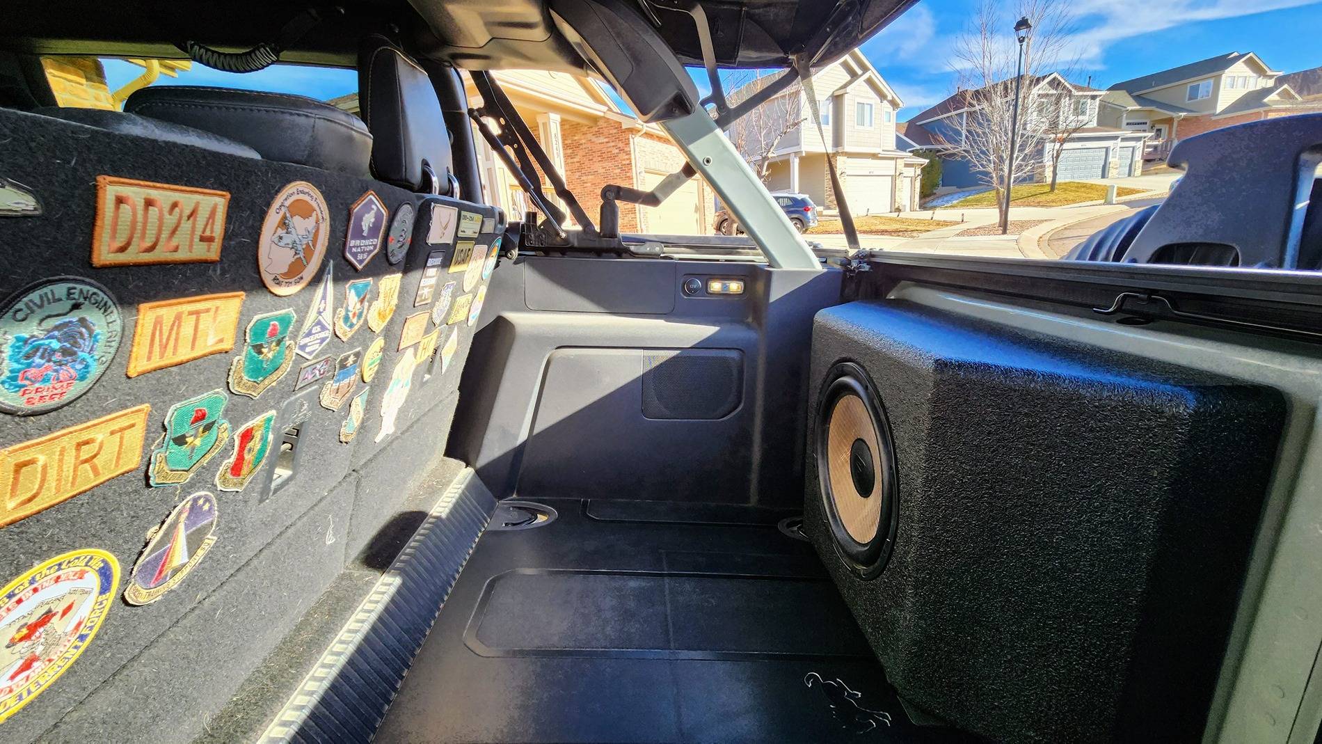

B&O Audio System upgrade completed.
I normally don't upgrade any of my auto sound systems, however I just wasn't happy with the B&O system with the volume turned up. I normally have the top off the Bronco and have a lot of road noise (which is ok with me). I found that music was just too distorted at higher volumes, lacked clarity and the bass just not good enough. (not to mention that pesky sub rattle) The B&O system isn't bad at all at lower or even mid volumes, but I rarely have it at those levels.
Absolutely Creative Customs out of Boulder, CO did the work and I couldn't be happier. I didn't want to spend a ton of money (I have friends who have spent well over $7k) so I focused more on adding additional clarity, power and bass. We found a sweet spot that works perfectly for me and my budget. Amazing clarity at all levels with a perfect amount of bass....even with all of the road noise and wind blowing in.
Out with the old and in with the new...the new 12" sub was relocated to the tailgate. (a much better location)
Here's the route they suggested and what I went with:

$3,500 was my budget and I spent $3,557.
There's countless ways to go when upgrading...the key is to find what works best for you.
