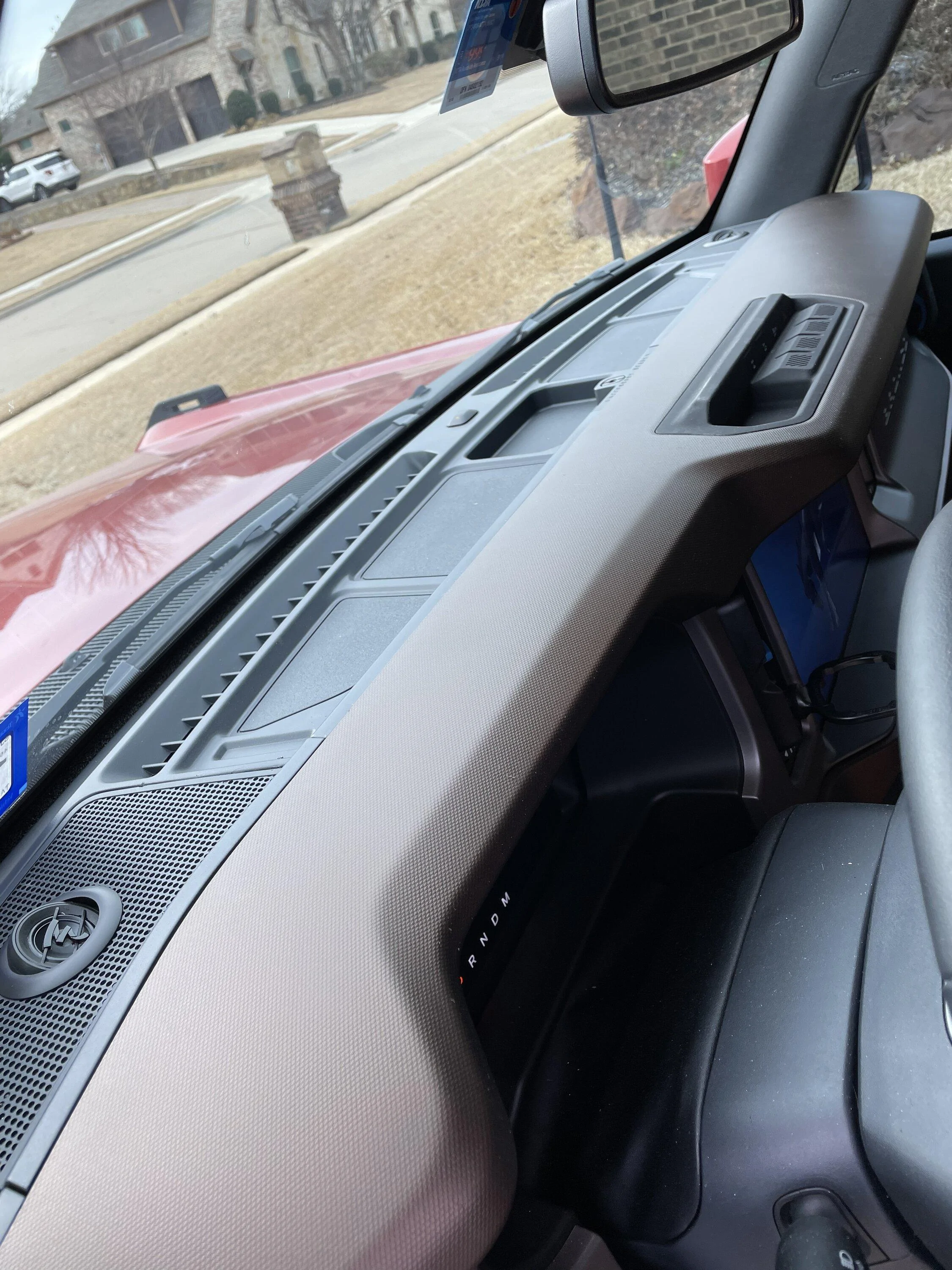

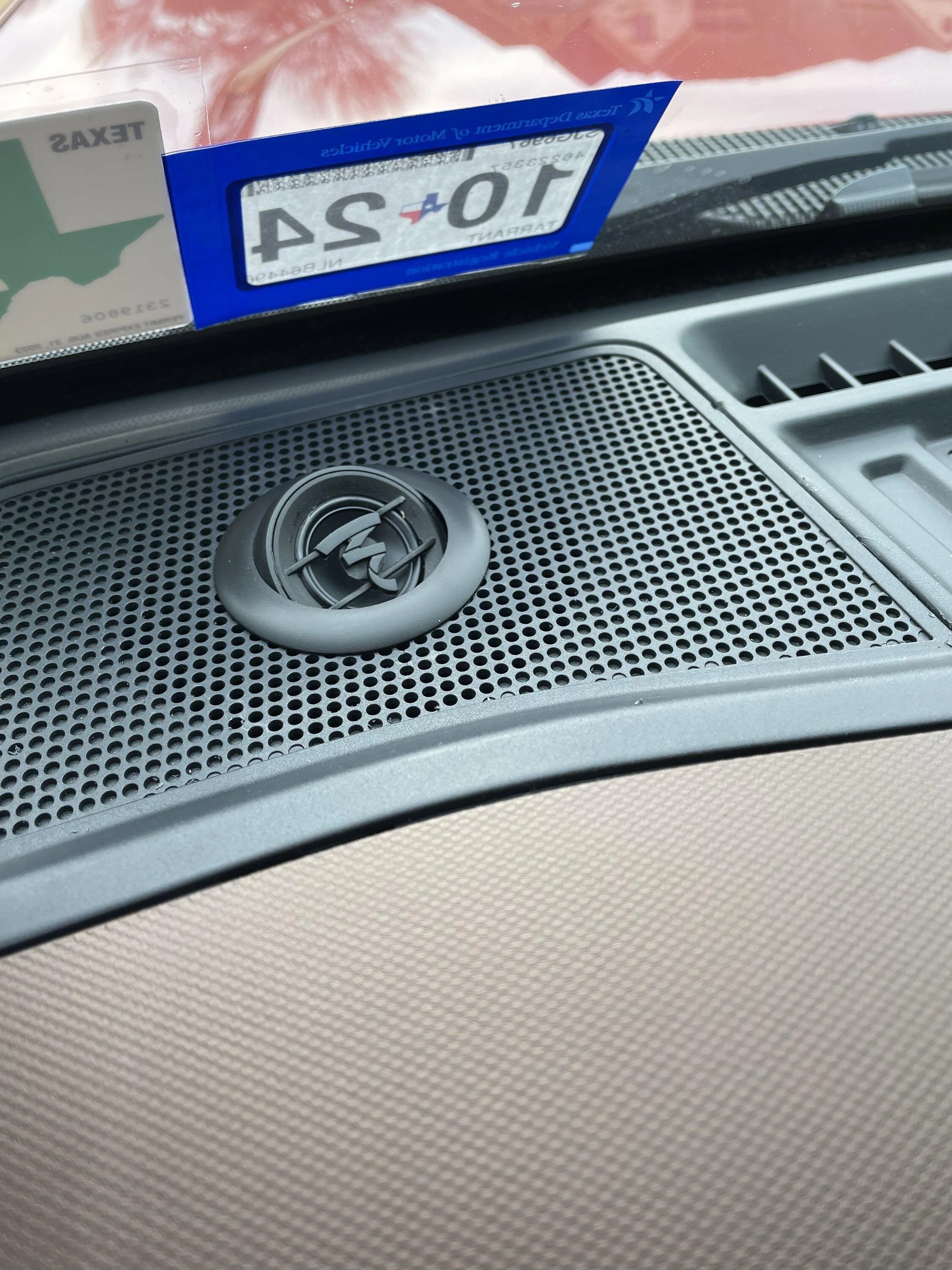

I went ahead and drilled a hole through the dash speaker grills and mounted the tweeters flush. The grills are only like $22 and I figured I could replace them as needed. This gives me more ability to play with angles and not have the grill interfering with dispersion given only the center section of the grill is open.
I put them in this position and reran the Kicker DSP. I’m getting some harshness reflecting off the door glass but overall an improvement from firing straight up at the windshield and not audible until about 17 on the volume with the windows closed. No harshness with windows down at any volume. They may be better still mounted in the A pillars but I’ve not researched whether that would affect the air bags, if there is sufficient space behind them and what the cost of the A pillar covers are if I screwed them up or wanted to remove the speakers at some point.
That's really cool. Looks awesome. Did the Focals come with the swivel mount? I think you've just given me inspiration.
What did you use to drill the holes? Hole saw?
They came with a couple cup options depending on how much swivel you wanted. I just measured to find the center of the grill, ran an awl through the closest hole to open it up enough to start the hole saw bit without it “walking” over the grill surface. I went slightly smaller than the tweeter cup with the hole saw then used a file to open the hole a bit more, still keeping the tweeter snug.

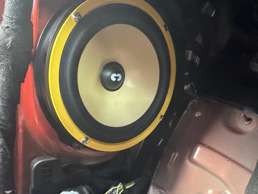

Thanks for this thread. I just got my Bronco with the Lux package and have already started on this journey.
Yesterday put in CDT EuroSport ES-643's 6.75" woofers in the Kick Panels. I plan in the future to incorporate all the pieces of this 3-way set (that I've been holding on to for 20 years), but the budget doesn't allow for that at this time.
Ford Bronco B&O Sound System Upgrade Tip IMG_0905-XL
I didn't think I would hear any difference, but I'm happily surprised that I did. The muddiness that I heard on the mid to low end is almost completely gone. (I think the rear sub is to blame for is still there).
As a stopgap solution until I can afford to properly redo the whole system. I've purchased 4 CDT ES-4EX 4" Coaxial speakers that I will put in the front and the rear. Just waiting on the Fast Daddy harnesses to arrive.
Still need to get a center speaker, just not sure what direction I want to go with it. And will need to change the subwoofer out as I don't like bass sounding the way the majority does.

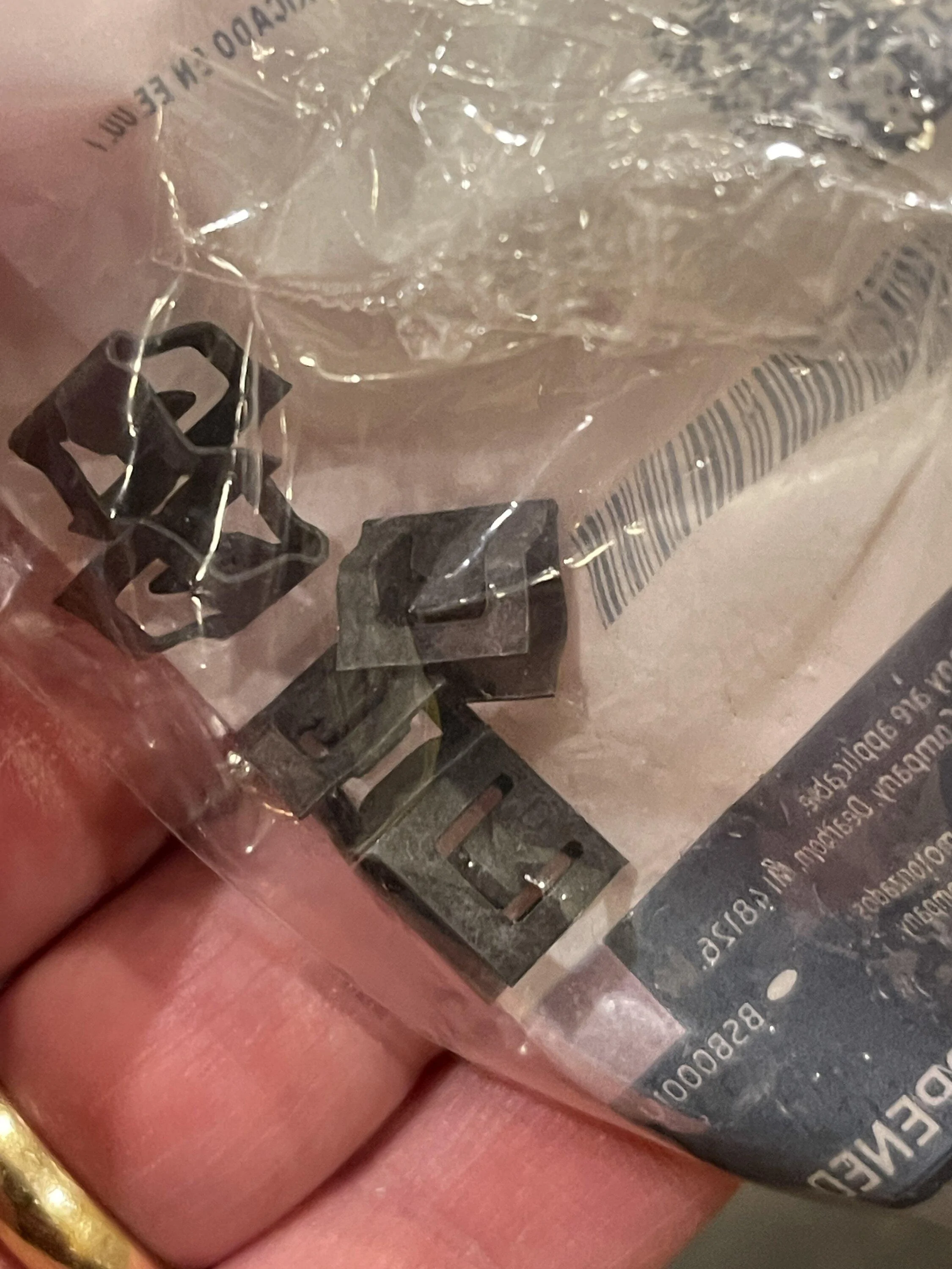

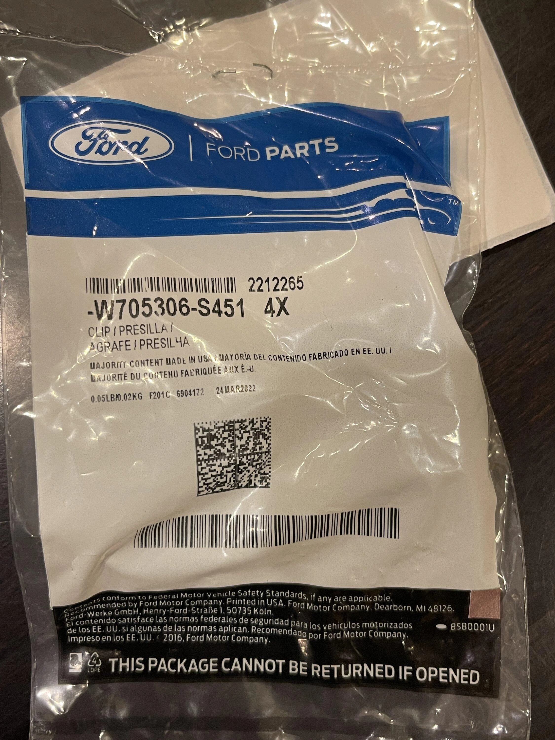

Before I pull it again, I'm going to order some of the metal clips that I seem to knock off every time I pull the cover. Only done it twice so far but three have come off each time. The first time I was able to find them all but the second time, one went deep into the abyss... I'm sure lost for eternity.
I'm considering ordering the other speaker based on your recommendation and the low price. Only thing that sucks is having to pull the cover again.
First time I put it back on, I couldn't get the back fully seated but I think I had too much of the harness still in the way so I pulled it again and tucked it back down. Released the USB ports from the cover to make it a little easier and that seemed to help. Those clips are definitely in there nice and tight. I think I'm getting much better at it at this point but hope to never become a pro.
@flip - what was that part number again for the metal clips that hold on the center channel speaker cover? If you'll send me a link to where they are in your store, I'll order a few or a pack or whatever.
Did you find the part number for the metal speaker grill clips? I’m missing one.
