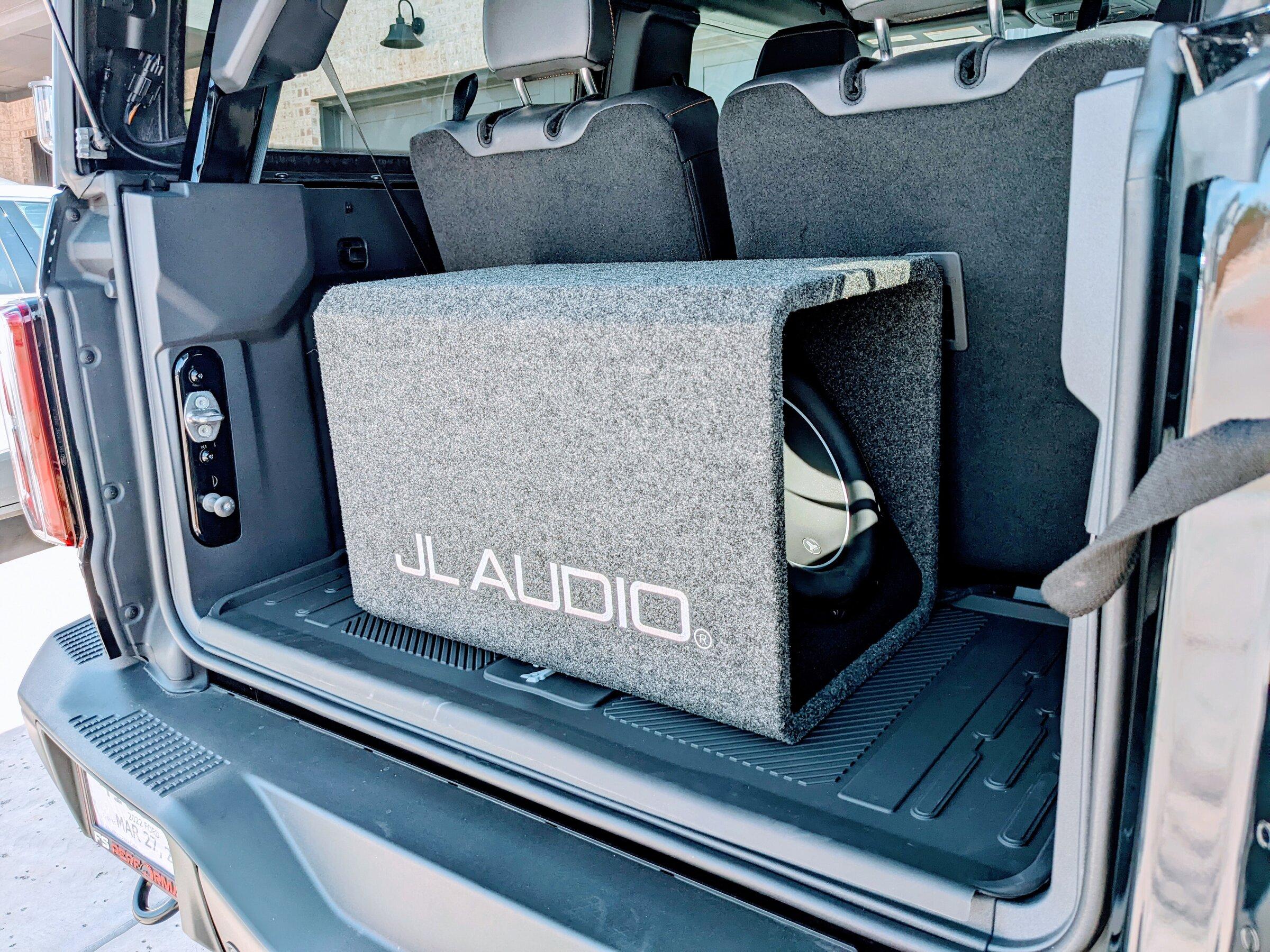

I'm picking up my 2DR from a local audio shop tomorrow and was told similar things that the OP mentioned. I had them install a JL XD600/1v2 and HO112-W6V3. They wired the remote to Aux 6 so I can kill the amp and take the box out for extra cargo when needed which will be rare for me.
I asked about replacing the 4s and 6.5s and they said it would be a marginal if any difference. They weren't pushy but said adding an amp would be recommended with the replacement speakers. And noted the Zen A2B requirement to replace the B&O amp. So I'm going to drive it a while, then maybe replace the dash and rear pod speakers myself, a little more worried about the kick replacement. If I like it, great, if not, I'll consider the amp/Zen.
They recently installed JL vex pods for another customer's Bronco, without an amp replacement, and they were happy with the results, since that moves the rear pods up to 6.5s from 4s.

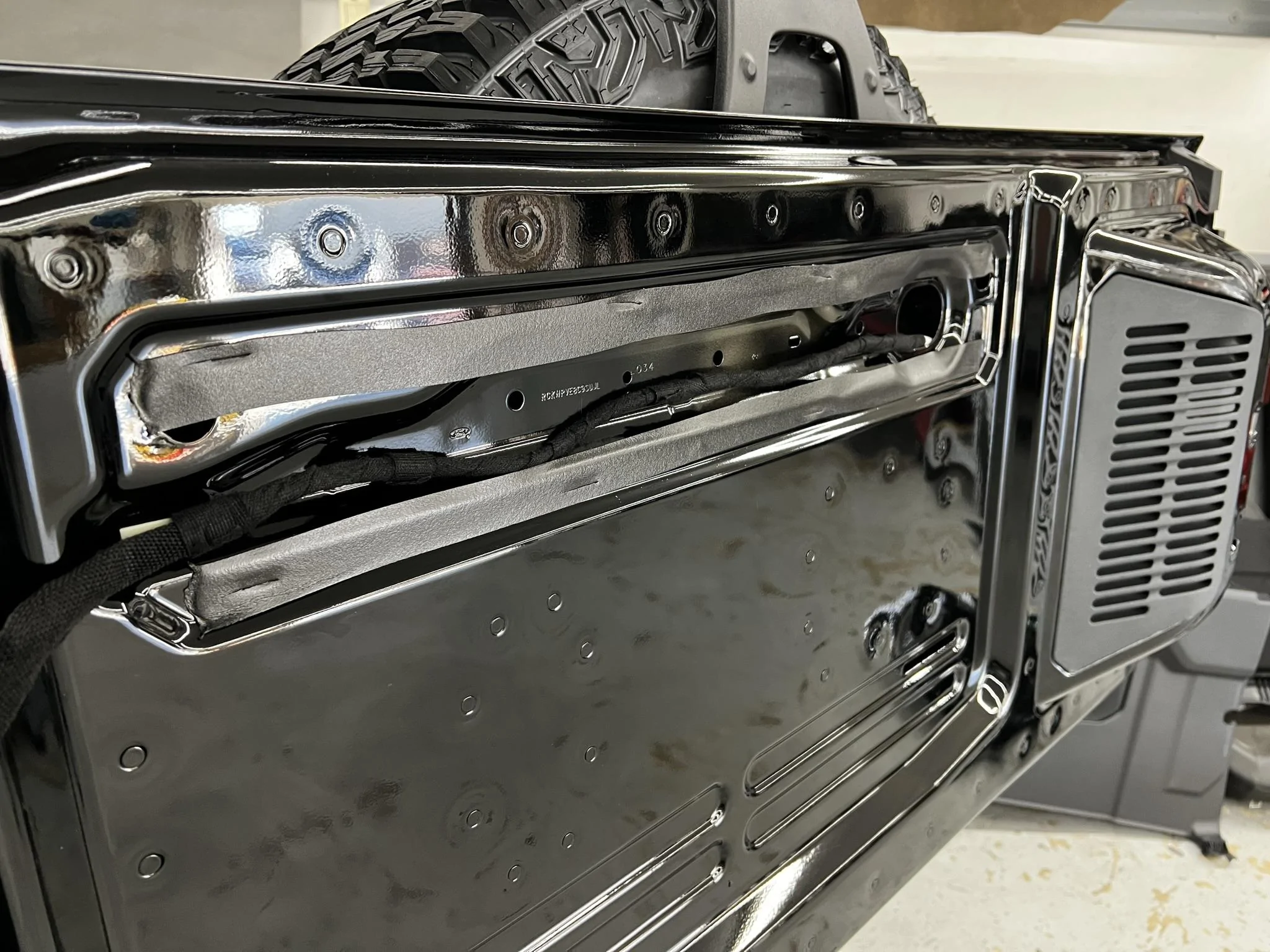

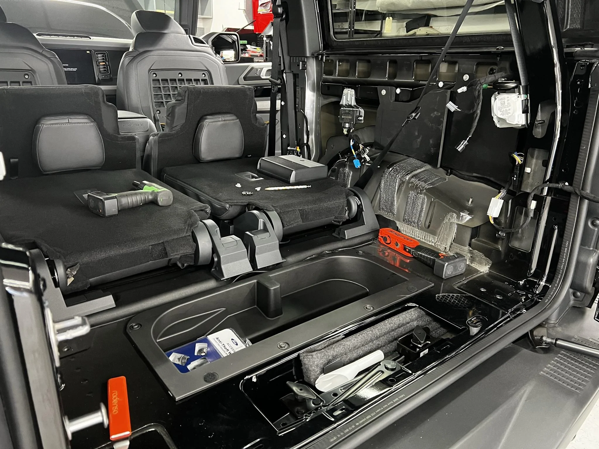

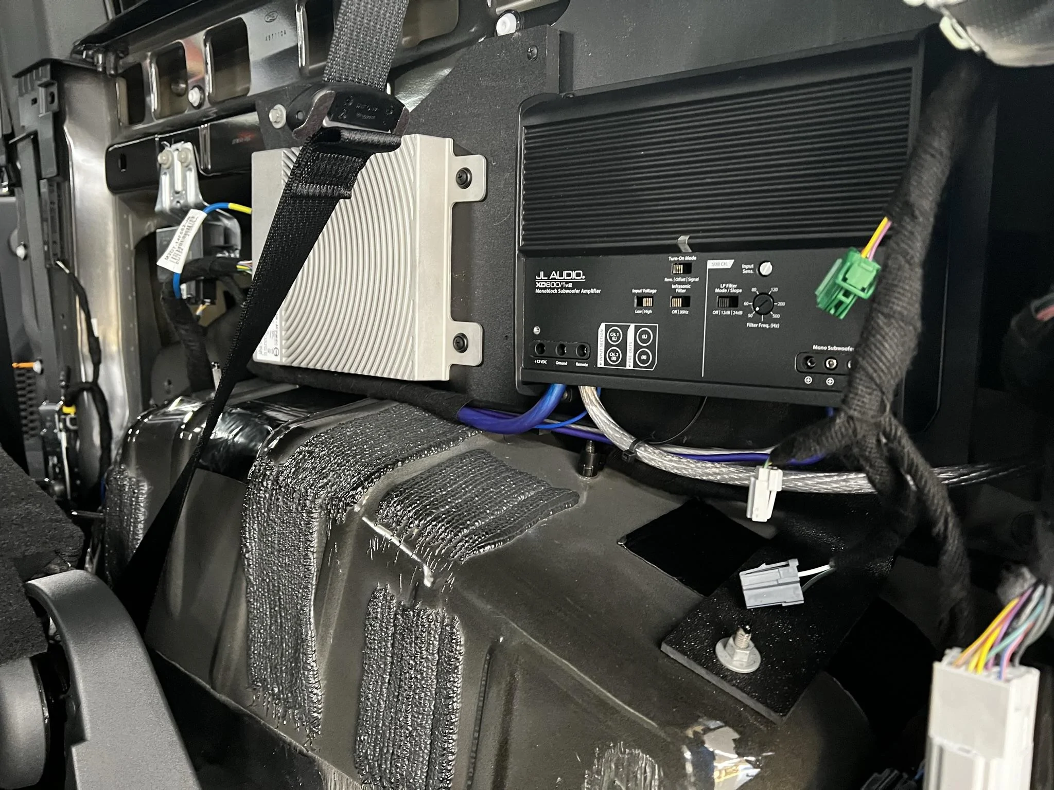

Here's some photos of my install. They did some dynamat and also quiet tape on the tailgate plastic pieces to help with rattle. They removed the stock B&O sub, and put the JL amp in its place. I hated the B&O sub.
