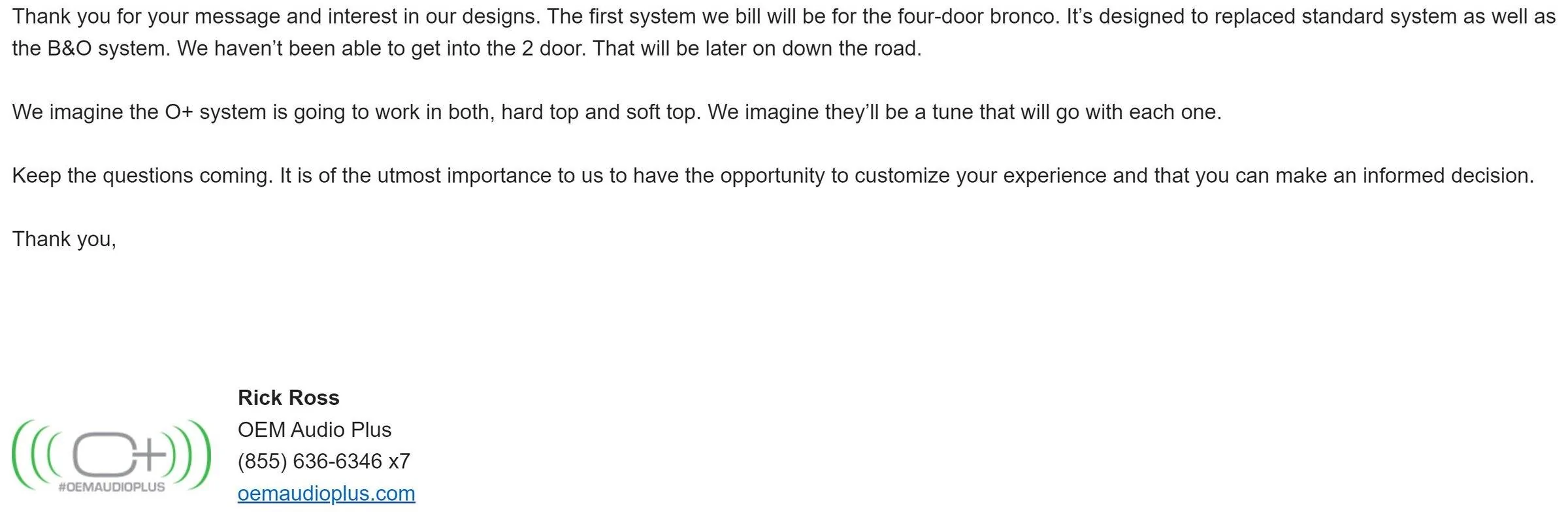

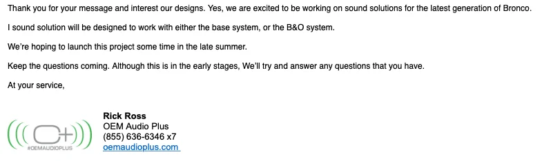

Anyone here familiar with OEM Audio Plus? The design speaker upgrades around the car's acoustics. I've read and watched positive reviews on the systems but haven't experienced one myself. They are pricing however..
Here is their setup for the JL Wrangler.
https://oemaudioplus.com/jeep/jl-se/
I'd pay it. I just sent them a message asking about the Bronco
