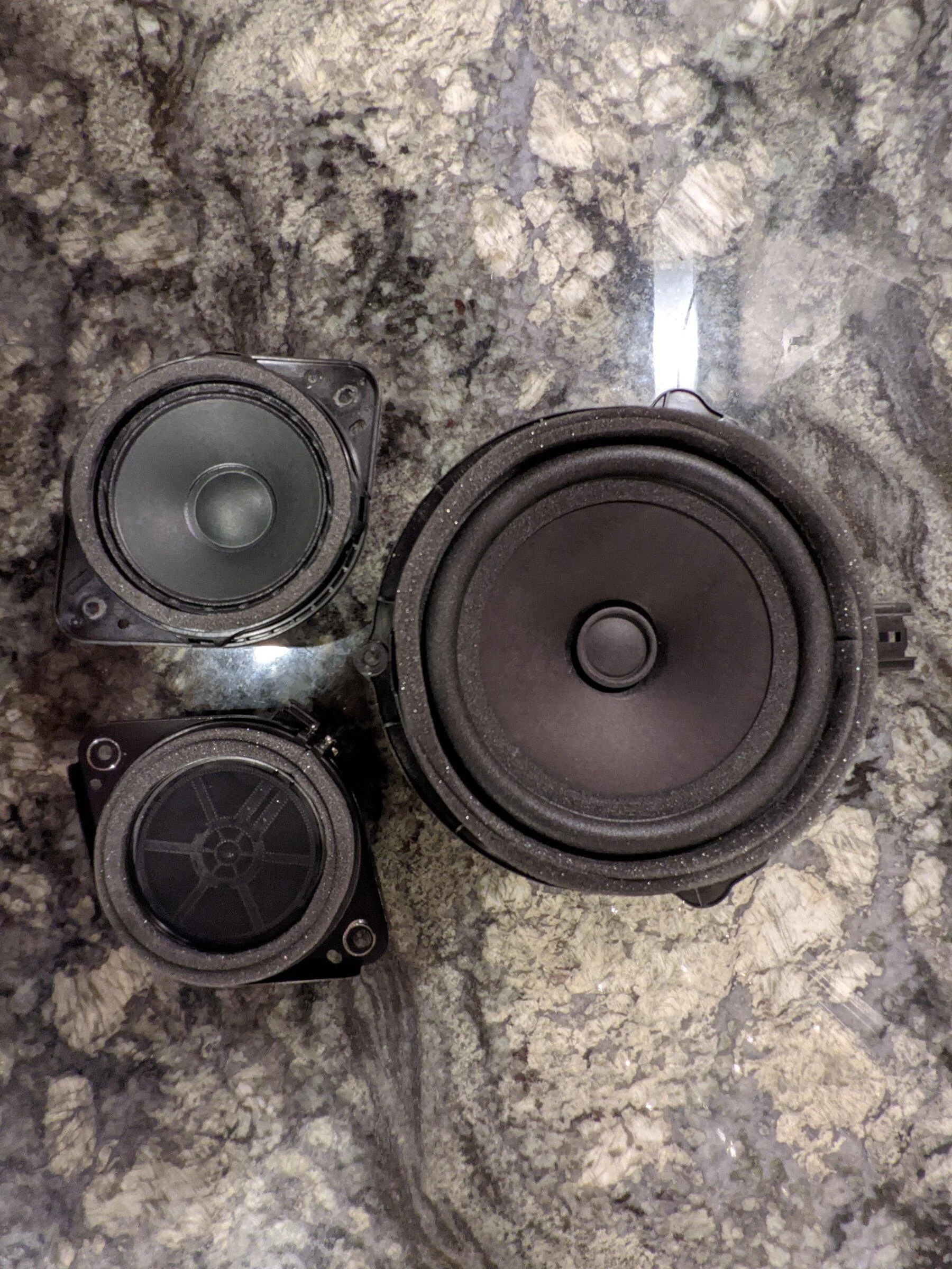

From the pics I've seen the "B&O" speakers are just cheap off the shelf crap.
Here are the B&O speakers. Only thing special at all would be the bottom left in my pic, which is the dash corner (2-ways)
Yes, the rear pods and kick panel speakers are the same in the base and B&O systems. Crap paper cones.
