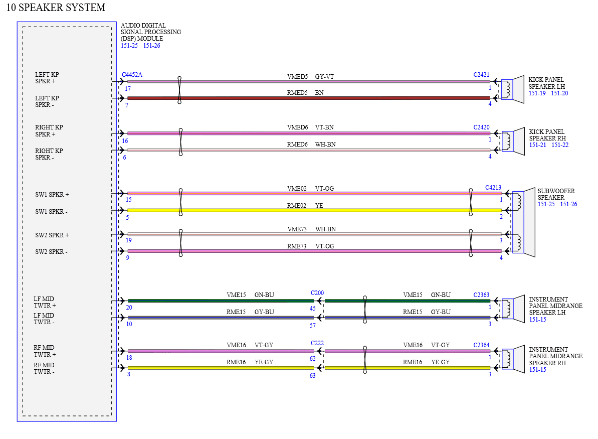

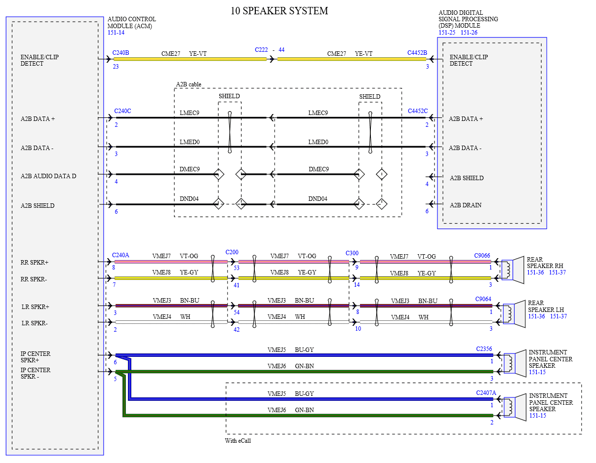

I’m not understanding the part where he says it’s all digital coming from the head unit. I don’t have the B&O, but that would certainly be surprising. Perhaps a digital out straight to the amp? If so, I’m glad I didn’t get the b&o because that would make the upgrade more different as he said.
It’s just fancy words for the DSP signal. The head unit talks to the amp/DSP in a digital form. Digital Signal Processing. It’s common.
The DSP is internal to either the head unit or the amplifier. The actual output signal is still analog, right?
The DSP/amp are one unit. Digital from head unit to DSP, then yes regular analog audio signal to sub/speakers.
Okay thank you. That adds another layer of complexity to the upgrade process.
