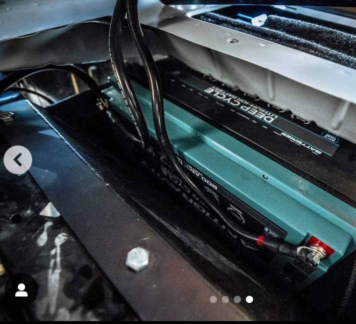

Alternatively, here is where my buddy mounted his deep cycle 200amp battery for all his overlanding. can charge by solar as well. Has a bracket underneath that holds rhe battery close to where the removable cargo tray is.

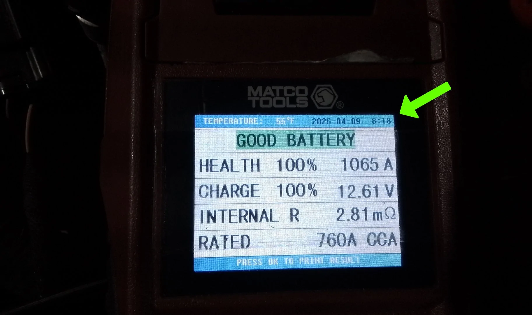

2 weeks ago, I put in this https://www.autozone.com/p/duralast-platinum-battery-h7-agm/319458
Perfect fit, runs strong.
I swear when I bought it the warranty was 5 years, but now lists 4 years...
Got oil changed Thursday, they tested the battery and sent me this
Ford Bronco Looking to upgrade my battery 639113340150218361
Website says it is 850 CCA, I dont know why the numbers don't match.
