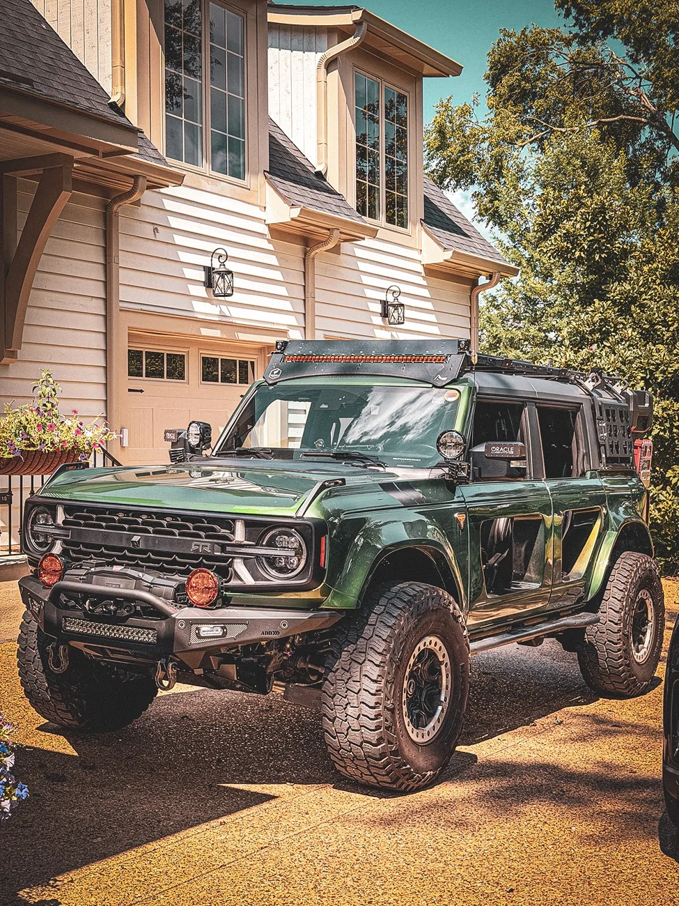

I strongly feel (cue Iron Maiden - Fear of the Dark 🎶) that MOAR lights is better. Late night rural drives on windy roads being part of that motivation, campsite illumination being another and being able to clearly see the obstacles or during recovery being top of mind.
but I’d note that long throw spots or laser patterns aren’t my jam because they don’t follow my needs: I’m on curvy roads and the Bronco simply doesn’t go fast enough on straight lines or sweeping curves for narrow through.
so beam patterns for me was a key decision: I went with Scene, Flood, and Drive. I have multiple angles slightly to the side or significantly to the side to see both around turns and to light up trail side obstacles.
color choice is also a key: I think rigid Amber is my favorite but you can go white and use lens covers to get that. A lot of people like Baja Amber (yellow). Big fan of cutting through dust, fog, and rain/snow, and less bug activity - solid white just lights up every damn spec of distraction in the air by comparison.
Rigid 6” 360s are great as are their D-series. I just installed a pair of D-SS I had on a winch plate for a friend - really great there or ditch / a-pillar location and they are indexed left/right so the side shooting doesn’t require a partial cover to avoid hood glare.

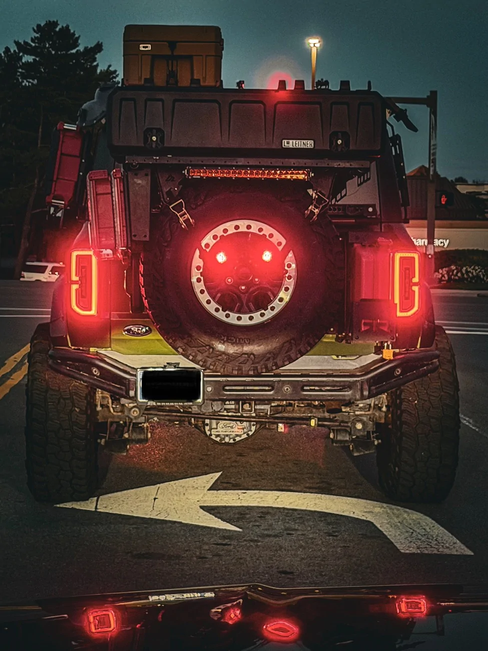

… I use a Jackery for camp, but interested in what you’re using out back on the bronco?
I am a huge fan of the Devos Lightranger 2000 and there are tackform mounts you can use off your roof rack.
the back of my Bronco has the diode dynamics C1R in the hitch receiver normally (not shown in pic), and the 2x DD C1Rs on a spare tire bracket pointed at angles. Since these are all using taillight circuitry, they illuminate with the reverse lights when reverse is engaged but also with the Bronco scene/perimeter lighting modes. I also swapped the rear bumper harness to the euro one and use the OEM rear fog circuit (coupled w changes in FORScan and the proper 2-fog button headlight switch) to trigger the spare tire C1Rs allowing for rearward illumination even when not in either reverse or using scene perimeter lighting.
on the AAL spare tire platform, I took my 20” heretic lightbar that used to be on modular bumper (bumper mangled on an errant Nissan rogue crossing traffic, all heretic lights came out unscathed). It used to be set to an aux switch using the SPV parts mini relay adapter, but is now connected to the Garmin PowerSwitch (which lets you configure scenes beyond on/off, like strobe or flash and you pick the on-time and off-time intervals, and unsure if the heretic LEDs are dimmable but you could dim it via PowerSwitch).
I like to think of it like a chase bar but it’s been used a few times to tell a maniac cutting through traffic and tailgating that it’s time to chill out.

I’d also note the power switch is super slick. It has 2 input triggers, and 6 outputs. So you can use your phone or CarPlay to enable 1-6, or set a “scene” that’s a combination of lights, and set them to flash or whatnot. My OEM upfitter aux3 switch is connected to an input trigger set to turn all forward lights on, so one aux switch turns on:
  • 2x Rigid 360 6” Pods - Bumper​
  • 1x Rigid 20” RDS-Pro Light bar - Bumper​
  • 2x Rigid 360 6” Pods - A-pillar / Ditch​
  • 2x Rigid D-Series Scene Pods - Wide Ditch​
  • 2x Rigid Ignite Diffused micro Pods - Steering Knuckle​
  • 2x Rigid Revolve mini Pods - Roof corners​
The kit from Blaze Offroad is great — the bracket is well designed for above your aux switches at firewall and has a ground bus, making wiring really really clean. Super recommend this setup.

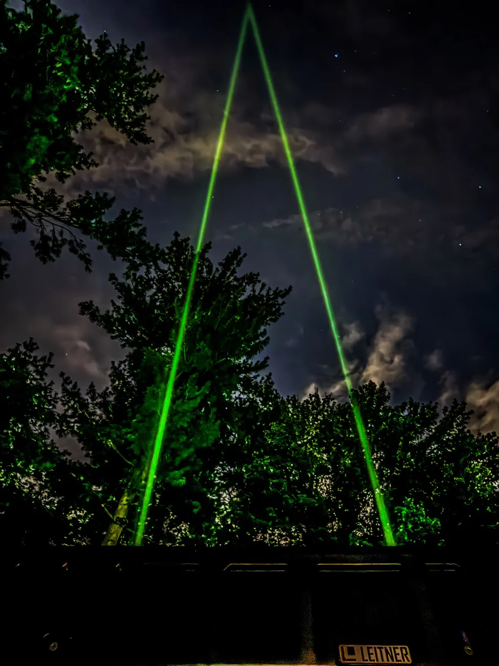

For aux switches, the Aux1 is the roof rack light bar (heretic 40”), and Aux4 are rock lights (incomplete project - front wheel wells 2ea and 1x under front bumper only so far), and Aux5 is alien lasers tractor beams mounted to roof rack pointed skyward. My aux switches use the SPV WP numbered adapters so I can switch things around. Aux6 is ARB underhood twin compressor and I may shuffle things to insert a solenoid for winch at 6 and bump the other things left by 1 spot.
