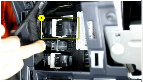

The door trigger wire you are looking for is down at the interior fusebox on the driver's side. Forewarning, it is a bit of a pain to get to, particularly if you don't do automotive wiring every day for a living. It is the grey/purple wire at the large connector towards the top of the fusebox. I attached some pictures below. There are also a number of other wires in that harness that look similar, so take your time and make sure you have identified the correct one. Most commonly, people grab the grey/brown wire as it looks nearly identical, but it will not do what you need it to do. Tagging this wire will give you 12v output any time the doors are opened, but will not provide 12v when the dome lights are turned on manually, which sounds like it would work for what you need.
Ford Bronco Lighting assistance needed. Door assist function does not work? 1750941784501-q
Ford Bronco Lighting assistance needed. Door assist function does not work? 1750941808664-l
Alternatively, you could use the module we sell, and modify it for your needs. You would plug this into the rear overhead dome light, and cut off the 2 pin harness connector containing the black and grey wires. From there, extend the black wire to the door trigger wire of your running board lights and insulate the grey wire. This has downsides and upsides since it would output 12v any time the dome lights are turned on. That is sort of a positive, since when you hit the unlock button on your keyfob, the dome lights turn on and would turn the running board lights on prior to actually opening the door. However if you are driving down the road at night and turn the dome lights on, the running board lights would flip to white which might be a bit of distraction for other drivers on the road.
