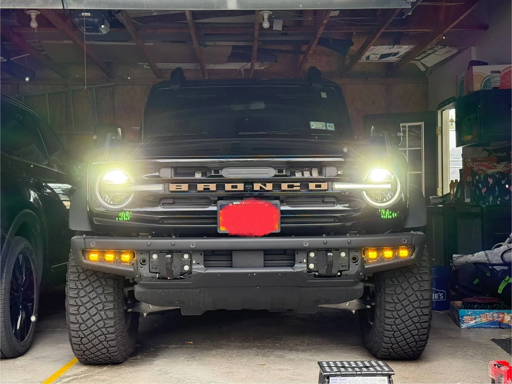

My amber fog lights arrived today and I’m very happy to see them working.
