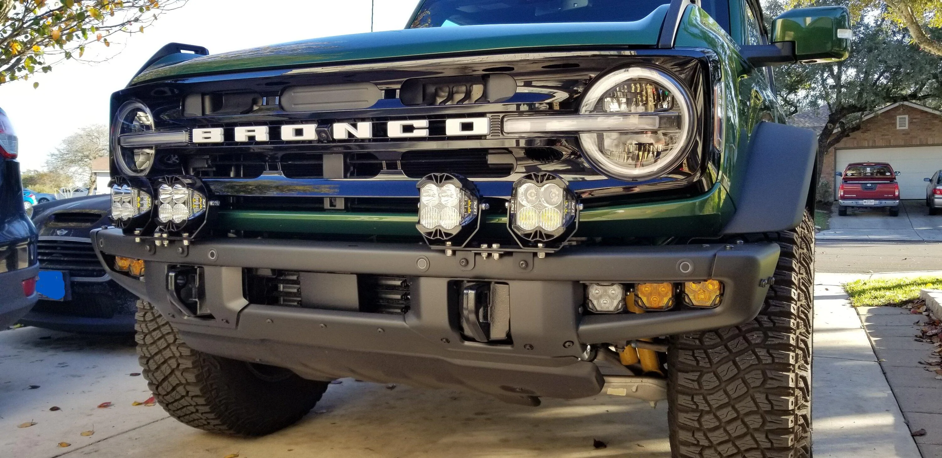

I love my Morimoto(s). I won't get into why I like the Morimoto(s) more than other brands, but diffidently get pair of White Fogs, Yellow Fogs, and Yellow Driving Combo. The driving combos are a tab brighter than my high beams. So if I need light for normal driving, headlights w/ white fogs. In low vis condition, yellow fogs. I sometimes I will use both yellow driving combo and yellow fogs without headlights (when no traffic is around). I also angled fogs towards the outside to give me even more light outward for the deer we have in my area.
They give off a lot of light. Would you mind sharing why you like the Morimotos? I am still trying to decide on which brand I want to buy so I am open to suggestions.

Each pair are on their own aux switch. I got them from 4x4truckleds. Like yourself, I spent a lot of time debating own which fog lights to get. I chose the Morimoto's due the looks of the triangular design and their smaller size. But the main reason was that all three pairs are the HXBs. The HXBs put just as much light (technically a little more) than Diode Dynamics SS3 Max. I have a friend with SS3 Max, and two sets of SSC2 Pros. I honestly can't see a difference in output between my HXBs and his Max, but there is a noticeable difference between his SS3 Max and his SSC2 Pros. My Morimoto set-up is like having three pair of SS3 Max which due to the SS3 size you can't fit three pairs in our bumper. The only drawback is so backlighting, but I not a big fan of it anyways. My Baja Designs LP4s are backlight and hooked up to a dedicated AUX swtich but I always leave them off---I just prefer it that way.
There is a great You Tube comparison test titled:
LED Pod Light Heat Test and Brightness - Diode Dynamics, Morimoto, Baja Designs, RIGID

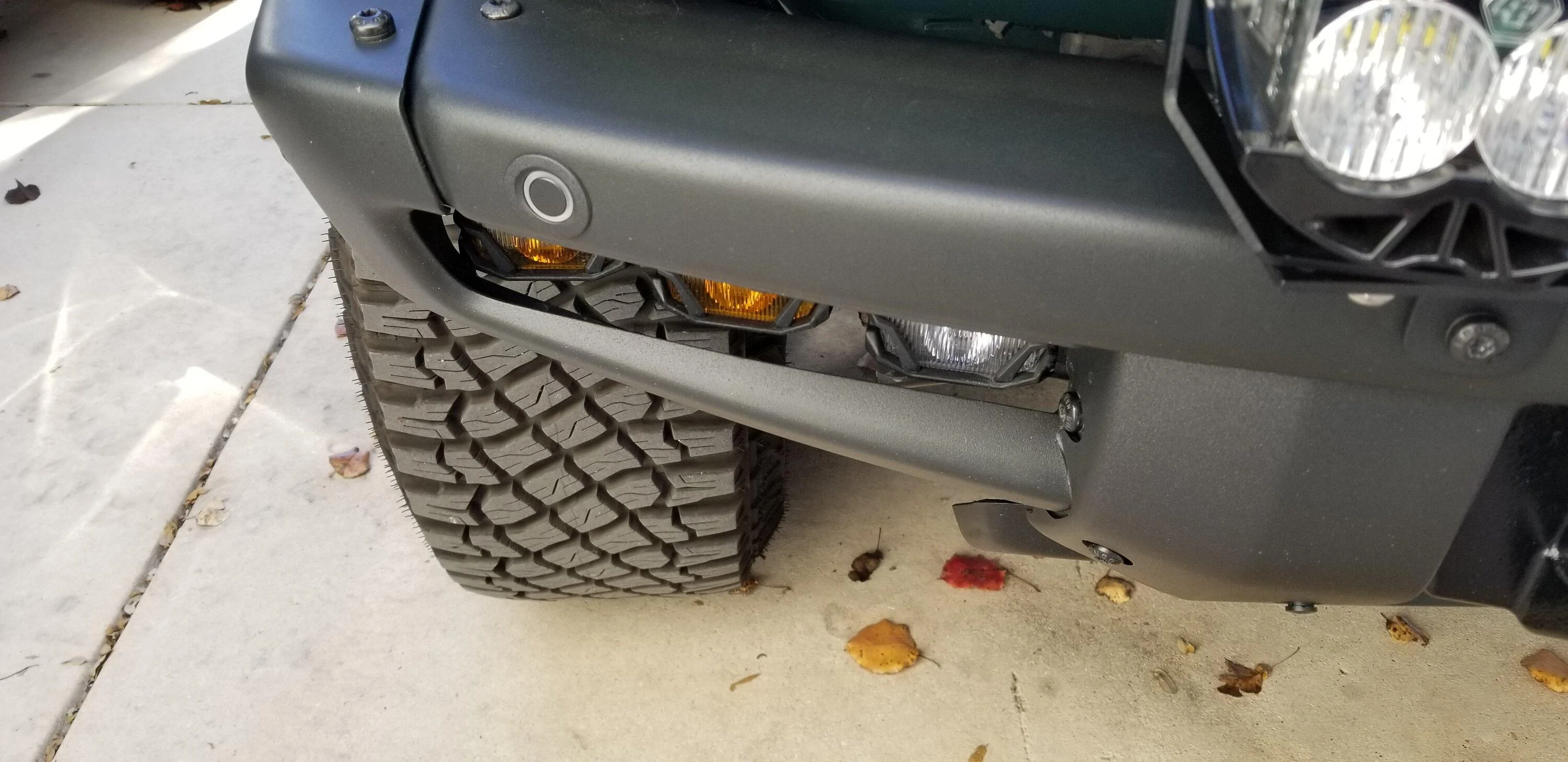

The bar I have installed is below. Looks similar to the the one you have in the picture above on the blue bronco. Do you think the light bar you have in the link would work? If not any other suggestions for either a light bar or individual lights on a light bar bracket that may work with this?
It might not work because it angles too much and we did not design it for that bar. We designed it for the factory safari bar

I unfortunately didn't really like the look of the factory safari bar as it covered the Bronco logo so I went with this one not really thinking ahead because initially I only had intentions of adding fog lights but after seeing Broncos with the backlit bumper bars I really liked the look. I saw this modular light bar bracket from where I got the bumper bar from. The light bar seems to work with both the bumper bar I have as the same bumper is shown in 2 pictures as well as with individual lights. From my bumper to the bottom of the bar I have roughly 7-1/4". The bar probably sits 1" above the bumper leaving about 6-1/4" clear. Do you think individual lights from Diode, Baja, etc would work? If so what kind? As I said I am really looking for something that is backlit and functional as a combo light but for me its honestly more about the look of having backlit fogs and bumper lights as I'm driving down the road.
