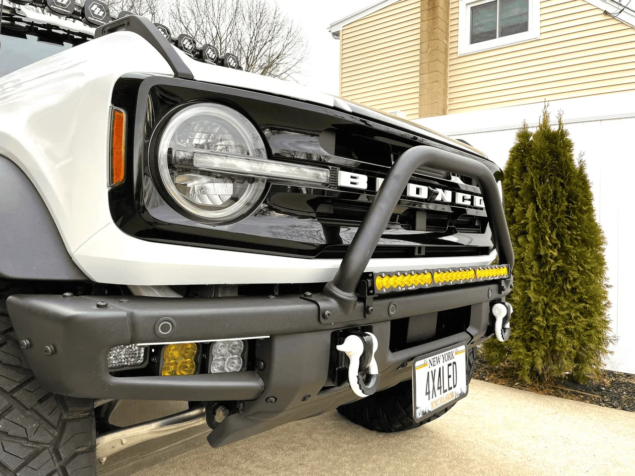

I'm assuming that the fogs are SAE? So the the lighting would be used how? The SS3 Max Yellow Fogs would be used in heavy snow and fog, the SS3 Max White Fog (or SS3 Sport White Fog) could be used all the time everyday/night under normal driving conditions and the SSC2 Pro White Combo would be used on roads needing more light with no other cars around? Could the Max Yellow Fogs be turned on in extreme conditions even with other cars on the road? Could the Max White Fogs be turned on every time I drive under normal conditions, kinda like a daytime running light? Then if I choose the backlit option are all lights backlit? And by backlit it means they will have slight glow similar to an accent light? Is there additional wiring to be done to make this work?
And what suggestions would you have for pillar lights and a bumper bar light that would have a slight glow and then when turned on act as a spot or flood light? I have a prerunner bumper bar so I would need something that fits within that. Even if the bumper lighting and pillar lights are the same manufacturer and the bumper bar light is different manufacturer I'm ok with that.
Yes SAE Fogs are fog lights that are street legal. Used during normal driving conditions.
Yellow Fogs are better for bad weather, which is why we usually recommend folks do a set in white and a set in yellow. With yellow lights you don't get as much light due to the type of LED used, so going to a MAX for the Yellow Fogs does help out a lot.
The combo lights a good "off-road" style light. The SSC2 doesn't out out a lot of light but it's part of the kid. So a combo helps throw light a bit down range and around to the sides (for the flood part)
SAE Fogs can be used on the road be it Sport Pro or Max. They are down low and are fog lights.
Backlighting is for ALL the lights. Yes there's a slight glow, there is a photo on our product page that shows what that looks like.

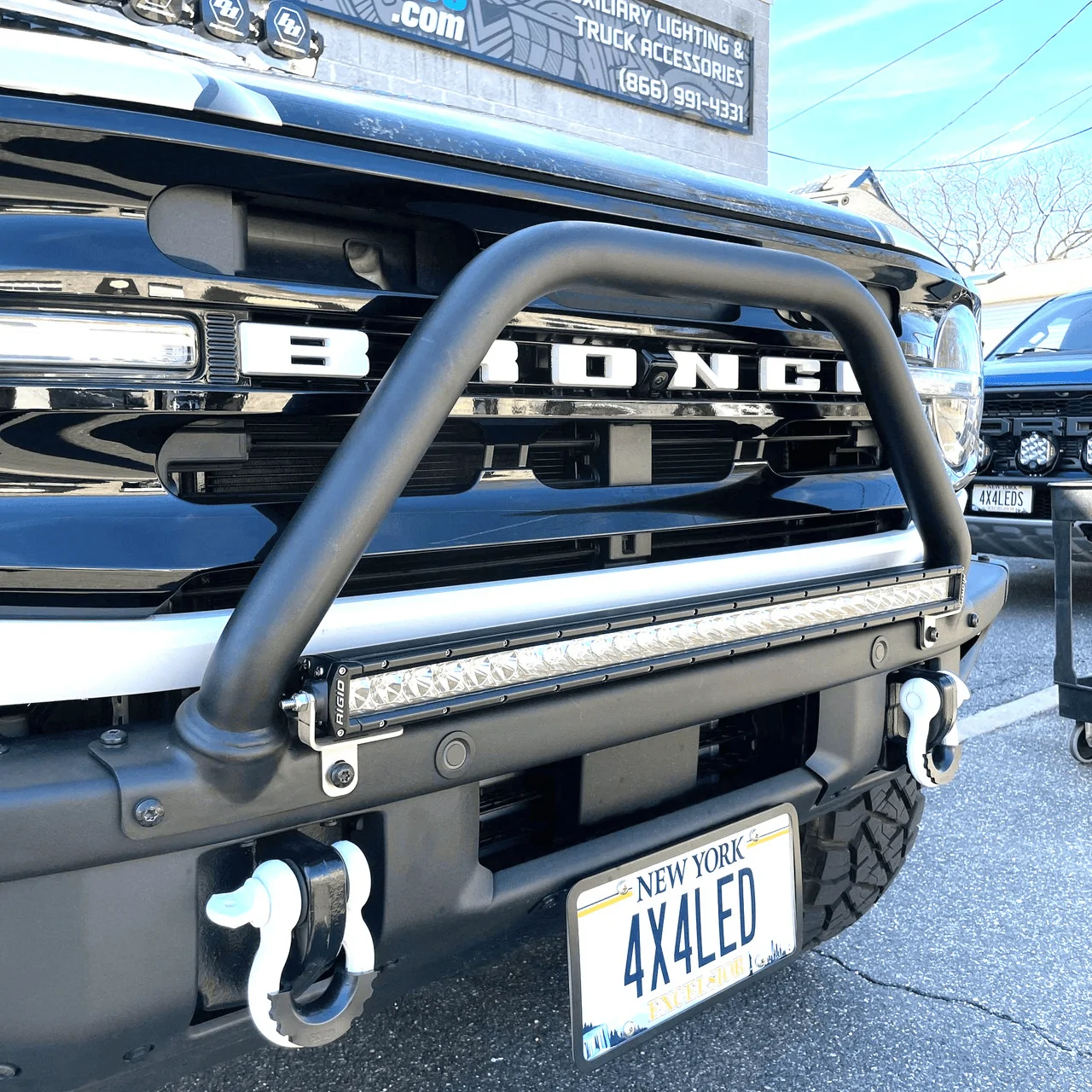

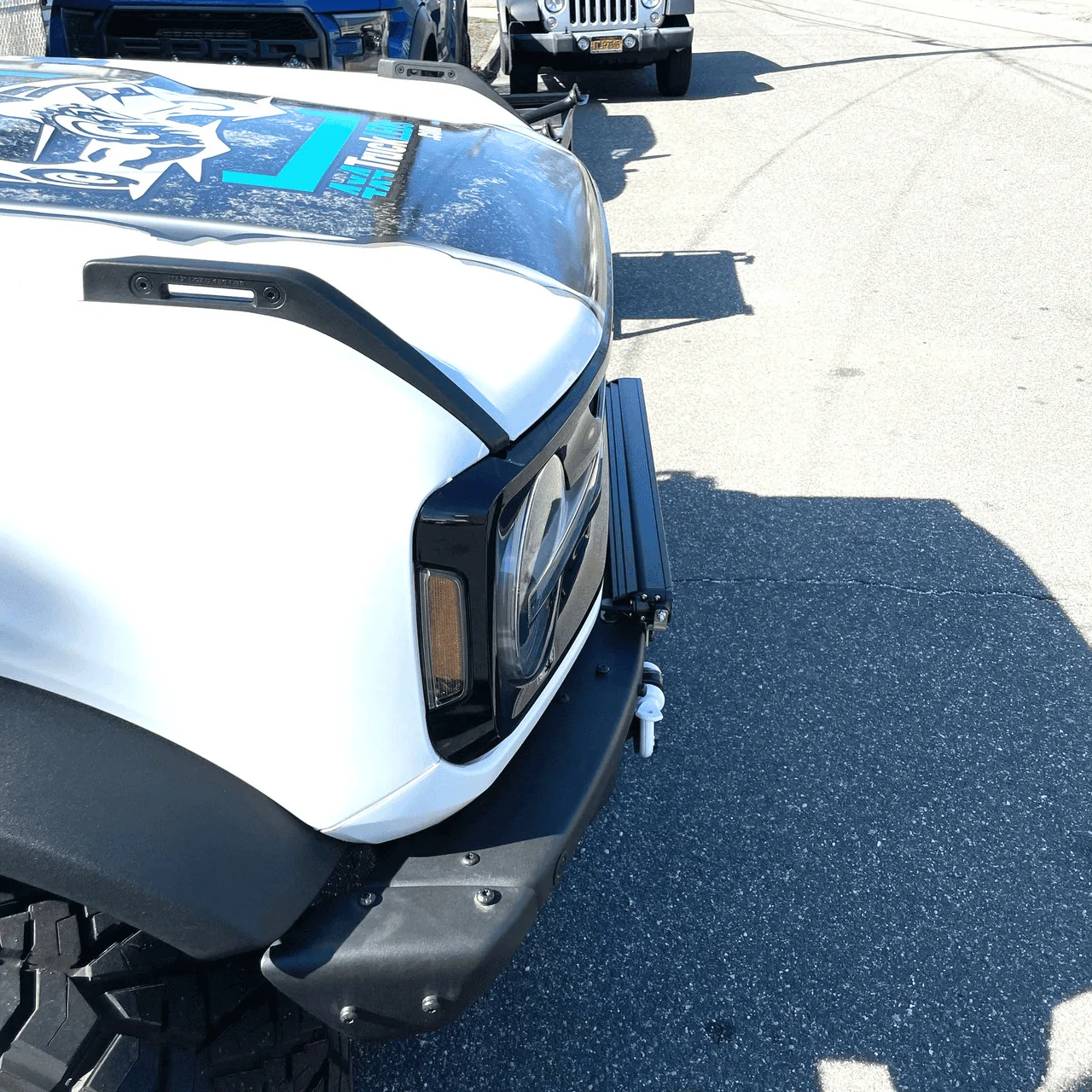

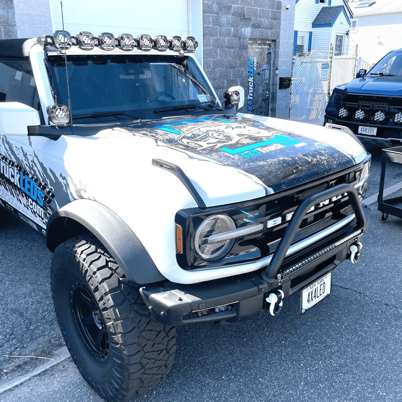

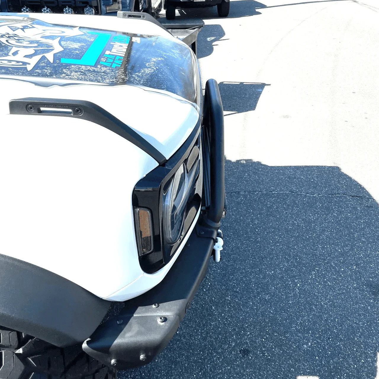

If you have the FACTORY safari bar we have a light bar kit here that works with it: https://www.4x4truckleds.com/30-lig...bronco-modular-bumper-w-kr-off-road-brackets/
If it's aftermarket though our kit may not work since it's designed to work with the fatory safari bar (or no bar at all)
CARdiac
Joel
Jul 30, 2020
159
520
Maryland
Hummer H3 Alpha, MINI Cooper S JCW, TVR 280i
4x4TruckLEDs.com
Squatch Sponsor (Level 3)
Adam
Aug 30, 2021
549
6,142
7,043
Lindenhurst, NY
www.4x4TruckLEDs.com
Is that a 30" light bar? How far does it stick out from the bumper (do you have a side shot)?
Yes 30"
There are some photos on the product page
