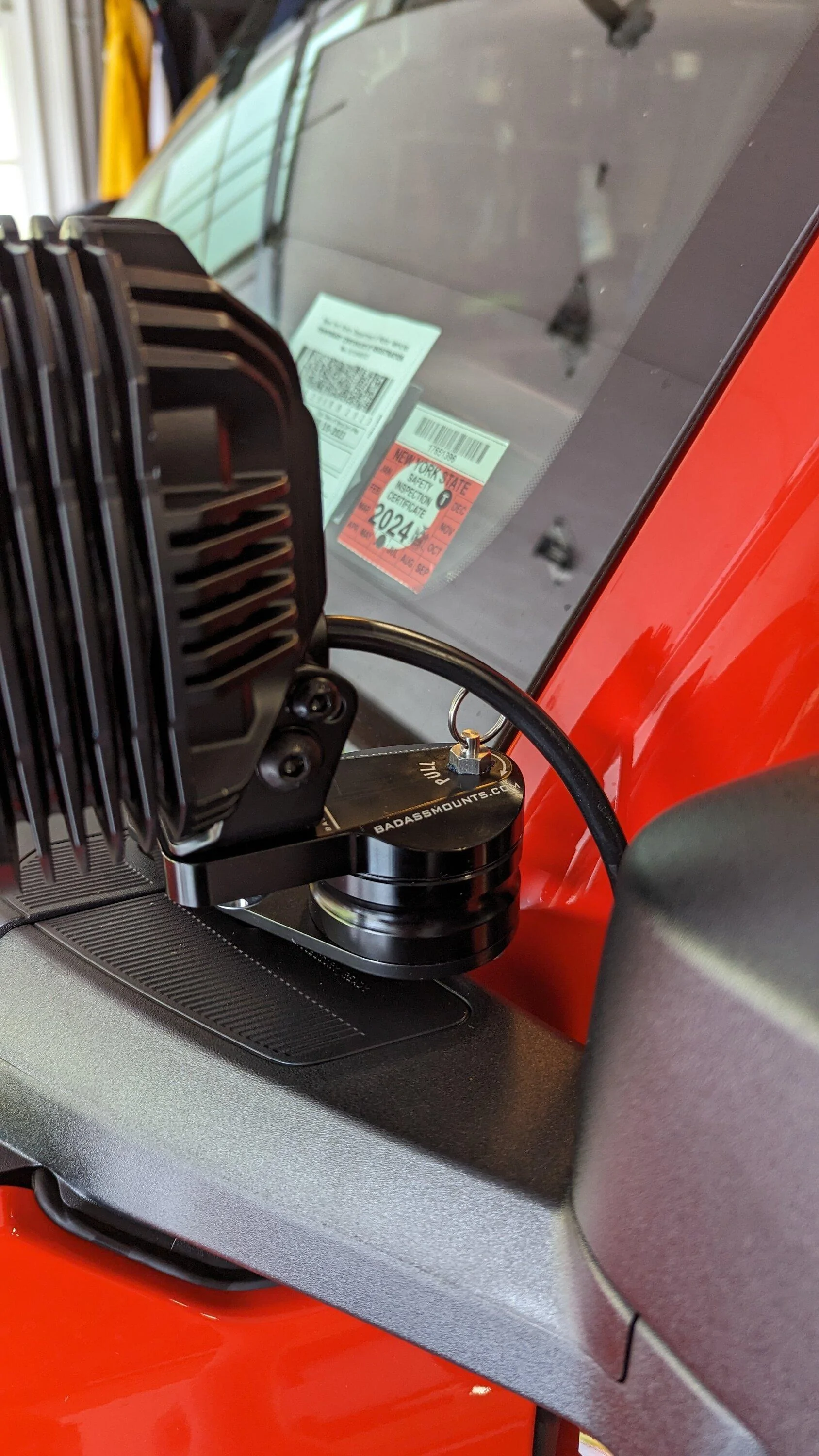

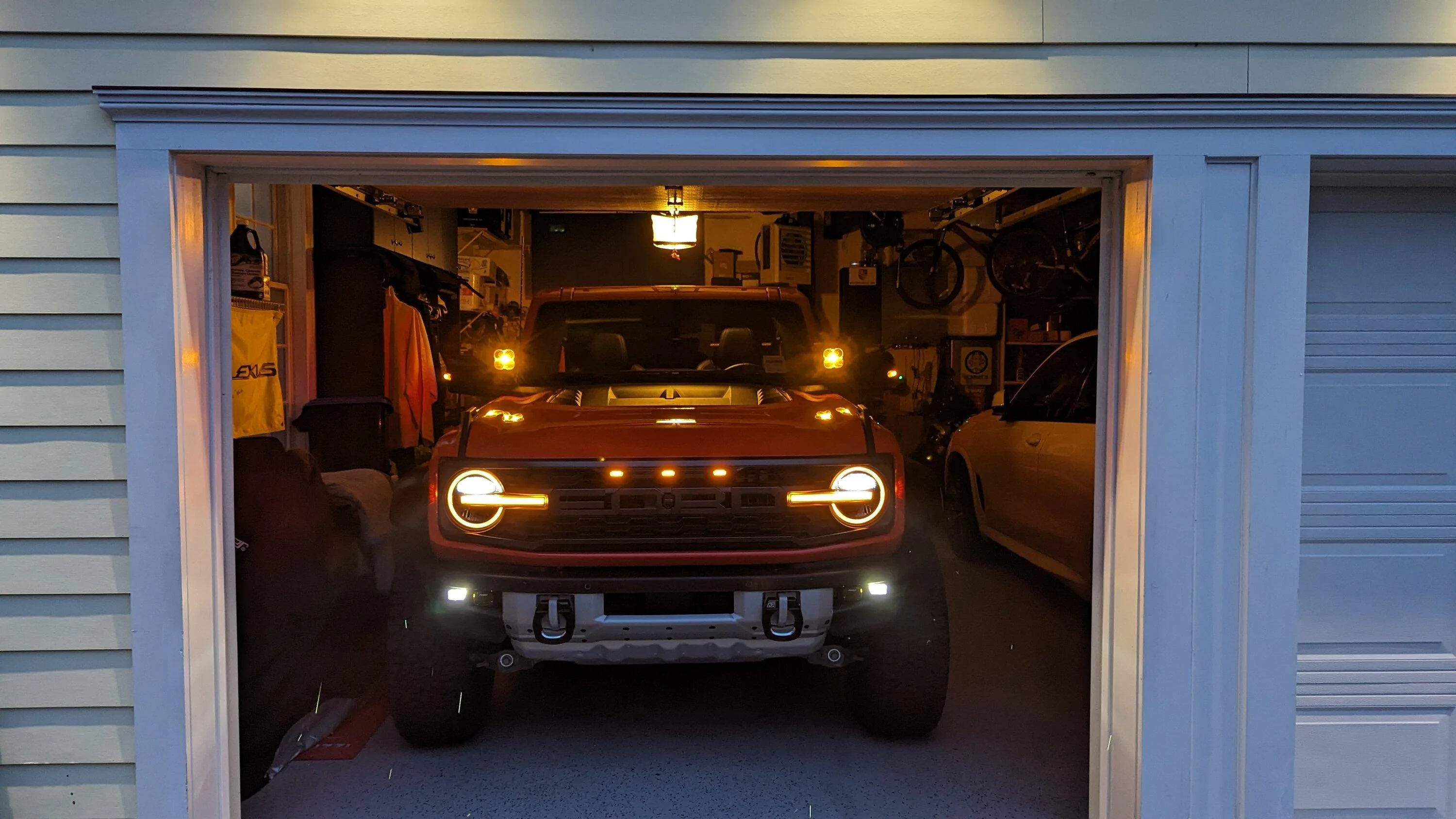

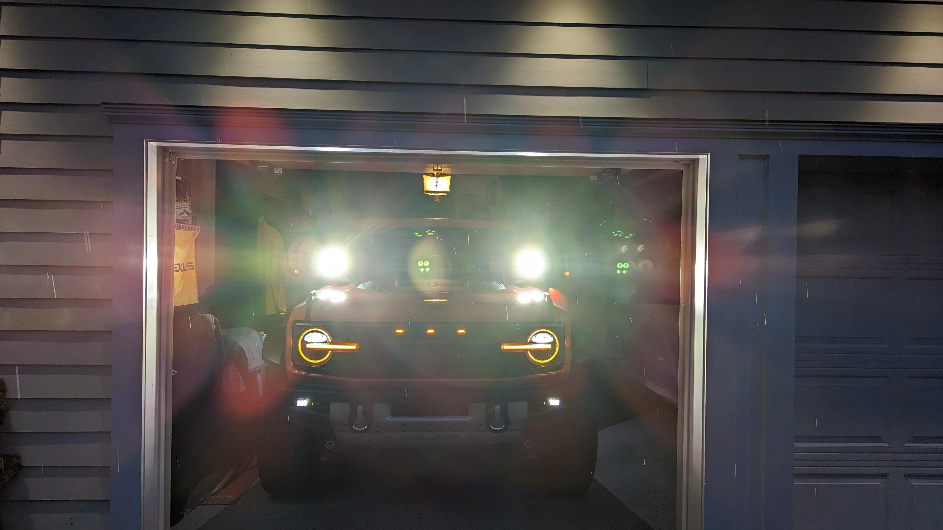

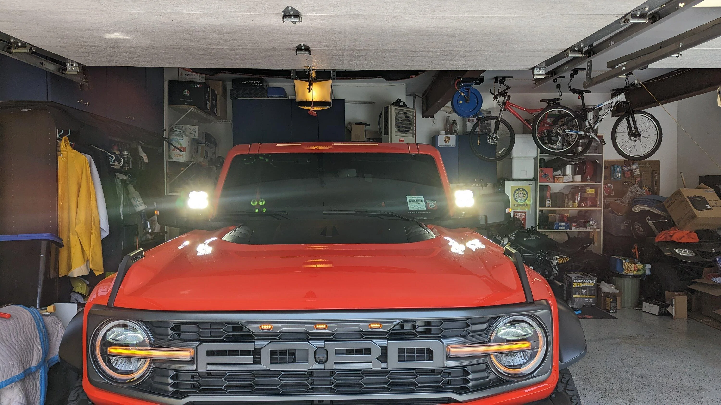

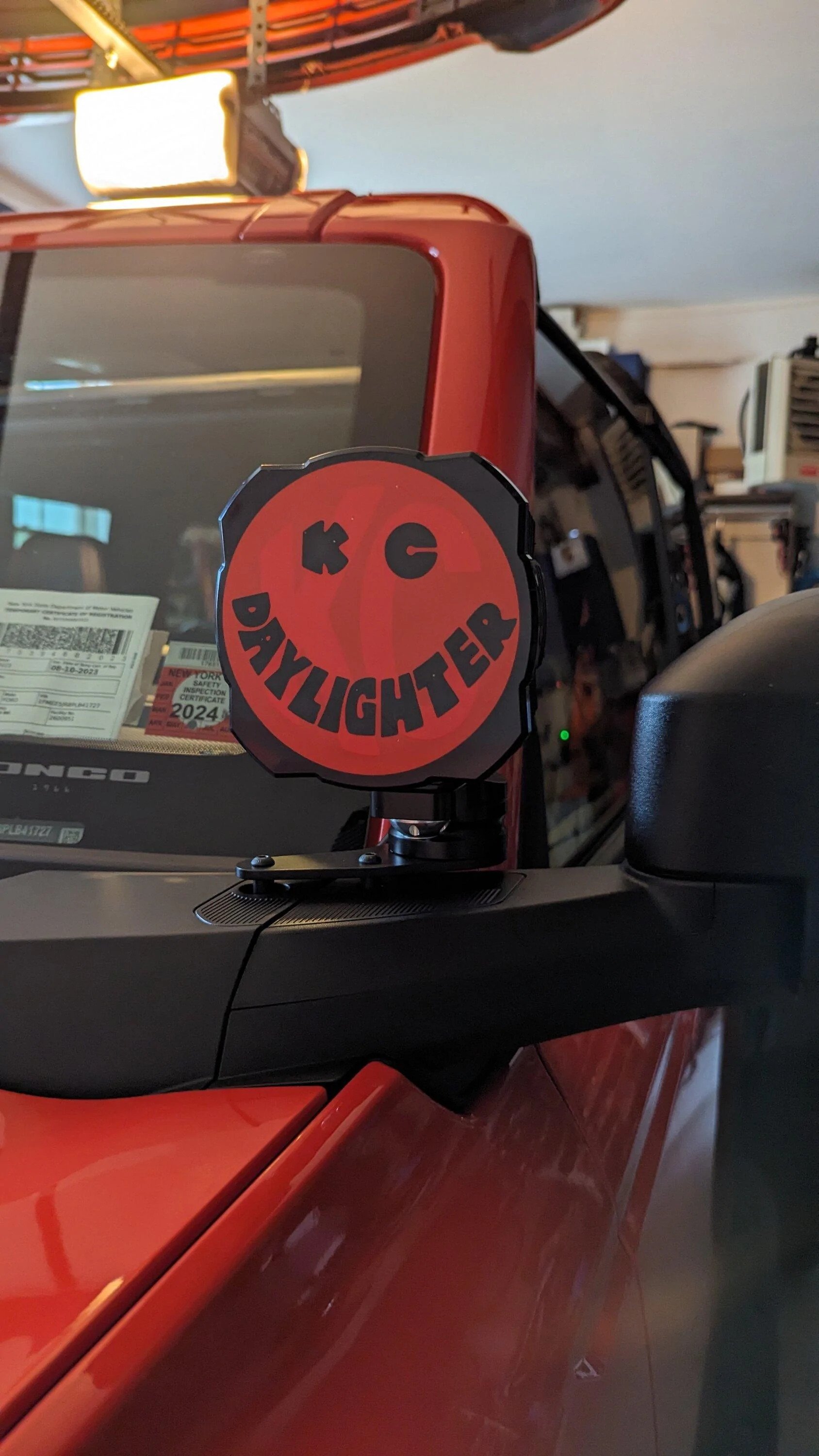

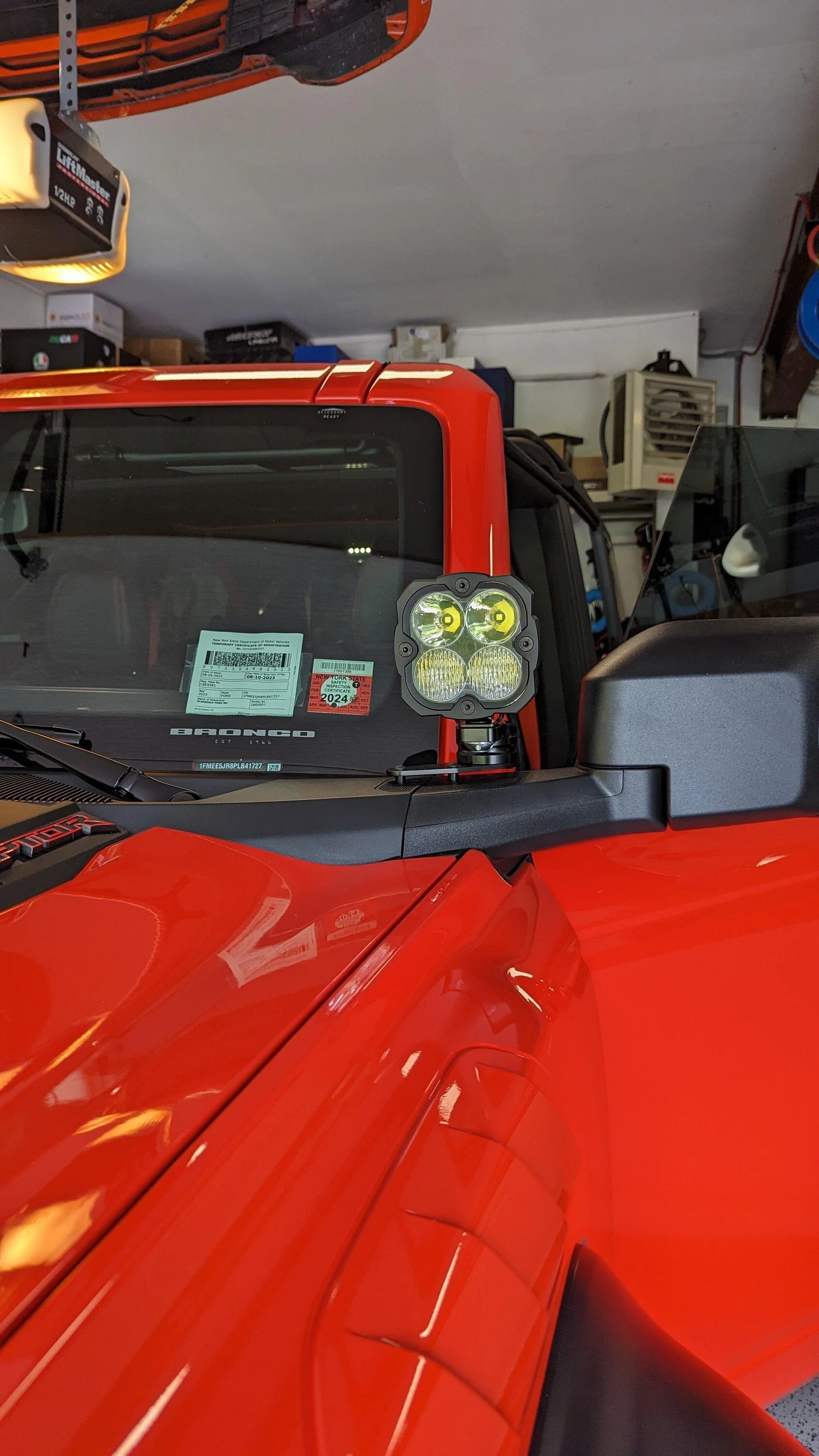

I have OEM Rigid fogs in the bumper (2 sets) One pair I left clear, the other I added a yellow lens. On the a-pillar I mounted a set of KC Hilites Flex Era 4 combo beam lights. The nice thing about them is I also added the clear and amber lens covers so I can adjust as the conditions dictate.
